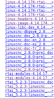

07 Nov 2020 13:22 #188606
Replied by tommylight on topic LinuxCNC 2.8.0 Debian 7 Wheezy RTAI ISO don’t boot
linuxcnc.org/temp/
you need linux headers and linux image and linux modules and linuxcnc.
do not install other stuff from there. Might also need some dependencies.
The following user(s) said Thank You: macsddau@linuxcnc

01 Dec 2020 12:32 #190787
by macsddau@linuxcnc
To much latency, over than 400k Max Jitter.
Replied by macsddau@linuxcnc on topic LinuxCNC 2.8.0 Debian 7 Wheezy RTAI ISO don’t boot
Installed, tested, abandoned and removed.linuxcnc.org/docs/2.8/html/getting-start...#cha:Installing-RTAI
- Posts: 19904
02 Dec 2020 07:07 #190873
That does seem very high.
There is a possibility that it could be an SMI issue.
What is the latency like with the preempt-rt kernel?
Replied by andypugh on topic LinuxCNC 2.8.0 Debian 7 Wheezy RTAI ISO don’t boot
