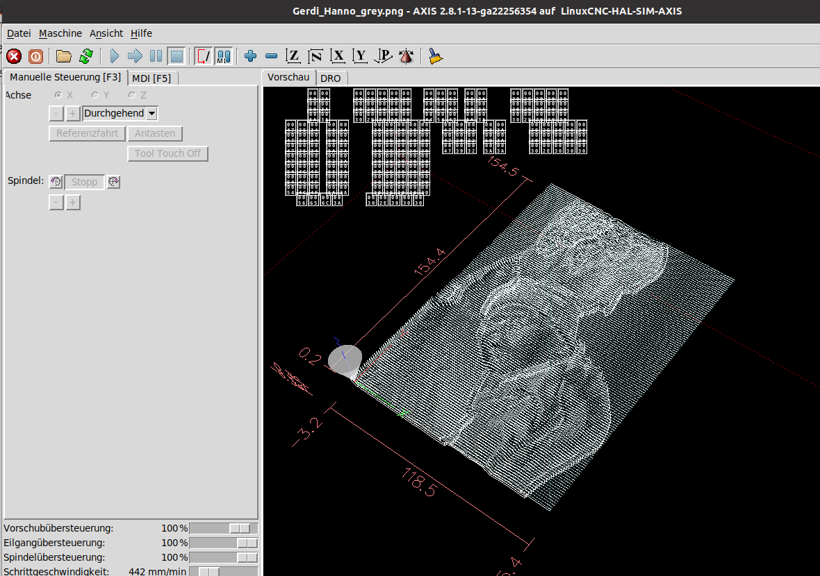

20 Dec 2020 15:39 - 20 Dec 2020 15:55 #192583
by hwe
Replied by hwe on topic Install on Ubuntu 18.04 or 20.04 without realtime, just for sim and VCP dev?
I tested both 2.8 and 2.9 release - both show those symbols.
And I am using X11.
Its a bug ?
And I am using X11.
Its a bug ?
Last edit: 20 Dec 2020 15:55 by hwe.
- Posts: 22030
- Thank you received: 7504
20 Dec 2020 16:36 #192585
Replied by tommylight on topic Install on Ubuntu 18.04 or 20.04 without realtime, just for sim and VCP dev?
Oh cr@p!
That is due to language being different, if i recall correctly.
I was pretty sure it was fixed for German, ...

21 Dec 2020 14:23 #192694
by hwe
Since its a known issue it can be solved
Can you tell by when this will be fixed in the next 2.9 release - I would then like to update the package.
Will it take days, weeks, months ?
I can test it if you want ...

22 Dec 2020 13:44 - 22 Dec 2020 13:53 #192851
by hwe
To avoid those symbols and get the coordinates back, I tried to run linuxcnc with other local language settings, like:
# LC_ALL=C linuxcnc
or
# LC_ALL=en_US.utf8 linuxcnc
But this did not help, the symbols are still displayed.
Is there a workaround to avoid those symbols to be displayed and see the coordinates ?
Apparently the bug is still open:
github.com/LinuxCNC/linuxcnc/issues/659
# LC_ALL=C linuxcnc
or
