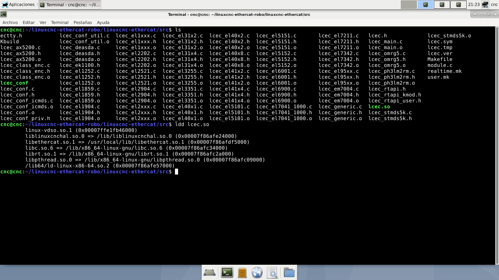

this error "undefined symbol: ecrt_slave_config_sdo" when starting linuxcnc is quite well known, it happens because when compiling linuxcnc-ethercat libethercat.so is not defined in lcec.so, use this commandto see if the way to fix it is linked a, in the old version in the file realtime.mk and in the new version in the user.mk file, do you have igh-ethercat installed in thedirectory?
You can try the file that I attach modified if it works for you,
Attached link of similar problem in case they can help you.
github.com/sittner/linuxcnc-ethercat/issues/61
Greeting
Chimeno
ldd lcec.solibethercat.so.1/ opt / etherlab / libYou can try the file that I attach modified if it works for you,
