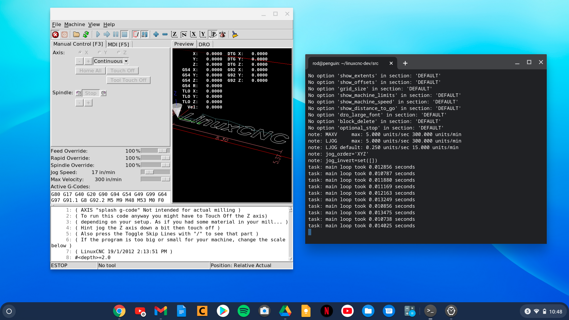

Installing Linuxcnc on Chromebook. was created by rodw
It works!
No excuse not to be on top of Linuxcnc now!
Chromebook allow you to run Debian Buster. You just need to enable the app in settings.
Just follow the normal build process and sort out the dependencies
linuxcnc.org/docs/devel/html/code/building-linuxcnc.html
Here are the packages I installed

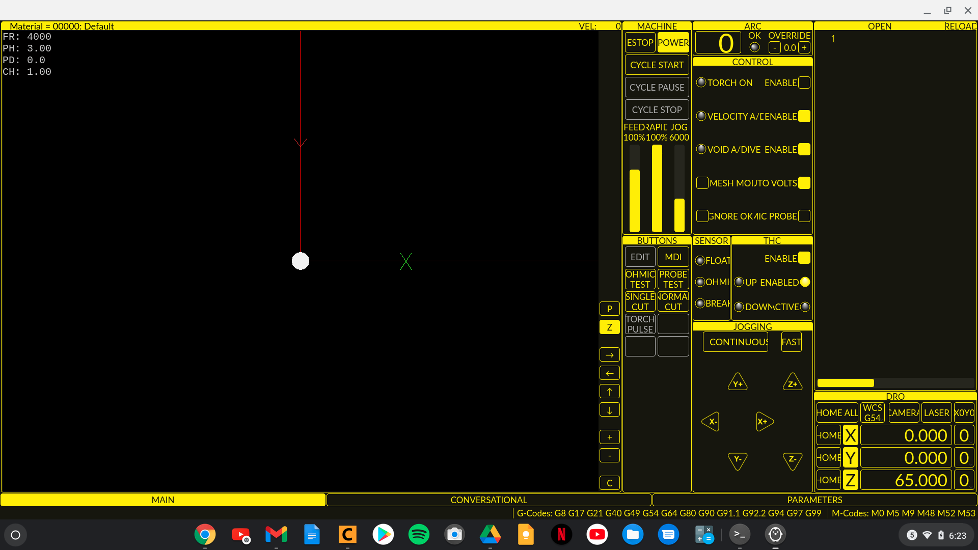

18 Jan 2021 14:18 #195818
Replied by rodw on topic Installing Linuxcnc on Chromebook.
So getting close. Did that and got an error so installed xlib as belowI also installed the designer. It opened but I di not see any Linuxcnc specific widgets which I expected
So now get an error.
I am not sure on the next step.
Run Phill's stickied QT script
pip install xlibSo now get an error.
QTvcp][CRITICAL] Aborted from Error Dialog
Qtvcp encountered an error. The following information may be useful in troubleshooting:
LinuxCNC Version : 2.9.0~pre0
File "/home/rod/linuxcnc-dev/lib/python/qt5_graphics.py", line 670, in initializeGL
self.object = self.makeObject()
File "/home/rod/linuxcnc-dev/lib/python/qt5_graphics.py", line 944, in makeObject
genList = GL.glGenLists(1)
NameError: global name 'GL' is not definedI am not sure on the next step.

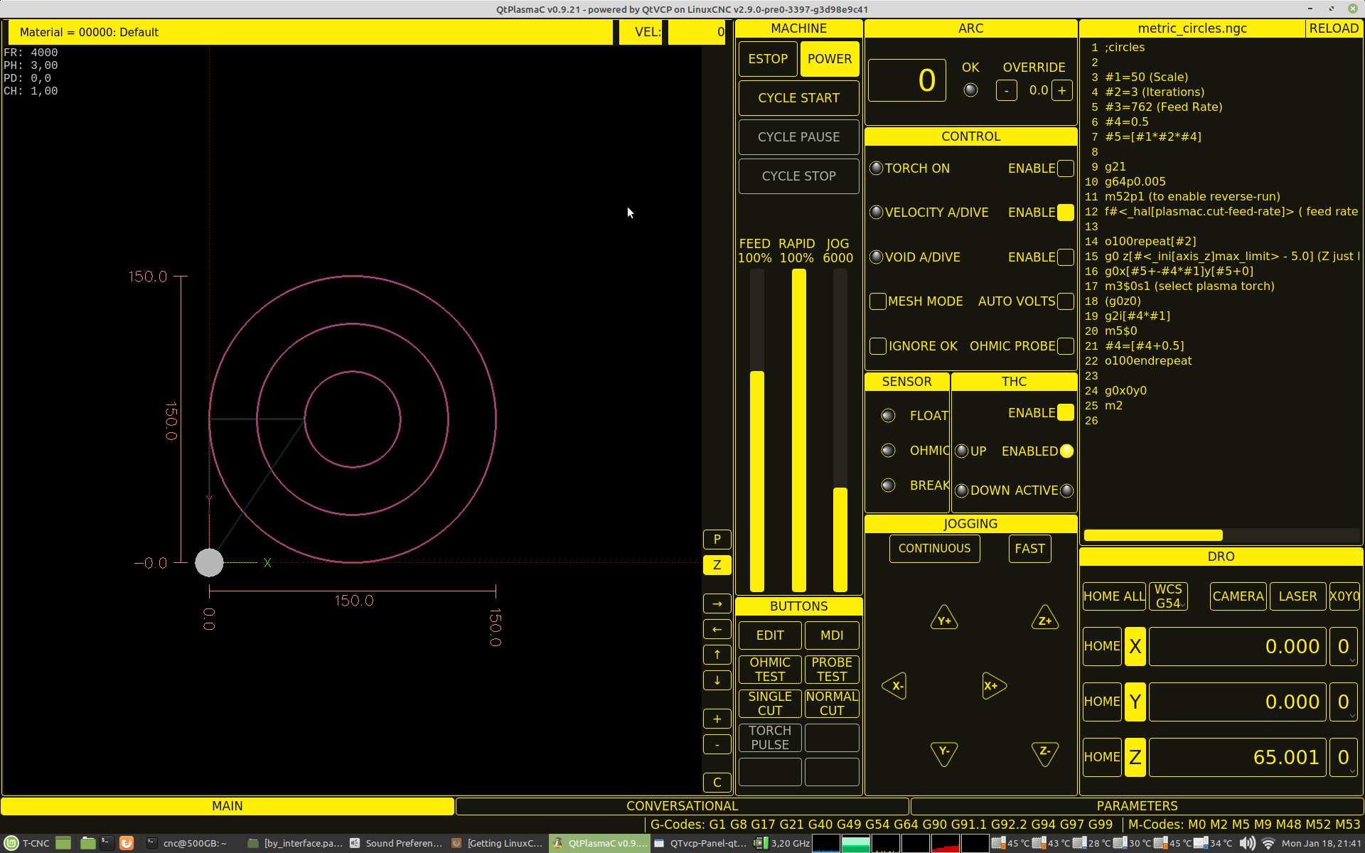

18 Jan 2021 14:26 #195821

- Posts: 12172
- Thank you received: 4154
18 Jan 2021 14:32 #195826
Thanks, Tommy, updated the first post with the added steps for qtvcp

18 Jan 2021 14:51 #195829
Replied by tommylight on topic Installing Linuxcnc on Chromebook.
- Posts: 12172
18 Jan 2021 15:16 #195834
Absolutely awful! Strictly SIMS only! I can't see how you could actually control anything due to lack of outputs anyway.
