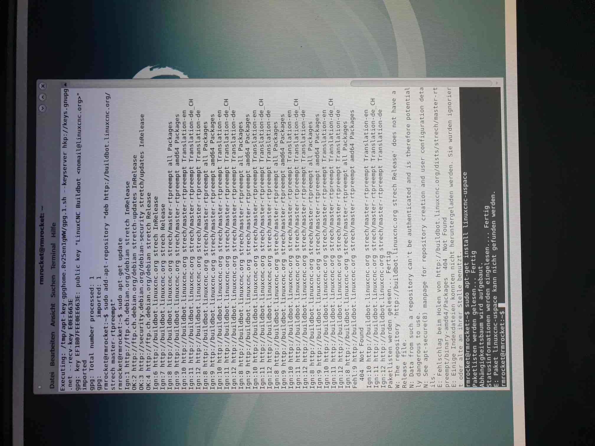

Hello Comunity I have problems installing Linuxcnc 2.7. Apparently not all files can be loaded from the server. I am trying to install linuxcnc for the first time. The operating system is Debian 9. Can someone tell me what I'm doing wrong? best thanks already now for your help

Is there some reason why you wish to install version 2.7 vs the latest 2.8?
Why not grab the complete Linuxcnc install image?
www.linuxcnc.org/iso/linuxcnc-2.8.0-buster.iso
If you wish to install on your own manually using packages you can follow the guide here:
gnipsel.com/linuxcnc/uspace/debian9-emc.html

I installed the current version 2.8 with debian 10 first. I had latency problems max jitter about 800000 ns. I use an asus sabertooth x58 board. for this reason i wanted to try version 2.7.

can you tell me which bios settings i have to make for the x58 board to get rid of the latency problems?
- Posts: 22030
- Thank you received: 7504
13 Feb 2021 05:02 #198667
Replied by tommylight on topic Problem linuxcnc install
Disable everything in BIOS regarding power saving, C states, ports/modem/audio, etc.
