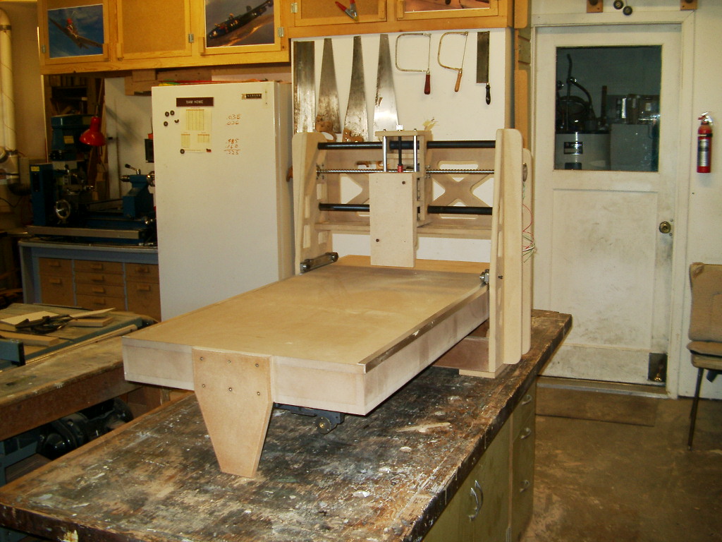

I just got my home made router going. Have Linuxcnc running it. The electronics is an OLD hobbyCNC kit I put together. The router has ball screws on all axis. Travel is x-28", y-18", z-4.38"
I put power to it for the first time today. All axis move correctly in the test this axis portion of the stepconfig? window. However the z axis will not move continuous with the manual command on the axis screen. It jumps a few thousands and quits and I get the following error:
END OF MOVE IN HOME STATE 5.
Another problem is the z axis will not enable homed. I can set the x and y to home, but z will not.
I have the home switch at the top of the travel, and set the travel range both from 0 to -4.38 and then tried from -4.38 to 0
Both of these gives the same error.

- Posts: 19904
18 Mar 2021 19:17 #202785
Replied by andypugh on topic New user, just got the machine going
You have homing configured for Z, but not for X or Y. So X and Y will home where they are, without moving. Z will search for the home switch.
However, the search and latch velocities for Z seem _very_ slow.
Also, the Z axis has almost no range, in the INI posted.
MIN_LIMIT = -0.01
MAX_LIMIT = 0.01
0.02" total travel seems very small.
Also, i think that your home search velocities are wrong for a top-of-travel switch.
And, also, there is a HOME_OFFSET of zero but no HOME_POSITION so the axis will still be on the swtich when homing finishes (this is probably the error that you are seeing)

- desertmoose
- Posts: 4
19 Mar 2021 09:05 #202834
by desertmoose
Replied by desertmoose on topic New user, just got the machine going
I am brand new to Linux and LinuxCnc. I didn't even know the Hal and ini files existed until you guys asked for them. I looked at the files after I posted them and spotted the limit on Z was different from X and Y. I changed Z to -4.38, and 0.01, and the error went away! Having only the homing enabled on Z was while I was troubleshooting Z homing not working. Turns out my soldering skills on the dinky pins in the 8 pin DIN connector provided in the kit leave a lot to be desired. The only axis I successfully hooked up was X. Both Y and Z home and Limit all have opens. Thanks for the link to the homing info. I'll be checking it out after I get the wiring redone. Also, I noticed that the homing speed was REAL slow. I just used the wizard to set it up, and that's what it gave me. Any recommendations for a better setting on this? Thanks again for the help.
