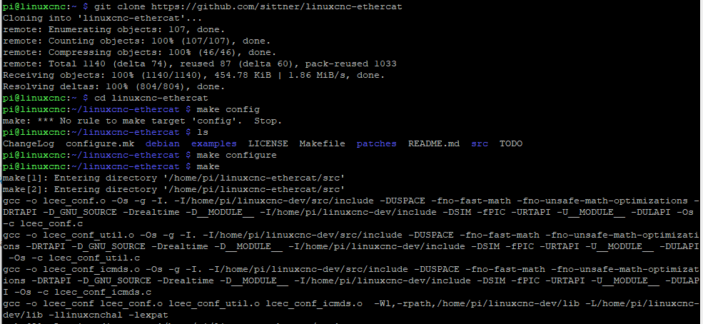

5. Download linuxcnc-ethercat and make but i get error:
lcec_conf.h:22:10: fatal error: ecrt.h: No such file or directory
What did i miss?
The error above seem relate to etherlabmaster-dev, also the add-task-pll-functions-2.8.patch seem already be in linuxcnc 2.8
1. Install linuxcnc official iso image for rpi4: www.linuxcnc.org/iso/linuxcnc-2.8.1-pi4.zip
2. Install linux-header correspond realtime kernel
3. following ur link, i success install etherlabmaster
4. Installing linuxcnc-dev 2.8
What did i miss?

I just redid the compile of linuxcnc-ethercat. Here is what I did - after ". ~/linuxcnc-dev/scripts/rip-environment"
Check the include-directories "-I." etc, you may need to add them to config.mk and realtime.mk , I don't remember the details but there were some mod needed there.
Edit: Also needed to add -L/opt/etherlab/lib to the LDFLAGS line of realtime.mk for it to find libethercat.so

@thang did you get it to work? I checked a bit more and the problem arises because etherlab is installed all under /opt/etherlab. Include files and libraries are not found in the usual places, thus one need to add paths to include files and libraries during build. Unfortunately.
After etherlab is built, an ugly fix is to create links from the common places to /opt/etherlab.
After this, linuxcnc-ethercat build cleanly without modification. Linux with ethercat starts up without further mod as well. It is enough to use linuxcnc-uspace-dev package, it is not necessary to build linuxcnc from source.
Code:
sudo ln -s /opt/etherlab/include/*.h /usr/include/linuxcnc/
sudo ln -s /opt/etherlab/lib/lib* /usr/lib/
Last edit: 5 years 7 months ago by Hakan.
