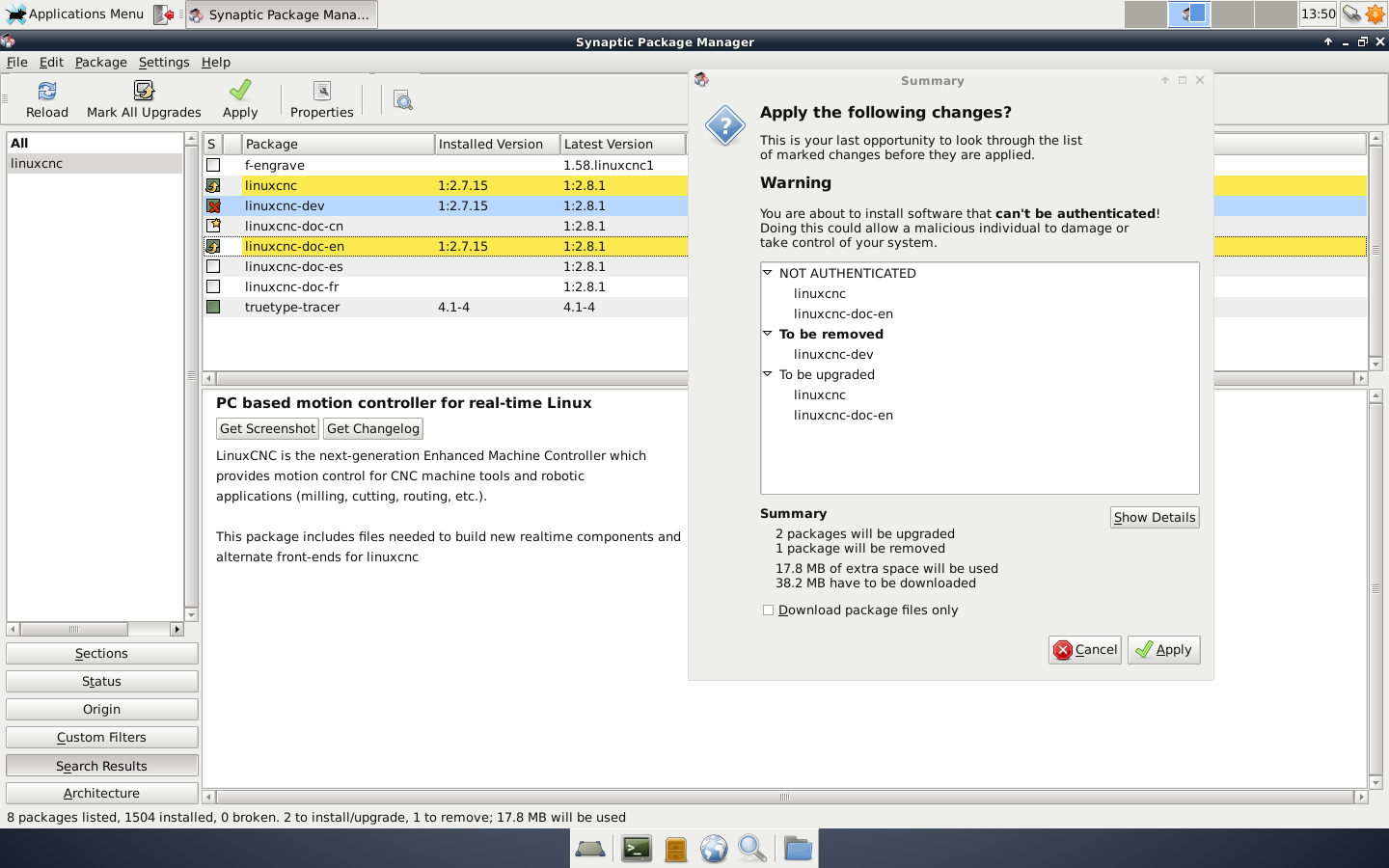

1) Figured that would be the answer. Didn't know if there was a commonly known precedence already noted between Buster RTAI or Wheezy RTAI for latency. If there are no other software advantages ill probably just stick with Wheezy since apparently its error free and i dont have to do another OS install. Can you swap back an forth between Buster RTAI and PREEMPT-RT without issue? I see there is a way to go one way
This was my Buster PREEMPT-RT latency data :
rtpreempt.lat: 7201 secs base min: -27.800 uS max: 31.600 uS sdev: 1.600 uS
rtpreempt.lat: 7201 secs servo min: -39.400 uS max: 38.400 uS sdev: 1.800 uS
What kind of numbers am i shooting for? under 50 or under 25?
2)indeed. I'll have to run through it again but iirc in step 1.2.1
"Click the check box to mark the new linuxcnc and linuxcnc-doc-* packages for upgrade. The package manager may select a number of additional packages to be installed, to satisfy dependencies that the new linuxcnc package has. "
one of the additional packages is the 'linuxcnc-dev' one. Thats the one that is giving the error message that its not present or too old. I'll get the exact language later. seems like something is up with the package in the repository...
Edit: screenshots added

You only need dev if your going to build components IIRC. Usually it's a network issue when I get an error like that and I just try again later.
The base thread is the one used for software step generation and your's look good. Some combinations of motherboard and OS can get down to the teens...

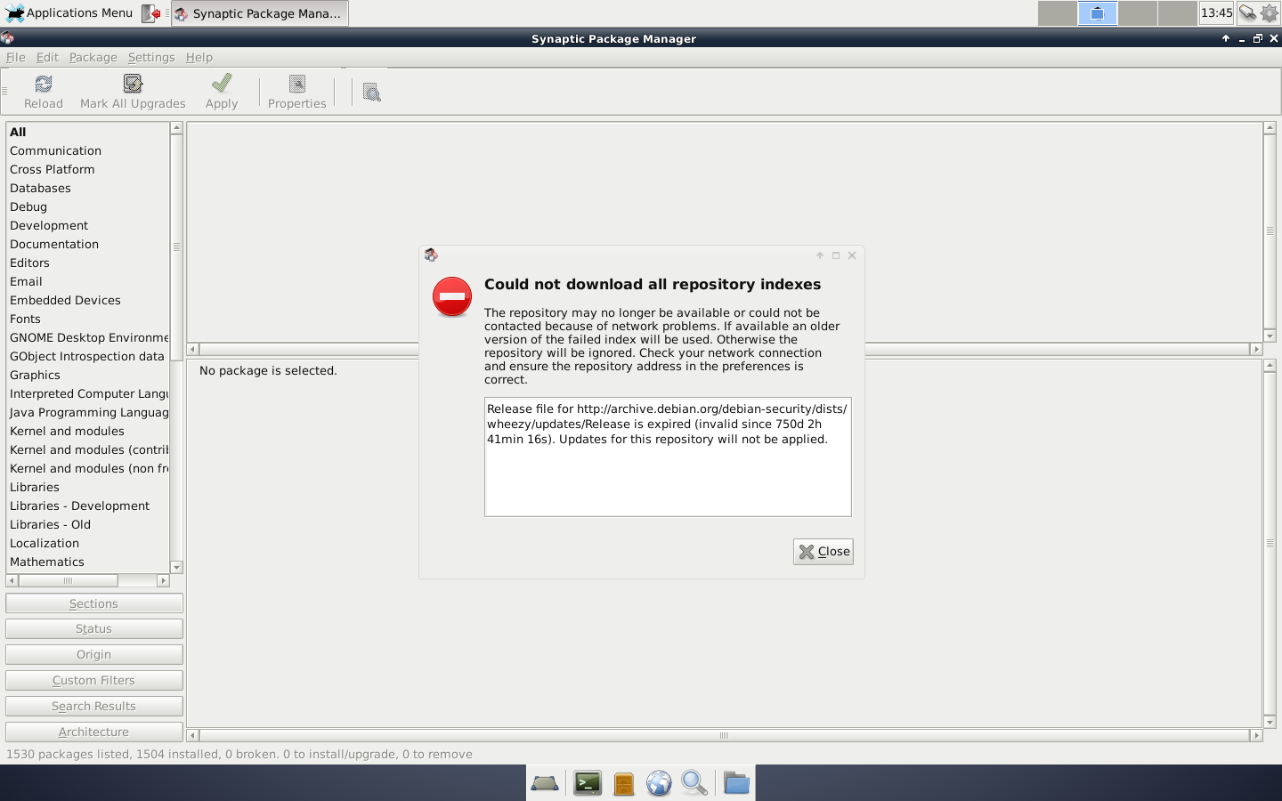

I only included the dev because when you include the base one it automatically adds it. For that reason i figured it needed it. What do you mean by 'build components"?
Anyways i let it remove that and only install linuxcnc and linuxcnc-doc-en and it went through. Oddly despite being on the 2.8 repositories it started on 1.2.7.15 and said it was going to upgrade to 1.2.8.1. When it was completed it listed 1.2.9.0 as being installed. I'm not certain what happened. Is 1.2.9.0 stable?
EDIT: I found out how to force 1.2.8.1 and successfully did that. The 1.2.8.1 linuxcnc-dev is still broken though and cannot be installed. Is that something that needs to be fixed on the other end or is there another place i can download and manually install it?

What you got will do just fine, Wheezy has no more updates, but for running a machine there is no need for it.
Dev is required ONLY if writing and compiling components for LinuxCNC, otherwise no need for it, ever.
