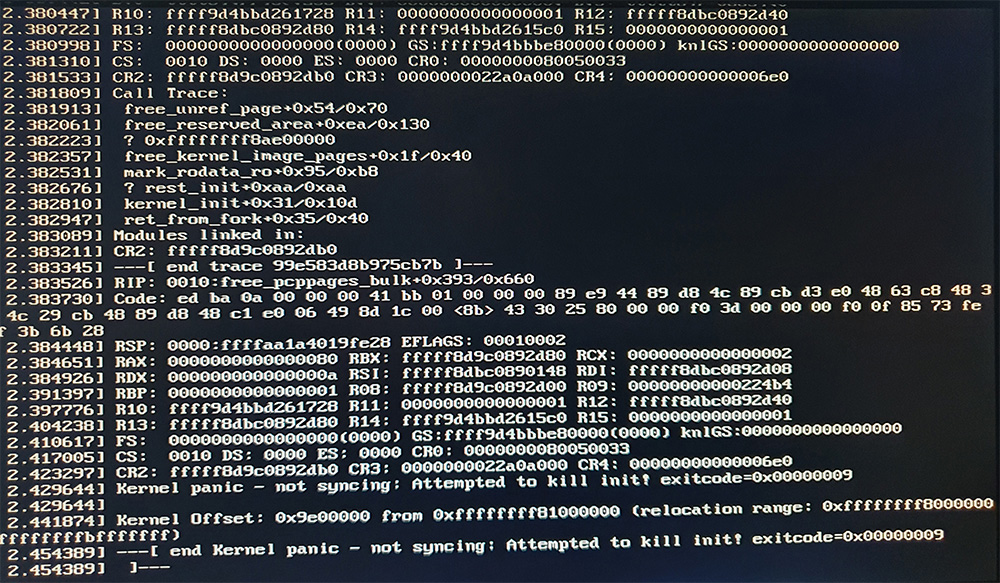

Hi!
I am struggling to install the newest LinuxCNC Release 2.8 (Debian Buster Image).
On my old PC which I plan to use for my future CNC build I am only able to boot the Live (failsafe) version.
When I am trying to install or boot the normal live mode, I get a Kernel Panic after 1 minute or so.
The ISO seems to be OK. I can boot the Life mode on my Laptop.
For now I installed the official Wheezy Image and it is working well. But since I don't really want to run an end of life version I am hoping that someone can give me some tips to get Buster running (installing).
Some infos of my machine:
Pentium D (15/4/7) 3.00 Ghz
2x 1Gb DDR2
1,5TB
I used the official released Buster ISO burned on an USB device with rufus.

First check the md5sum of the downloaded ISO file.
That type of kernel panic is usually due to failing memory modules, so open the case, see if there is more than 1 DIMM then yank all but 1 out, boot the PC from USB and if it boots shut it down, add another DIMM, boot again, rinse and repeat.
Checksum was ok. I also burnd the Image on different usb devices with different tools and slightly different settings.
I also tried a Deb10 Dvd (not linuxcnc) burned by a friend of mine wich lead to the same result.
That type of kernel panic is usually due to failing memory modules, ...
That was also the first thing I read in an other forum. So i tried it with all types of variations with 1gb and 512mb I had laying around, by switching them around on the 4 slots. I also run a memtest for more then 2 hrs without any errors. I stayed with thw 2x 1gb configuration.

28 Jun 2021 09:34 #213143 by andypugh
Replied by andypugh on topic kernel panic on Buster instaltion
There is the option of trying the RTAI kernel (and the matching LinuxCNC). That might be more (or less) stable.
linuxcnc.org/docs/2.8/html/getting-start...#cha:Installing-RTAI
But note that, as of last night, there is a 4.19.195 kernel and RTAI, so use that where it says 4.14.174
