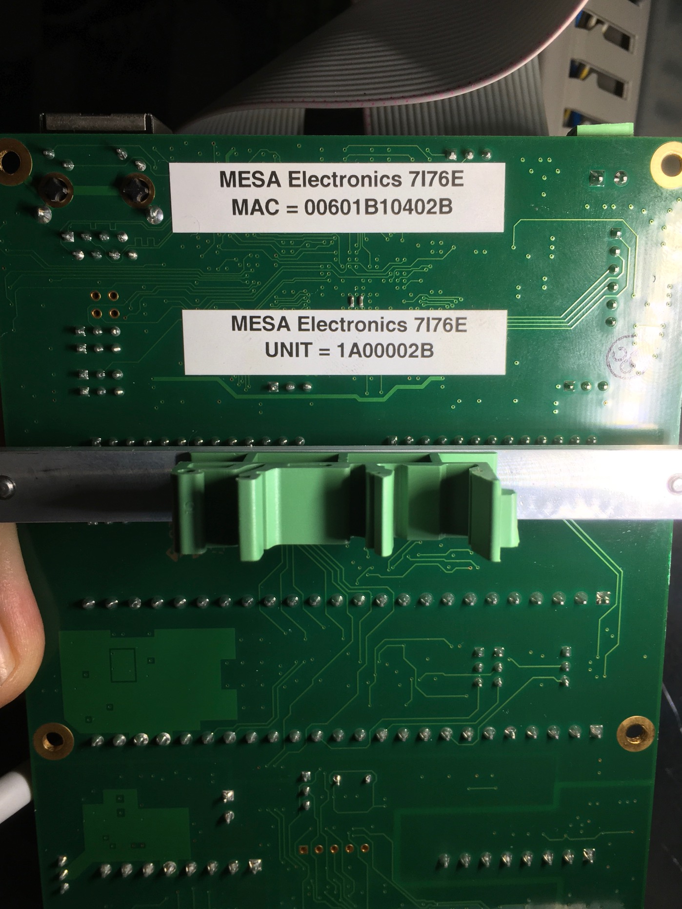

Yes, that firmware is ancient:UNIT = 1A000005 means its the 5th
7I76E ever made and probably has never had its firmware updated,
the "hm2/hm2_7i76e.0: Smart Serial Firmware Version 42" does date from 2014 or so.

27 Jun 2021 14:52 #213045
by chris@cnc
Who has number 1?
Replied by chris@cnc on topic New User problems...Linuxcnc terminated with an error
For a long time I thought about what these numbers mean. Now i know I have number 2.Yes, that firmware is ancient:UNIT = 1A000005 means its the 5th
Who has number 1?

Replied by Simon on topic New User problems...Linuxcnc terminated with an error
Thanks again for your help everyone.
I suspected the 1A000005 might have been important...
How do I find and install the new firmware?
I assume there is a mesaflash function that writes it to the card?

27 Jun 2021 20:54 #213071
Replied by PCW on topic New User problems...Linuxcnc terminated with an error
Actually you have # 43 (0x2b hex)
2B | /2B?
2B | /2B?

27 Jun 2021 20:57 #213073
Yes, you fetch 7i67e.zip from Mesa and extract 7i76e_7i76x1D.bit
from the configs/hostmot2 directory. Then from the local directory containing
7i76e_7i76x1D.bit, you run:
mesaflash --device 7i76e --addr 10.10.10.10 --write 7i76e_7i76x1D.bit
and then either power cycle the card or run:
mesaflash --device 7i76e --addr 10.10.10.10 --reload

28 Jun 2021 02:50 #213100
by Simon
Bingo! That went like clockwork.
Now all there is to do is everything...
Thanks so much for your time everyone : )

29 Jun 2021 16:42 #213276
Yes, very possibly. I suggest expunging it and installing "nm-tray" which will bring in network-manager to replace it. As soon as I did that on my test PC it started working with 7i80 and Widi siultaneously, which had previously been impossible.
POSIX realtime is good, that means that you are running the preempt-rt kernel.
Other options are POSIX non-realtime (standard kernel) and LXRT realtime (user-space realtime with an RTAI or Xenomai kernel. If you are running RTAI in kernel mode then there is no message at all.
Replied by andypugh on topic New User problems...Linuxcnc terminated with an error
I can now connect with mesaflash using 10.10.10.10. I wonder if my problems might be coming from Wicd network
But, linuxcnc is still not loading...I did just notice the line: "Note: Using POSIX realtime"
is this my problem? Does it need to be preemp rt kernel for the 7i76e?
