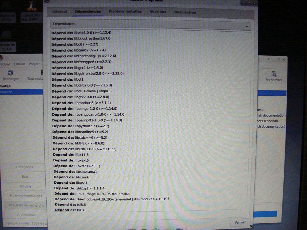

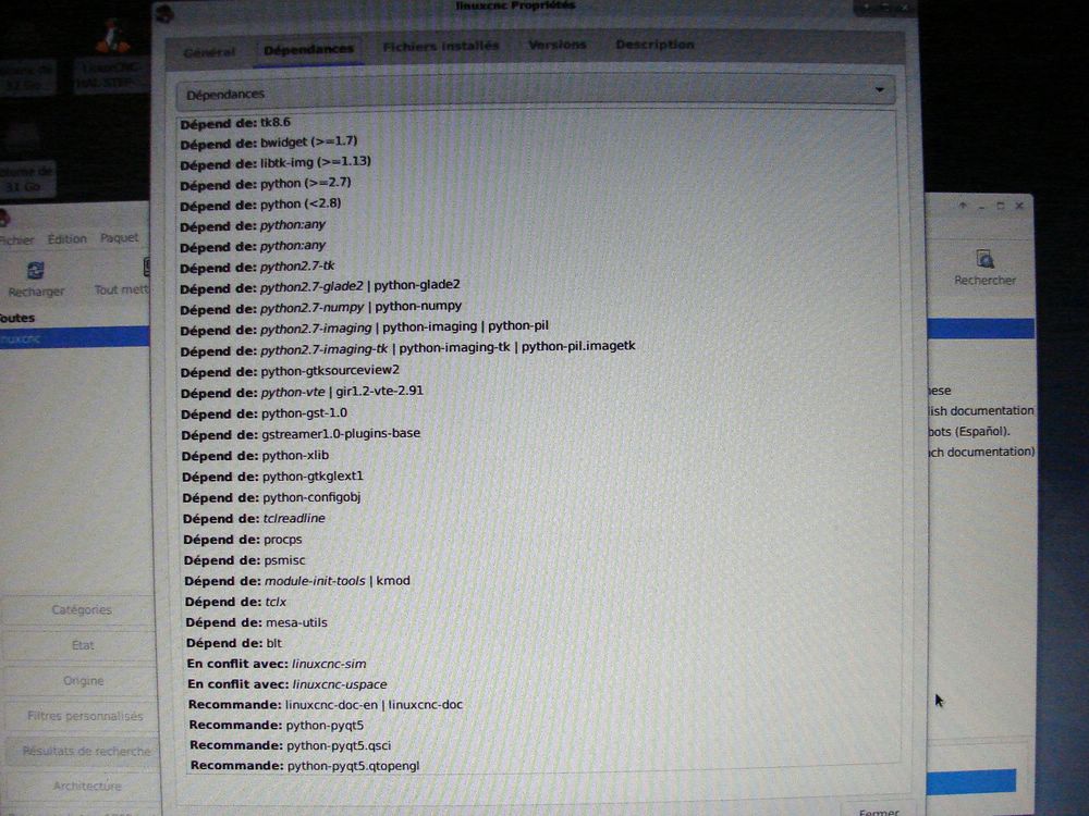

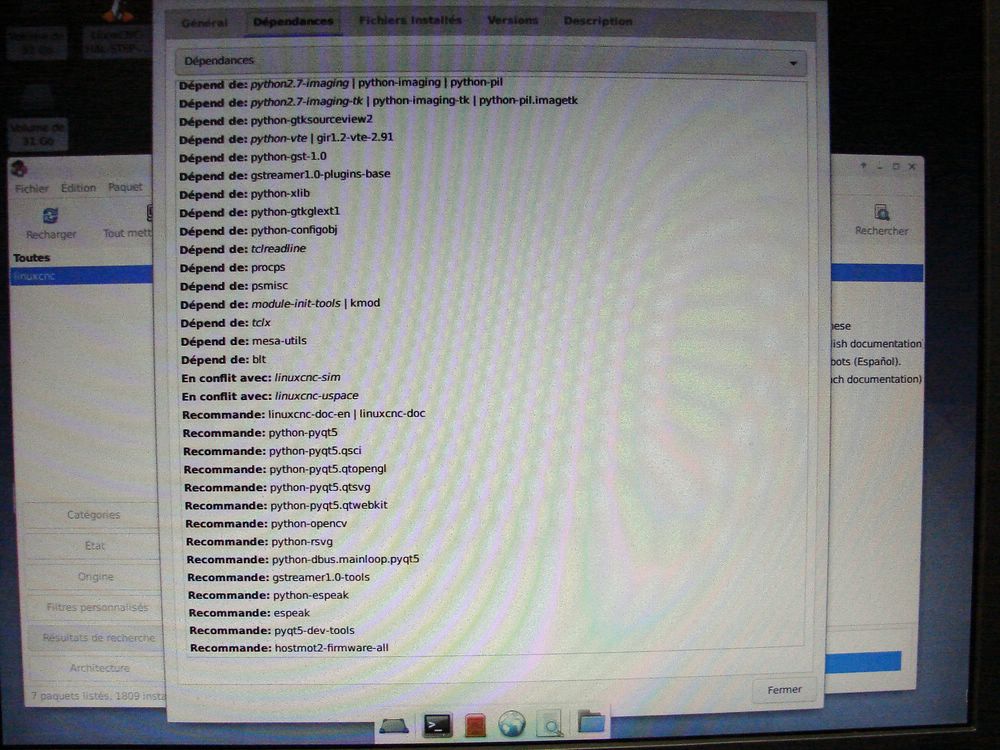

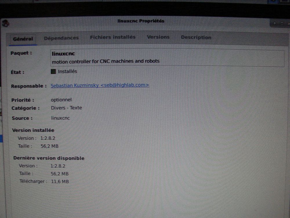

I installed linuxcnc with synaptic
he refuses the installation of linux-dev
the latency test does not start
as well as a small sherline config?
Synaptic indicates that there are conflicts with uspace dependencies
mikron@pcmikron:~$ uname -a
Linux pcmikron 4.19.195-rtai-amd64 #5 SMP PREEMPT Sun Jul 11 19:13:27 BST 2021 x86_64 GNU/Linux
mikron@pcmikron:~$
linuxcnc-dev:
Dépend: linux-headers-4.19.195-rtai-amd64 but it is not installable
Dépend : python-serial mais ne doit pas être installé
Dépend : python-yapps mais ne doit pas être installé
Replied by gaston48 on topic Can not install LINUX CNC
I think RTAI is well installed thanks Andy ...

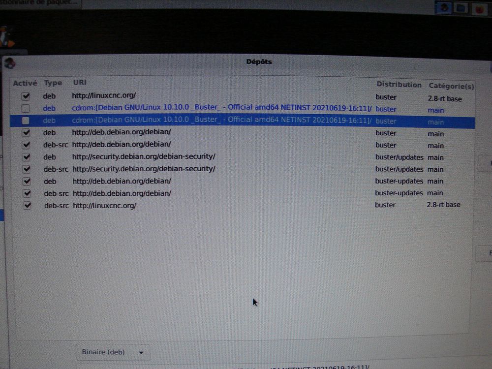

- Posts: 19904
04 Aug 2021 05:16 #216897
Replied by andypugh on topic Can not install LINUX CNC
The linux-headers package is available in the repository that you got RTAI from.
I very much suspect that there is still a problem with your apt repository settings.
If you open Synaptic and look through the menus for the repository settings, what does it have?
- gaston48
- Posts: 112
- Thank you received: 5
04 Aug 2021 12:55 #216926
by gaston48
- Posts: 19904
10 Aug 2021 18:45 #217434
I think that you need a deb-src entry for www.linuxcnc.org (follow the same pattern as the others)
