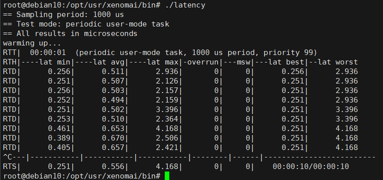

I tried to compile linuxcnc in the above environment, and successfully compiled all programs.
But when I run latency-test, it prompts "Note: Using POSIX non-realtime"
The following are my configuration steps:
During make, the posix/pthread.h header file in the uspace_xenomai.cc file cannot be found.
I modified it to cobalt/pthread.h corresponding to xenomai3. Then compile successfully!
But as I said at the beginning, the compiled program runs in a non-real-time environment.
It is not like some people will prompt to use Xenomai POSIX **** at runtime.Of course, the results of latency-test are very bad.
By the way, I used the latency compiled by xenomai to test and achieved very good results, so my xenomai real-time kernel and environment are working.
So, did I do something wrong or should I use a special Linuxcnc branch?

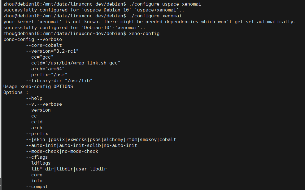

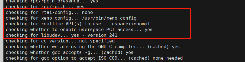

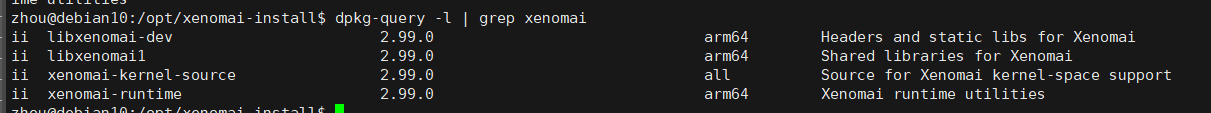

25 Oct 2021 01:35 - 25 Oct 2021 01:37 #224165
by SummerLotus
Replied by SummerLotus on topic How build Linuxcnc with xenomai3?
I think there is no problem with my xenomai installation~I compiled and installed the following packages in my system~
libxenomai-dev_2.99.0_arm64.deb
xenomai-kernel-source_2.99.0_all.deb
xenomai-runtime_2.99.0_arm64.deb
libxenomai1_2.99.0_arm64.deb
When I use ./configure uspace xenomai or ./configure xenomai, the prompt that appears corresponds to the following.
When I use ./configure --with-realtime=uspace under src, it can be seen that xeno-config was found in the output information, but I am not sure whether it is configured correctly.
When I execute make, it prompts that there is a problem with posix/pthread.h in usapce_xenomai.cc,
so I changed it to cobalt/pthread.h
so that it can be compiled and passed. Then as I said, it is non-real-time.
Last edit: 25 Oct 2021 01:37 by SummerLotus.
