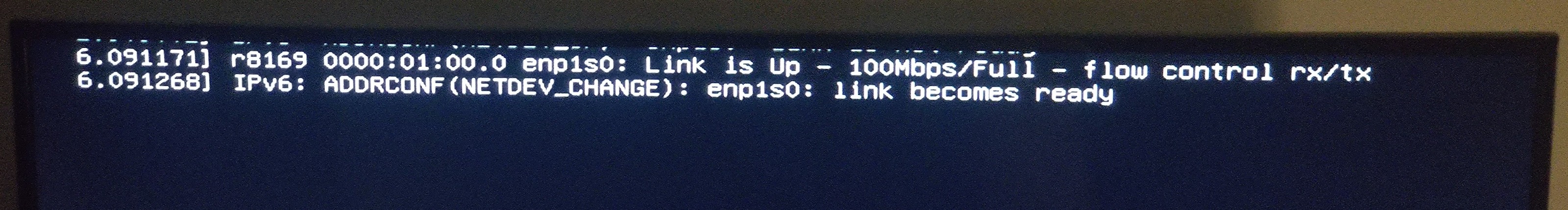

I have a new hardware with Intel i3-10100 CPU. Integrated graphics card.
I'm installing "linuxcnc-2.8.2-buster" from USB drive and all OK. But after restart i see some console lines and then screen is going black and that's all. Trying to restart - the same results. CTRL+ALT+DEL is restart system and before restart i see some console lines with system shutdown messages.
I installed the same ISO to my old PC with I5 gen5 and all was OK. But that PC have a normal GPU but not a integrated
Anyone know what's going on?

That's not help. Now i see two console lines and system still not started.
I'm add a "nomodeset" and remove "quiet" to see full loading log. Lot of lines scrolling in 2 seconds then screen is cleaning and printed 2 new lines at top. And that's all. No login screen or something else. Just 2 lines of text about network

I don't find solution.
I'm just add simple GPU (nVidia GT730) to PC and disable integrated gpu. Now everything is working fine
