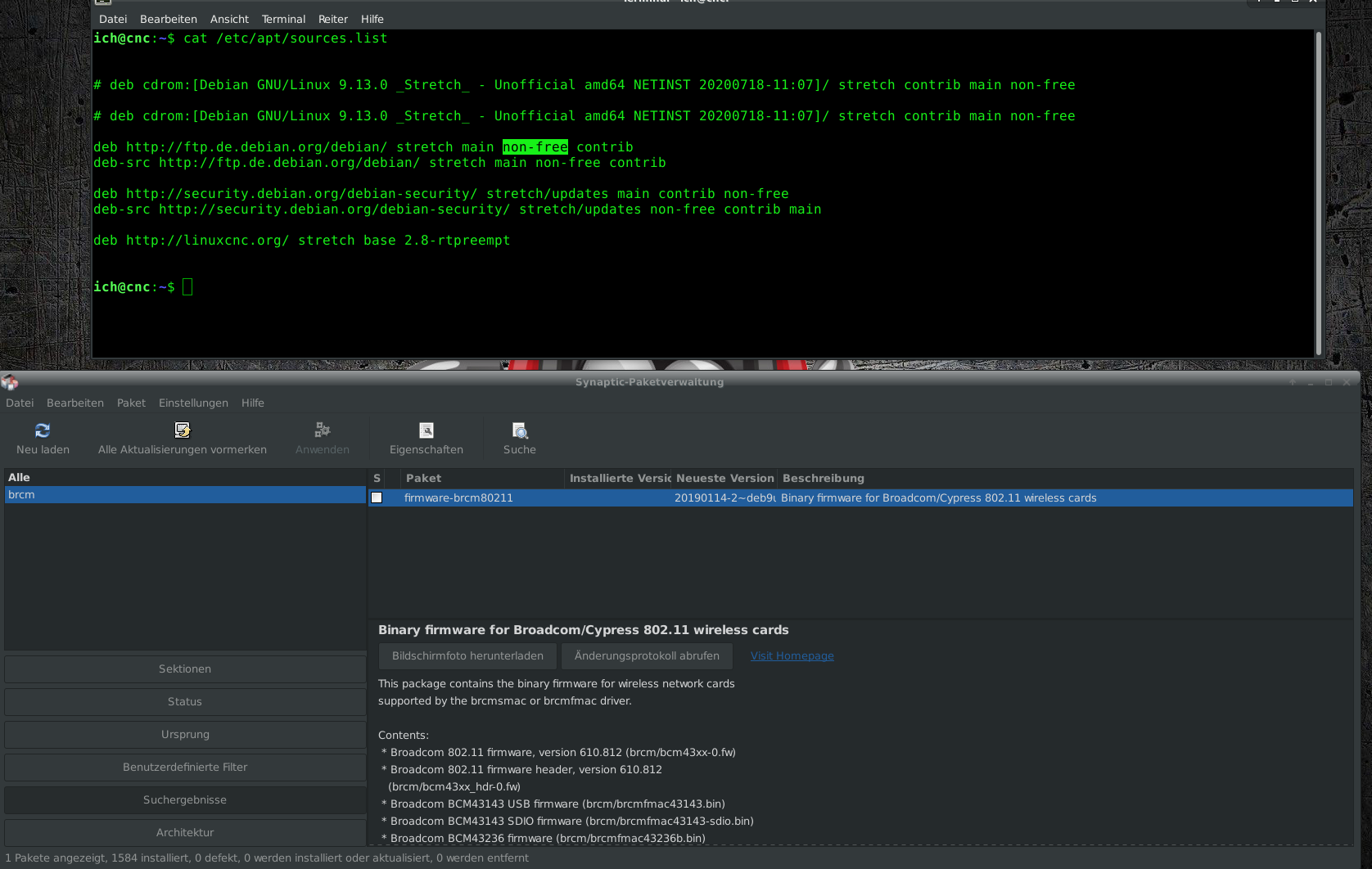

For this could be helpful to add the non-free option in source.list. You can install the driver with your apt manager.
