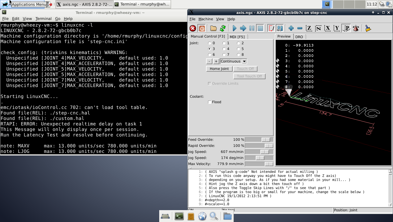

15 Jan 2022 18:07 - 15 Jan 2022 18:13 #231975
by ALittleOffTheRails
Replied by ALittleOffTheRails on topic How to proper compile, built, and install linuxCNC
Ok I installed a Wheezy from the ISO to a virtual machine.
Updated Linuxcnc to 2.8.2
Compiled and installed the comp.
Fiddled with the ini & hal files from the wiki to get them to work with 2.8.2
Ran the config and it loaded fine with no issues.
So I'm guessing it has to be something at your end. As far as I can tell the config will load to the axis gui.

- Matt Hat
- Posts: 47
16 Jan 2022 03:45 - 16 Jan 2022 04:11 #231995
by Matt Hat
Replied by Matt Hat on topic How to proper compile, built, and install linuxCNC
Thank you, such efforts too support is very much appreciated!!
Your right, it is - as in other cases - the config file format that makes the issue.
1) Fresh install of lncnc 2.9 from buildbot.linuxcnc,org
2) sudo halcompile --install rot4thaxiskin.c
3) Open a running config file and let it convert automatically to new format
4) Add the modification from the wiki manually
- First Only add the--> no error. kinematics is loading.
5) adapt the .ini: Most evidently, format changes of
Attention: the wiki defines 8x [AXIS] but now we need 9x [JOINTS]
6) connect
This configs are still quite outside of my circle of competence.
- 9 joints enough for 4 axes with travel limits
- What do we need for the tool offsets UVW, only [JOINTS] it seems?
