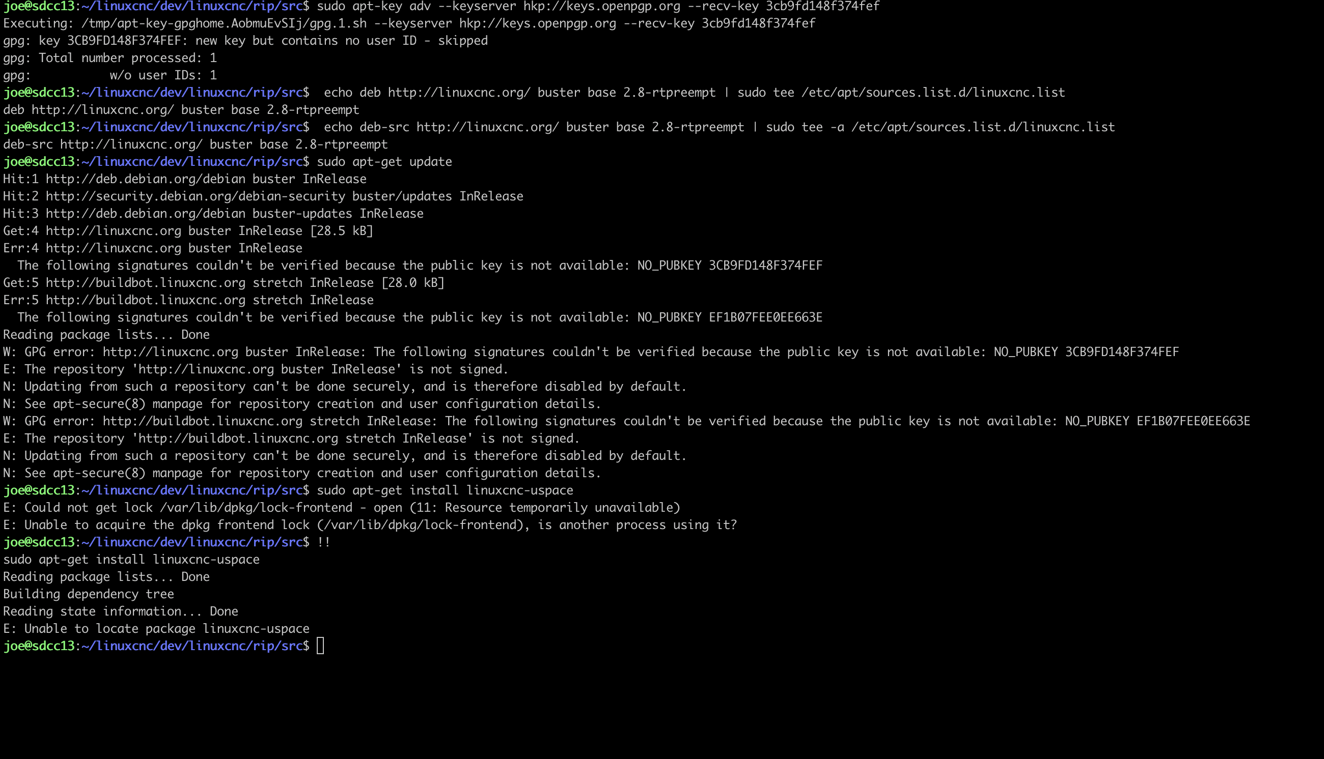

I'm back with yet another install failure. This is a new computer that also won't install from the 2.8.2 .iso. But it will install from the debian 10 .iso. So, I'm starting with that and trying to add linuxcnc. To do this, I am directly copying the commands from the install directions as follows, but apt can't find linuxcnc-uspace. Buildbot also fails at finding linuxcnc-uspace.

The keyserver is not working as it skipped adding the key, top of your screenshot.
Try changing that address to
keyserver.ubuntu.com

Thanks, the install finished.
