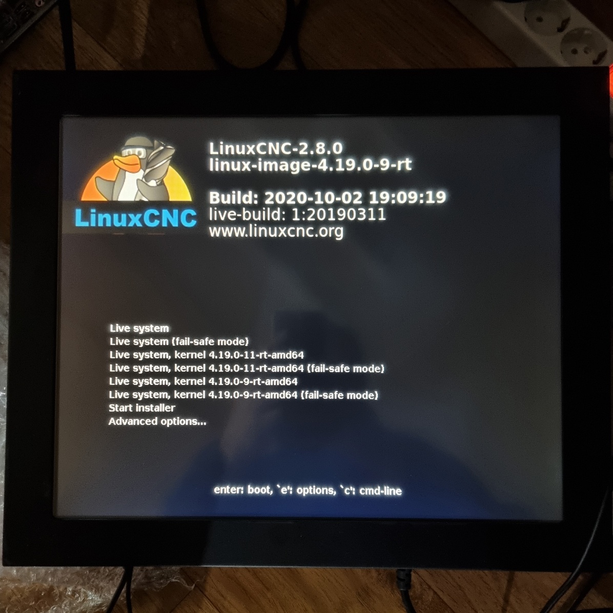

02 Mar 2022 08:44 - 02 Mar 2022 08:50 #236186
by chochanghyun
How to install Linuxcnc. . . was created by chochanghyun

02 Mar 2022 08:54 #236189
Replied by tommylight on topic How to install Linuxcnc. . .
in PC BIOS:
disable UEFI boot
enable Legacy boot
disable Secure boot
retsart
disable UEFI boot
enable Legacy boot
disable Secure boot
retsart

- Posts: 19904
02 Mar 2022 17:42 #236228
Replied by andypugh on topic How to install Linuxcnc. . .
That said, I bought a UEFI PC specifically to test the LiveCD, and it worked for me.
I am assuming that your problem is that "Start Installer" does not start the installer?
I think there is a non-graphical installer under "Advanced options". You could try that.

02 Mar 2022 17:52 #236230
UEFI is very finicky, i can install Mint 20 on all UEFI boards with it active but i can not install it on a HP laptop/tablet that has UEFI and it can not be disabled. Mint 19 installs on that same laptop/tablet but does not on all other boards i have. All boards are B550, X570, X470 and B450 made by Asus and Gigabyte and MSI, all with their latest respective BIOS. Intel got the boot !
Both Mint versions install on Dell 9020 and 7010 though with UEFI and without it.

02 Mar 2022 20:31 #236240
by chochanghyun
Replied by chochanghyun on topic How to install Linuxcnc. . .
Somehow the installation was successful, but the uefi problem on the laptop or on a specific board is quite annoying.
