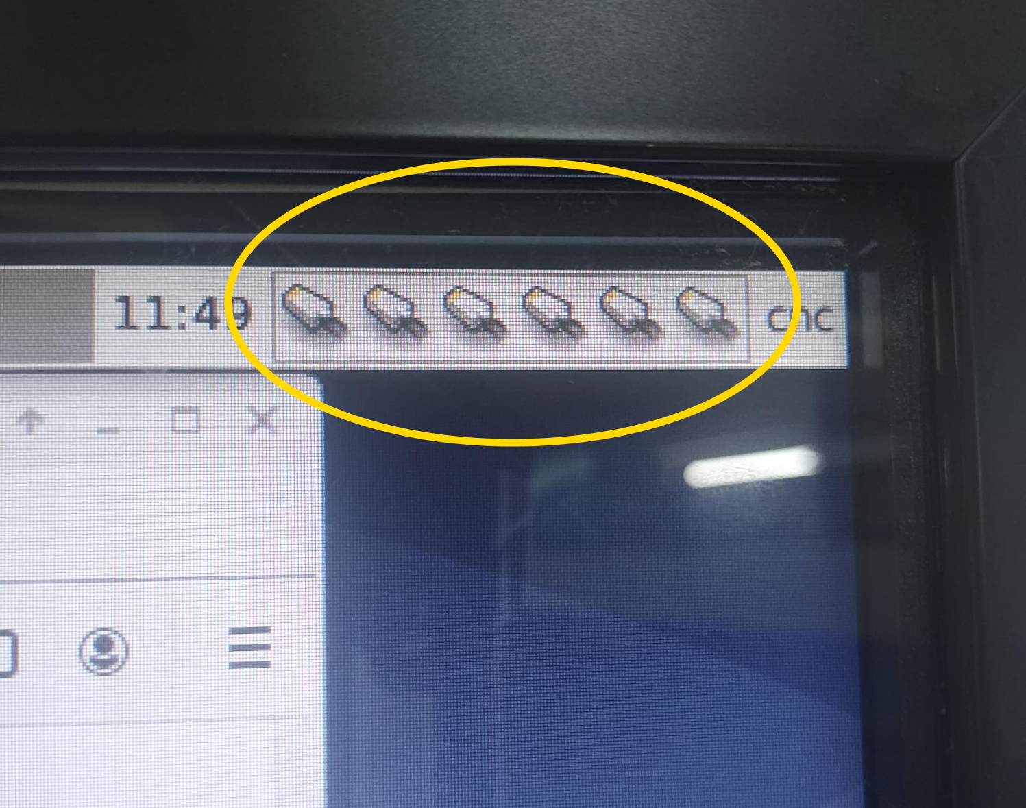

Hello.
Have just installed Buster and moved to 2.8.2 after using Wheezy until now.
I used the Debian 10 Buster ISO from the downloads page.
Each time I start the computer, it adds another ethernet connection. I am using a Dell Optiplex 790, which only has one wired ethernet connection (and no wifi), during install the the machine was connected to the internet via this cable.
When I check all the connections their properties are all the same, so I am unsure why it is creating new connections with each start-up.I am up to six so far, and have attached a picture to illustrate... Hopefully there is a simple setting which might resolve this. Thanks!

Replied by phillc54 on topic Multiple Increasing ethernet connections
There is a fix here:
forum.linuxcnc.org/38-general-linuxcnc-q...little-issues#226480
