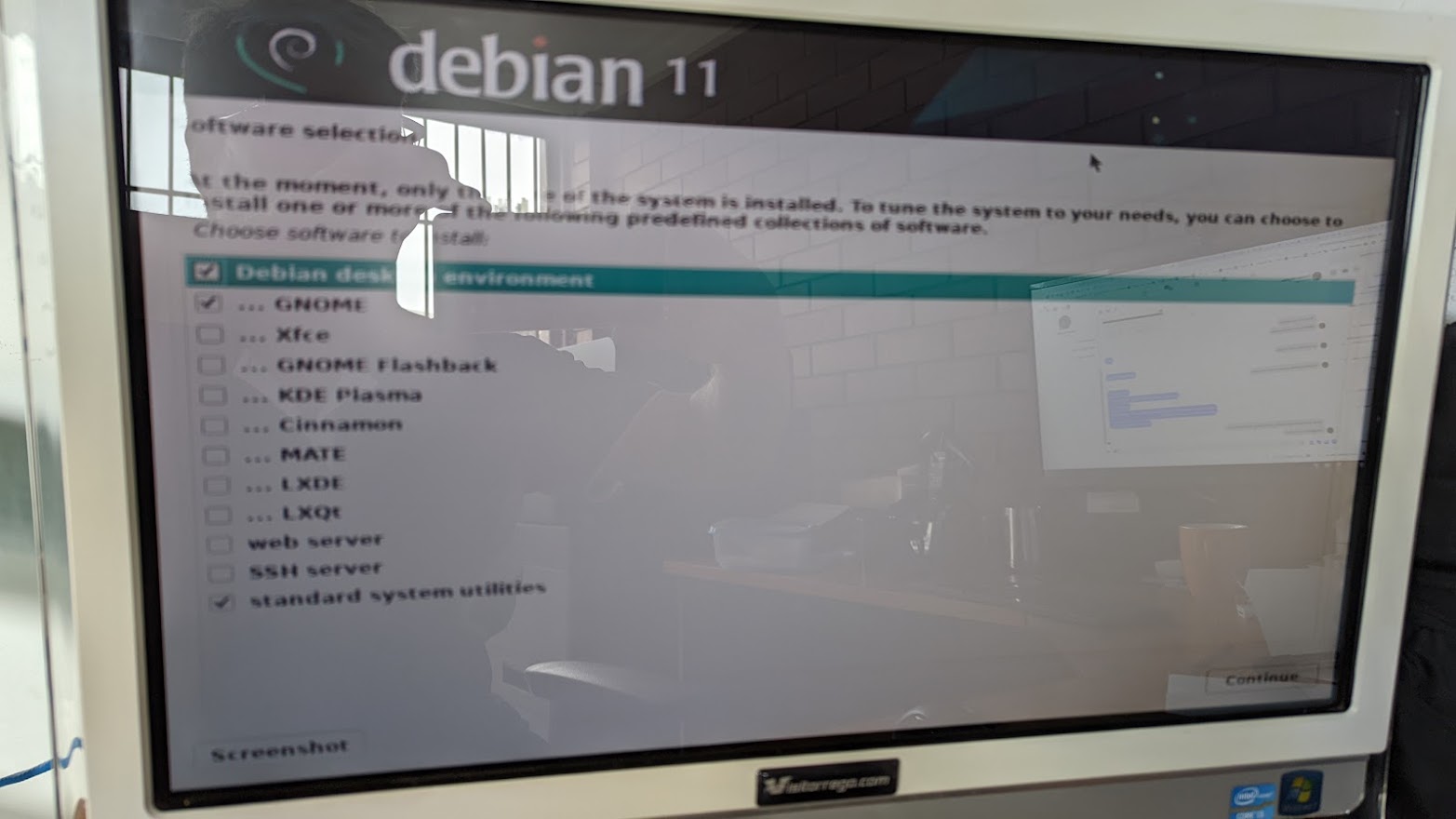

Have to change things again, for some reason "testing" is not "testing" in debian, just wasted over 2 hours chasing stuff and testing ISO's, so for now "testing" is only the link provided by Rod that contains only one single flavor and the old graphical installer, and fails to install GRUB often. So for now we can use this or revert back to changing repositories.
The "testing" i linked to with Live flavors is still version 11. I am baffled and confused and cross eyed !

Replied by rodw on topic Linuxcnc on Debian Bookworm - a shortcut to master branch
I don't really know what Tommy is complaining about. I think it might be possible for an impatient user to proceed without installing grub but you do get a full choice of what desktop you want. I've been sticking to the standard one but it does take a bit of getting used to. xfce will give you what you are used to with Linuxcnc.
If you really want to do it the hard way, select the advanced installer.
Note that the Installer is branded debian 11 but the firmware says its not

Now its installed, I now can confirm this worked perfectly using the weekly build. Currently
cdimage.debian.org/cdimage/unofficial/no...uilds/amd64/iso-dvd/
But don't use this one, drill in and get the latest as it changes every week.
