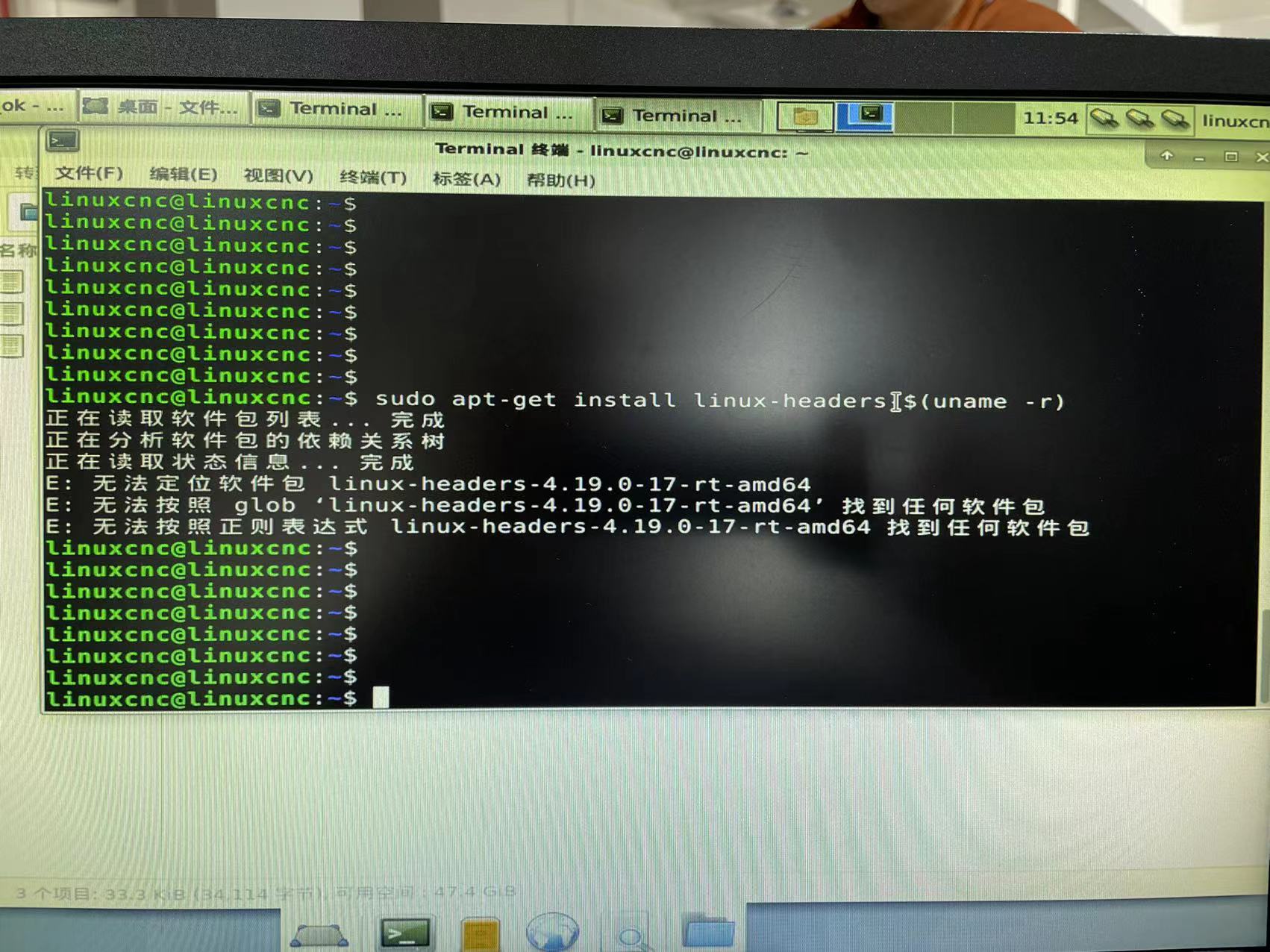

Hello, brothers:

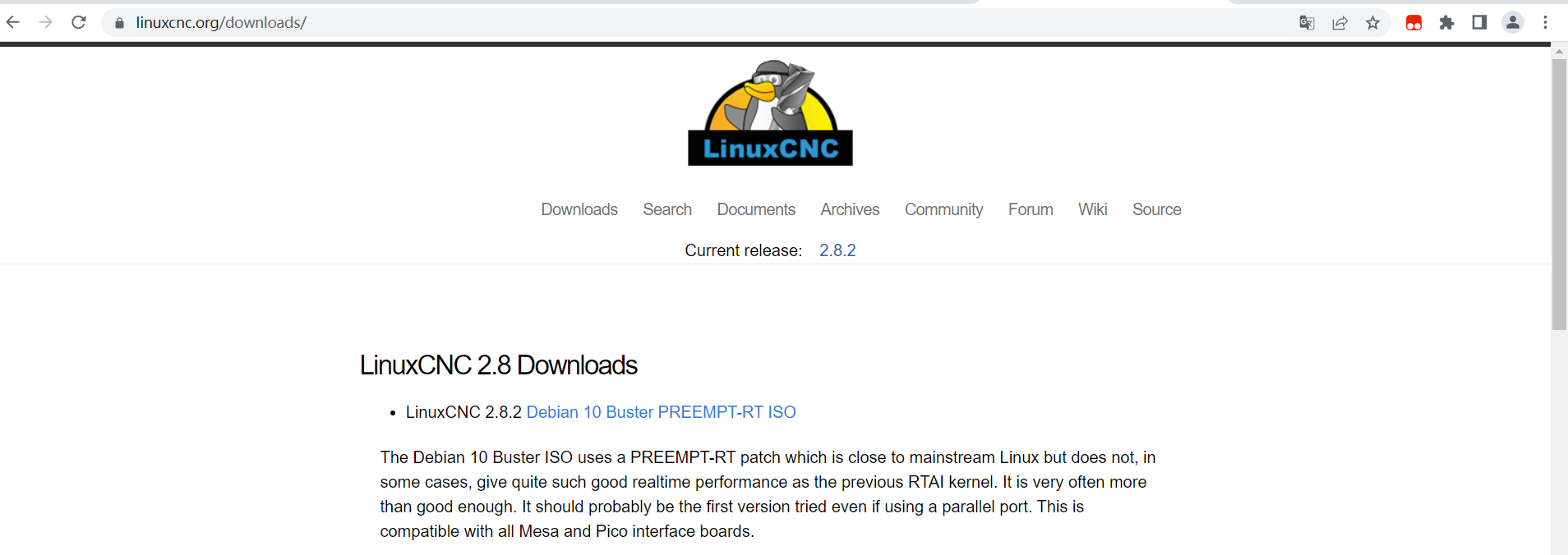

I downloaded this version of the system from the official linuxcnc website yesterday:
“LinuxCNC 2.8.2 Debian 10 Buster PREEMPT-RT ISO”
And the installation was successful. Everything is OK

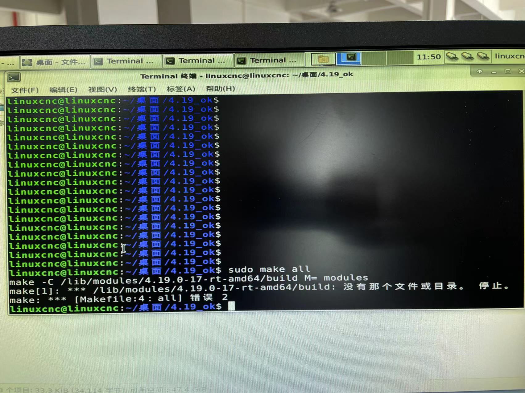

But when I need to use the "make" command today, I will be prompted:
"/lib/modules/4.19.0-17-rt-and64/build: no that file or directory"
As shown in figure 2
I searched for a long time and found that I lacked "headers"!
So I used the command: "sudo apt get install Linux headers-$(uname -r)"
But it reminds me that I failed:
E: Unable to locate package linux-headers-4.19.0-17-rt-amd
E: Unable to find any packages according to Glob "linux-headers-4.19.0-17-rt-amd"
E: Cannot find any packages according to the regular expression "linux-headers-4.19.0-17-rt-amd"
As shown in Figure 3
How I should solve this thorny problem has been bothering me all day
Thank you

sudo apt-get update
sudo apt-get install linux-headers-4.19.0-17-rt-amdPlease Log in or Create an account to join the conversation.

by EdisonBin
Replied by EdisonBin on topic The new system is missing "Linux headers" and the search fails
Thank you, Tommy!
I used another method to solve this problem, because I still can't find the kernel header file of this version using your method.
Is it because this header file is too old and out of date.
I used the following command:
sudo apt-get update
sudo apt-get upgrade
sudo apt-get dist-upgrade
Then I found that my system kernel changed from "4.19.0-17-rt-amd" to "4.19.0-20-rt-amd"
Then I can use this command:
"sudo apt get install Linux headers-$(uname -r)”
But I am puzzled whether my kernel version has been upgraded?
Which command caused this?
