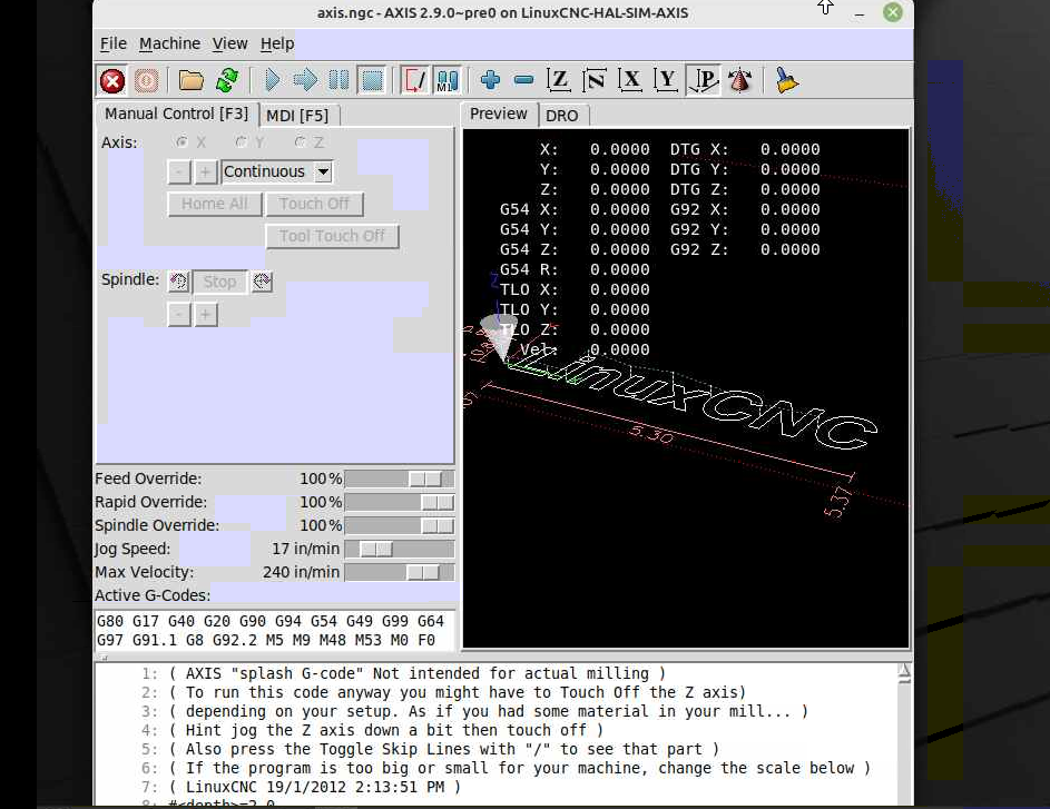

- dberndt
- Posts: 48
13 Oct 2022 17:20 #254078
by dberndt
Replied by dberndt on topic Installing LinuxCNC 2.9 or Master on Linux Mint 21
Any thoughts on how to install linuxcnc-dev on mint 21?... Well I just grabbed the uspace-dev.deb off the repo in the same wget fashion as the linuxcnc-uspace was grabbed in the instructions. But I'm still curious as to why I can't install via apt when the repos are added. What's with the python version issues?
More importantly... Where has the maximize button gone to? Mint 21+cinnamon results in the maximize button disappearing. It's there in other apps... It is available if I switch to mate but it doesn't actually maximize the window. It squares out the corners of the window as though it was maximized, but the window dimensions do not actually change. Please Ignore the terrible screenshot quality, it was taken over a compressed VNC session and is not related to the issue.

13 Oct 2022 17:37 - 13 Oct 2022 17:40 #254079
What repos?
Nowhere in this tutorial is adding repos mentioned.
The package must be from the debian repo, again you or i did not add repos, here:
http.us.debian.org/debian/pool/main/l/li...744cdef6-1_amd64.deb
Replied by tommylight on topic Installing LinuxCNC 2.9 or Master on Linux Mint 21
What repos?
Screen/resolution to small, there is no space where to maximize anything.It is available if I switch to mate but it doesn't actually maximize the window. It squares out the corners of the window as though it was maximized, but the window dimensions do not actually change.
Last edit: 13 Oct 2022 17:40 by tommylight.
- dberndt
- Posts: 48
13 Oct 2022 17:56 #254080
by dberndt
I tried adding the buildbot repos. buildbot.linuxcnc.org/ to get the linuxcnc-dev package initially. Seemed like the thing to do to me.
- Posts: 21894
- Thank you received: 7464
13 Oct 2022 18:37 #254082
At the very beginning it says:
-LinuxCNC Master is still in development, although it is reliable, something might now work
-LinuxCNC version is from the Debian repositories, dated 06 September of this year.
Nope!I tried adding the buildbot repos. buildbot.linuxcnc.org/ to get the linuxcnc-dev package initially. Seemed like the thing to do to me.
