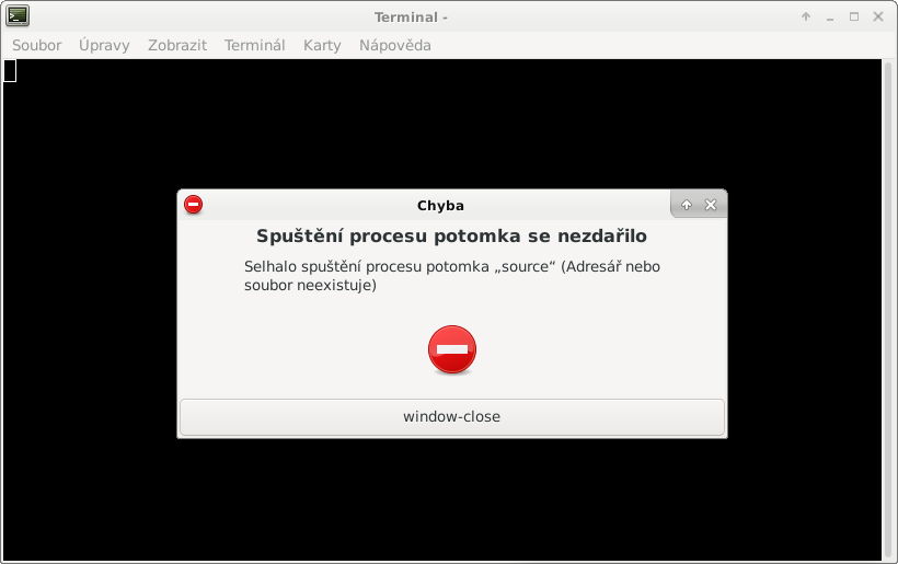

I use RIP installation. Using LCNC is fine. But setting rip environment is annoying.
I have to:
1) run terminal
2) set directory: cd /home/zdenek/linuxcnc/linuxcnc-2.8/scripts
3) use: source rip-environment
I wanted make Desktop Entry:[/code]
But it dont work.
I apologize for Czech Location.
I have to:
1) run terminal
[code][Desktop Entry]Version=1.0Type=Application
Name=RIP environment
Comment=
Exec=xfce4-terminal -e "source /home/zdenek/linuxcnc/linuxcnc-2.8/scripts/rip-environment" -H
Icon=
Path=
Terminal=true
StartupNotify=falseBut it dont work.
Try
Exec=xfce4-terminal -e "/home/zdenek/linuxcnc/linuxcnc-2.8/scripts/rip-environment" -H

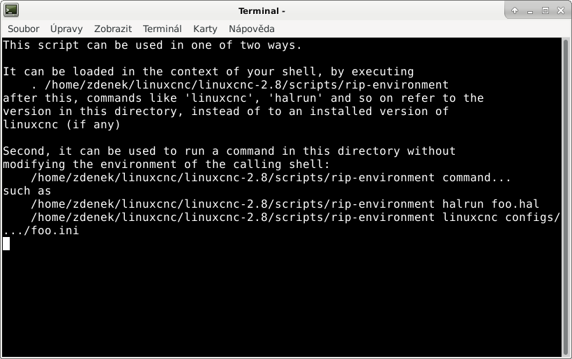

- zz912
- Posts: 596
- Thank you received: 98
20 Aug 2022 21:35 #250130
by zz912
Replied by zz912 on topic Desktop Entry - source rip-environment

Maybe
Exec=xfce4-terminal -e "/home/zdenek/linuxcnc/linuxcnc-2.8/scripts/rip-environment linuxcnc configs/nameoffolder/yourinihere.ini" -H
Just change the stuff after configs.

21 Aug 2022 04:19 #250140
by phillc54
Replied by phillc54 on topic Desktop Entry - source rip-environment
You can call the linuxcnc script directly, it will set the environment, this is from a desktop launcher in MXLinux21
xfce4-terminal -e "/home/phill/linuxcnc-dev/scripts/linuxcnc /home/phill/linuxcnc/configs/1_met/aaa.ini" -HPlease Log in or Create an account to join the conversation.

Thanks for help. I solve it:
[Desktop Entry]
Version=1.0
Type=Application
Comment=
Exec=xfce4-terminal -H -e 'bash -c \ "source /home/zdenek/linuxcnc/linuxcnc-2.8/scripts/rip-environment; $SHELL"'
Icon=
Path=
Terminal=true
StartupNotify=false
