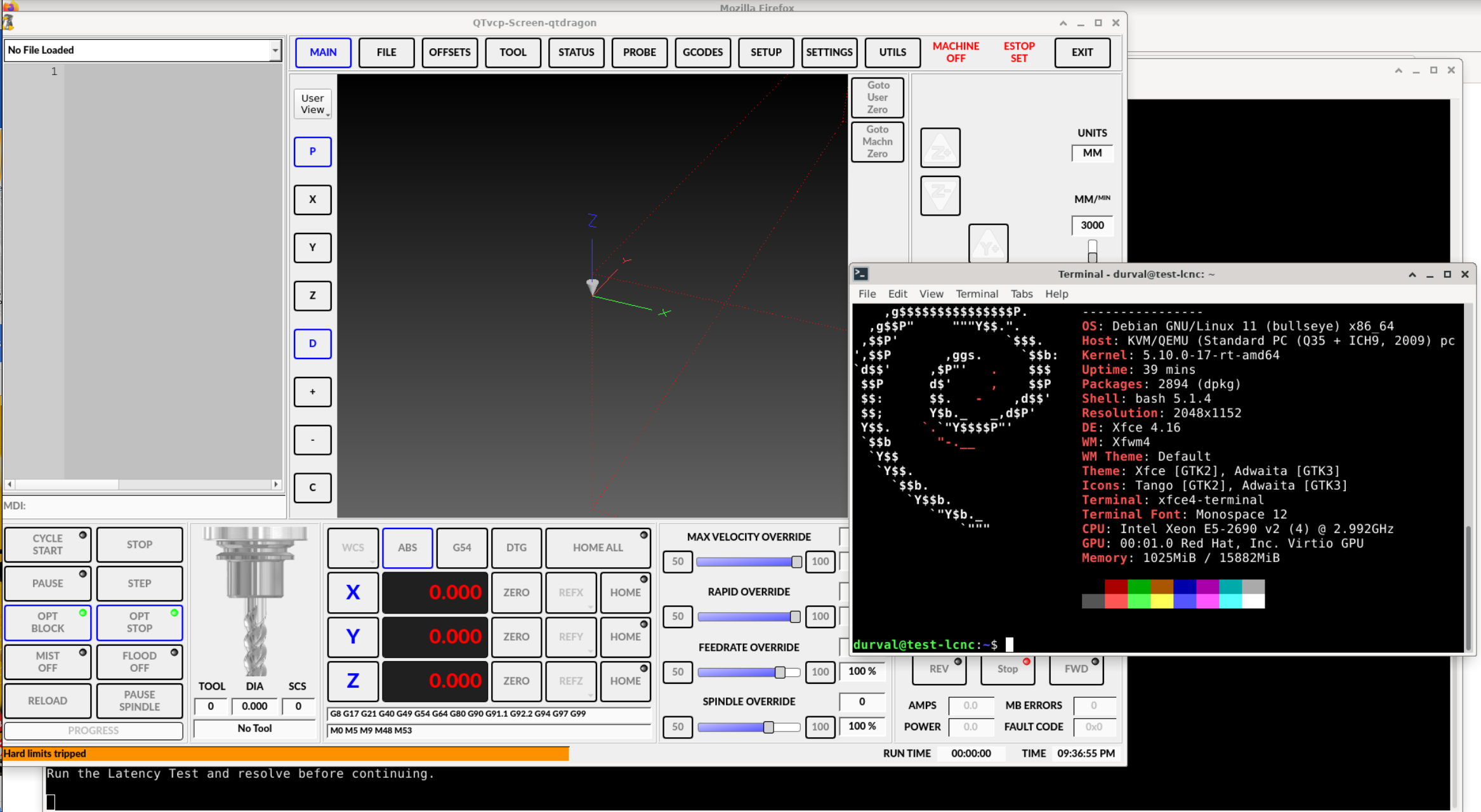

there is bookworm and bullseye packages..
I do not want to go to sid on bookworm
Also for me with bullseye updated and upgraded packages this
github.com/jogo-nz/lcnc-bullseye-installer does not compile for me.
Also www.qtpyvcp.com/install/bullseye.html has older linuxcnc-2.9.0pre0 .
This is for my use and research.
I'm retired and with a lot of time to spend .
so for that why not share my work
Anyone is free to use or not, this is for the community.

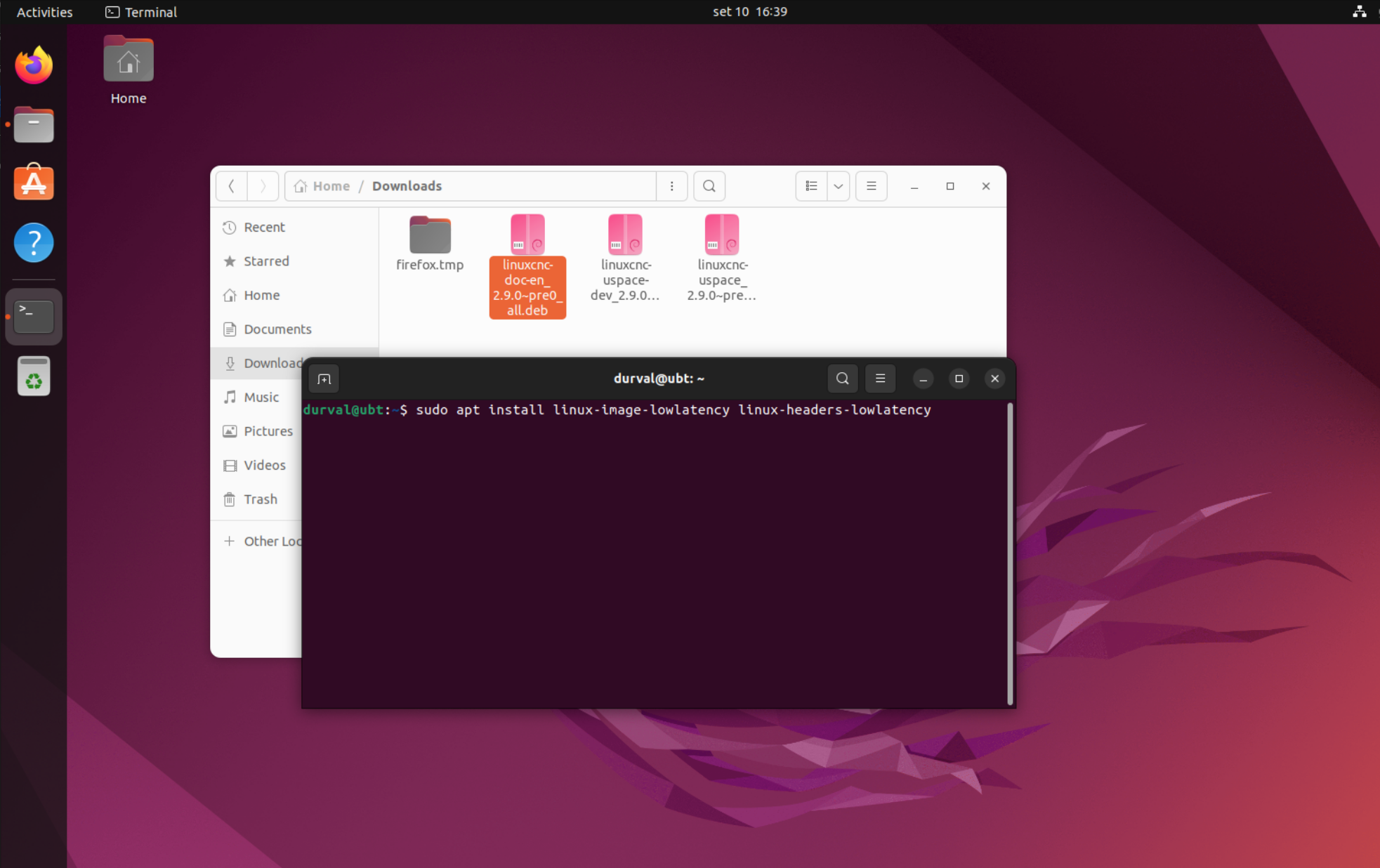

10 Sep 2022 15:07 #251634
by kwarup
Replied by kwarup on topic Bookworm and Bullseye with latest git linuxcnc

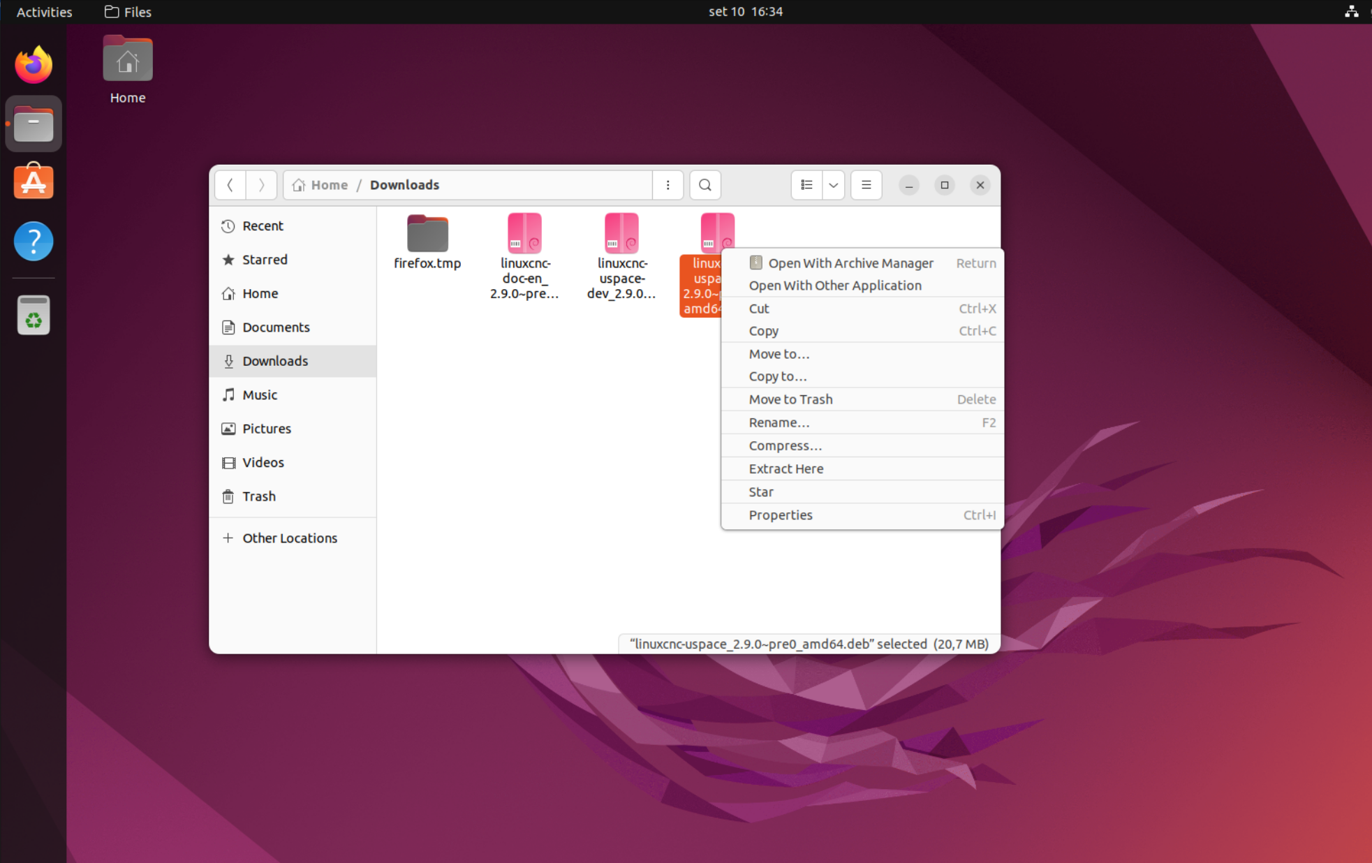

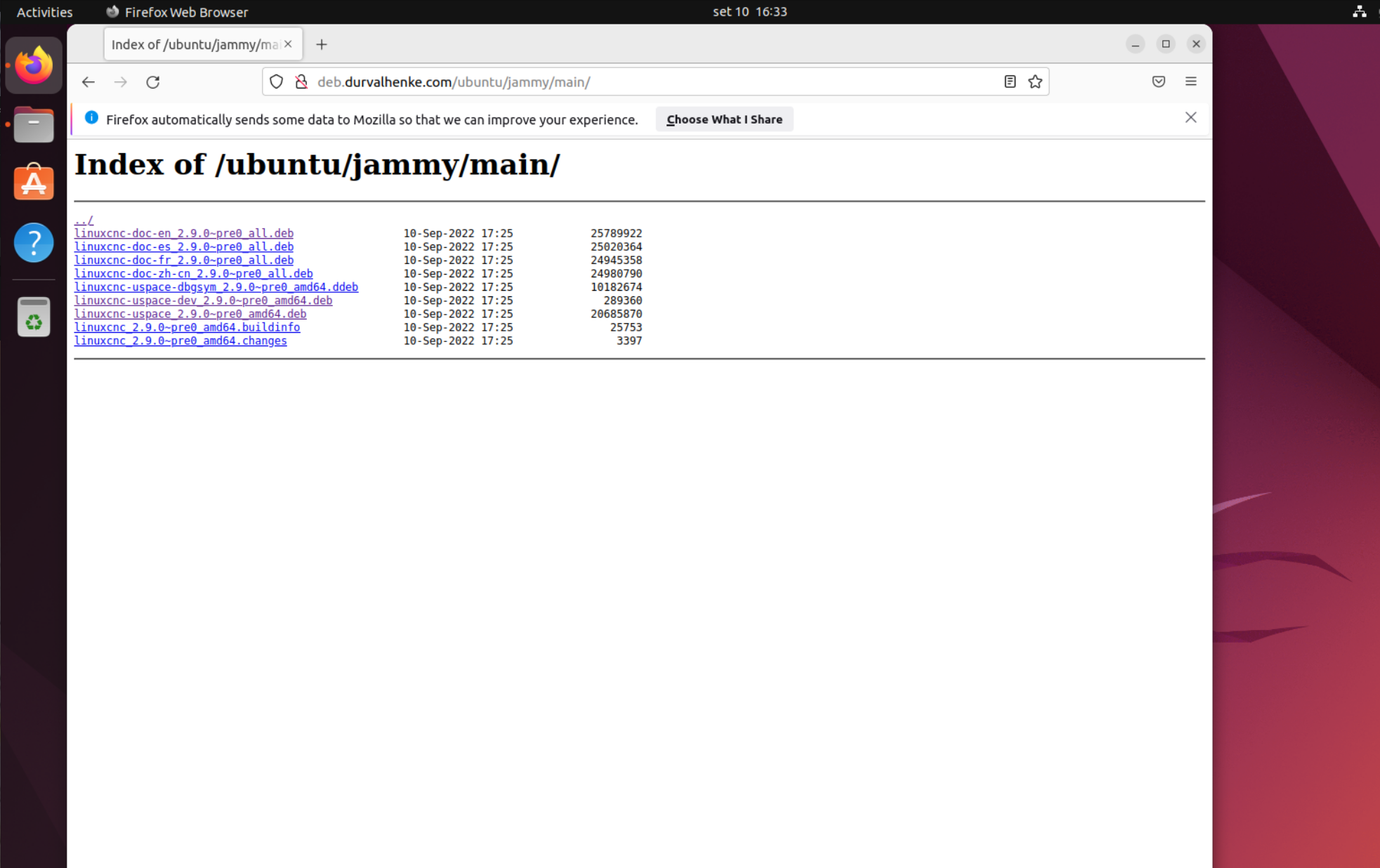

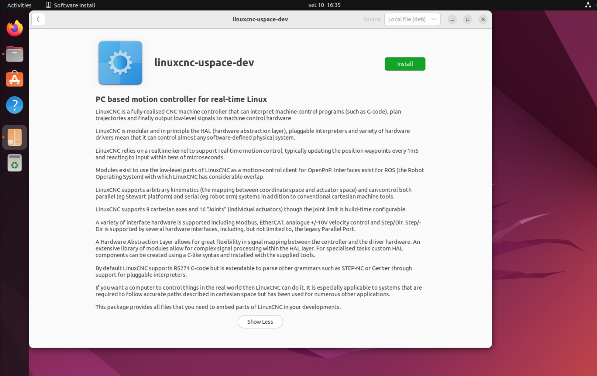

Packages for Ubuntu Jammy finished..Now reading how to do a ppa
Who is curious and want to try ..
download pakages
deb.durvalhenke.com/ubuntu/jammy/main/
download pakages

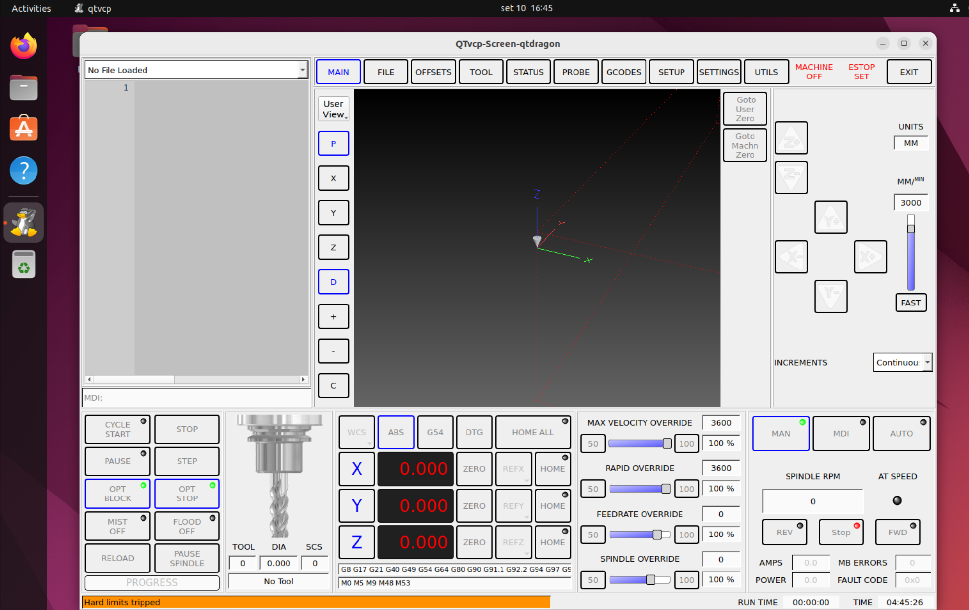

www.qtpyvcp.com/install/bullseye.html clones the 2.9 source code so it will always be 100% up to date.there is bookworm and bullseye packages..
The following user(s) said Thank You: kwarup
