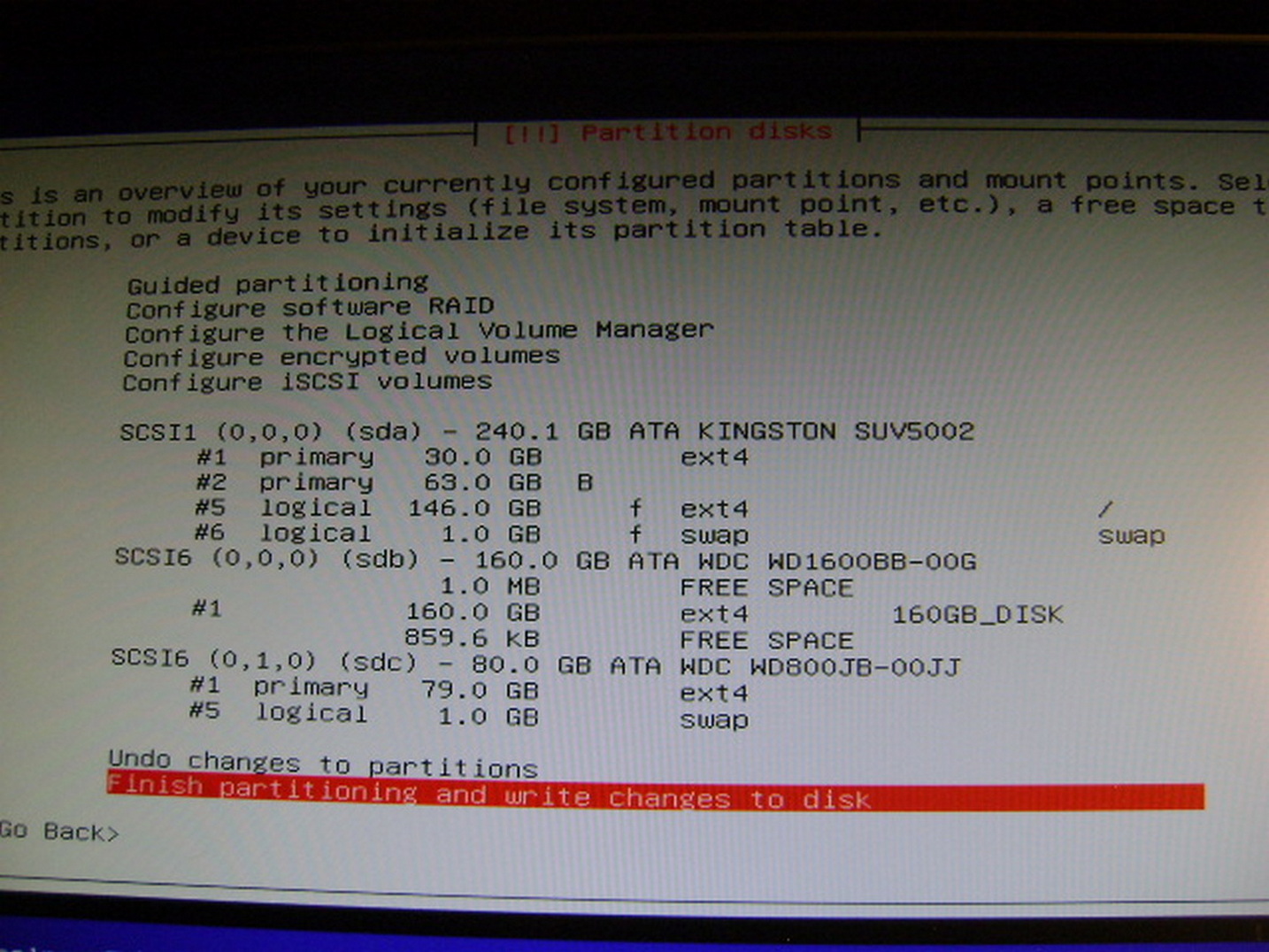

Here is the picture of the SSD partitions
01 Nov 2022 21:53 - 01 Nov 2022 22:02 #255747 by arvidb
Replied by arvidb on topic Uninstalling LinuxCNC
That's not a picture from gparted though, but from the LinuxCNC installer perhaps? I specifically asked you to boot a LiveCD, run gparted and take a screenshot since it should also show free space on the partitions themselves, which would give better clues to what happened.
Anyway, given the limited info available, and comparing your first post (somewhat sanitized to include linebreaks) with your latest:
/dev/sda 240GB SSD with 2 partitions, Ext4(version 4)
/dev/sda1 30GB(Free 15GB), UUID, LinuxBootable Mounted at FileSystem Root
/dev/sda2 210GB(Free 155GB),UUID, Linux, Mounted at Home
/dev/sda 240.1 GB SSD
/dev/sda1 30 GB ext4
/dev/sda2 63 GB B (no filesystem info)
/dev/sda3 146 GB ext4
/dev/sda4 1.0 GB swap
my guess to what happened is the following:
1) You resized your 210 GB home partition sda2 to 63 GB (rather than the more appropriate ~170 GB to leave about 32 GiB free space for LinuxCNC).
2) You then formatted this partition, which will have wiped all user data from your Mint install. You also made it bootable, for some reason. (The only thing you needed to do was to shrink sda2 a bit and the Debian/LinuxCNC install would have taken care of creating a new partition in the newly freed space, formatting it etc.)
3) You then installed LinuxCNC to the space freed up from the resizing of your home partition, which created partitions sda3 and sda4.
Your Mint system partition (sda1) is intact, which explains that you can still boot Mint. However all your user data is gone, which explains the long boot time (Mint probably trying to figure out what the heck happened to it) and the fact you cannot "do" anything on your Mint system. It would also explain the “error-no such device 3283a276-4585..." message since its home filesystem would be missing.
Now, I might be wrong about 2) above - maybe, just maybe it isn't formatted and Mint was just trying to cope with there being no free space left on the device. Obviously this makes all the difference - the difference between your data being completely gone or still there. So you need to figure out what's actually on sda2. You could start by supplying the requested screenshot from gparted. But perhaps an easier way would be to mount sda2 in the booted LiveCD. There should be icons on the desktop allowing you to access the existing partitions on the disks from the LiveCD system.
Edit: No, better to supply the gparted screenshot, since the installer doesn't give any filesystem info about sda2. Something weird is going on there.

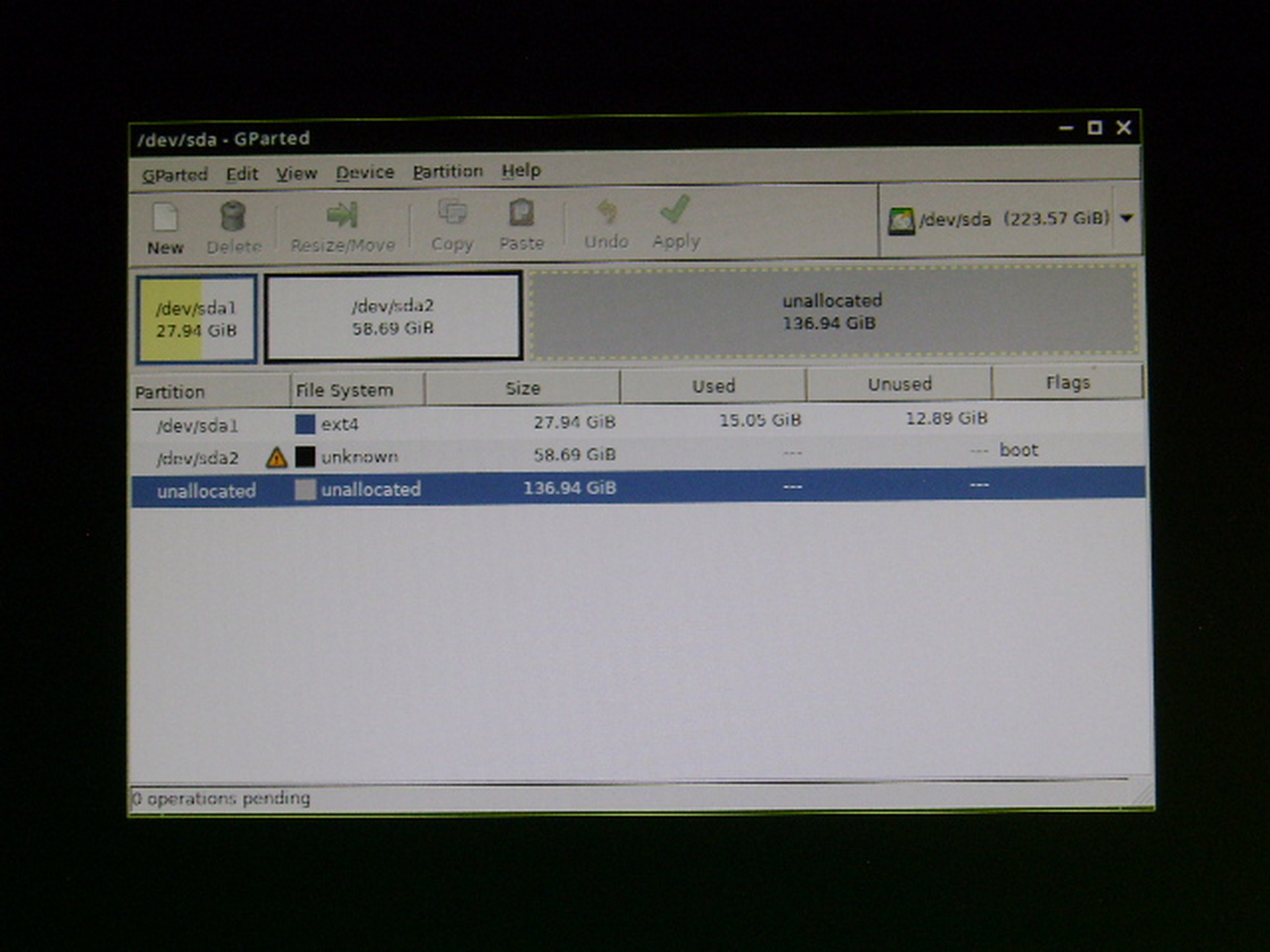

Just remember I had a DVD which contains the software FoxClone, was given to me from a member at the Linux Mint forum and it includes gparted. I hope the attached image is what you are after. Now with Foxclone I can do many things on hard disks but I can’t say I’m an expert with it.I don’t intent to go outside to recover my data. If my data is lost it’s just tons of work for me to re install everything.

Yes, that's the photo I wanted.
Before I started any work today my 240GB SSD had 2 partitions, one about 30GB was for the Linux Mint and the rest was free, about 200GB.
What you describe would be one partition (30 GB) and the rest free space. I think you really had two partitions: one about 30 GB and one about 200 GB, the latter containing your Mint user data (mounted to /home). And no free space. At least according to your first post. Again, this explains why you couldn't make the second partition smaller than 62 GB: it already contained that amount of data!
You say you didn't install LinuxCNC, then you say "I asked to be formatted" and that you aborted the installation once already started(?). It doesn't make sense to me and I cannot judge what actually happened. But whatever happened, there does not seem to be any valid data on sda2 (anymore?).
To your opinion which way is the best to recover my Linux Mint?
Since I don't know what happened, and you don't want to go to an outside company to recover your data, I cannot say what the best way is. A few options:
1) Mount sda1, examine it and try to find your data. Since you have partitions coming and going between your screenshots and printouts and give contradicting info about the initial state of the drive and about what you actually did, maybe it really is still there, if Mint's home was *not* on sda2.
2) You could remove your current SSD from the computer, install a new one, reinstall Linux Mint and try to restore your Timeshift backup. This way you can still send your current SSD for data recovery if Timeshift fails. Since I have not used Timeshift I have no idea if it would work. My bet is not since its homepage very clearly states that it doesn't backup user data. But I really have no idea.
3) Or, reinstall Linux Mint on your current drive and take a chance with Timeshift. If it fails, your data is gone for sure.
