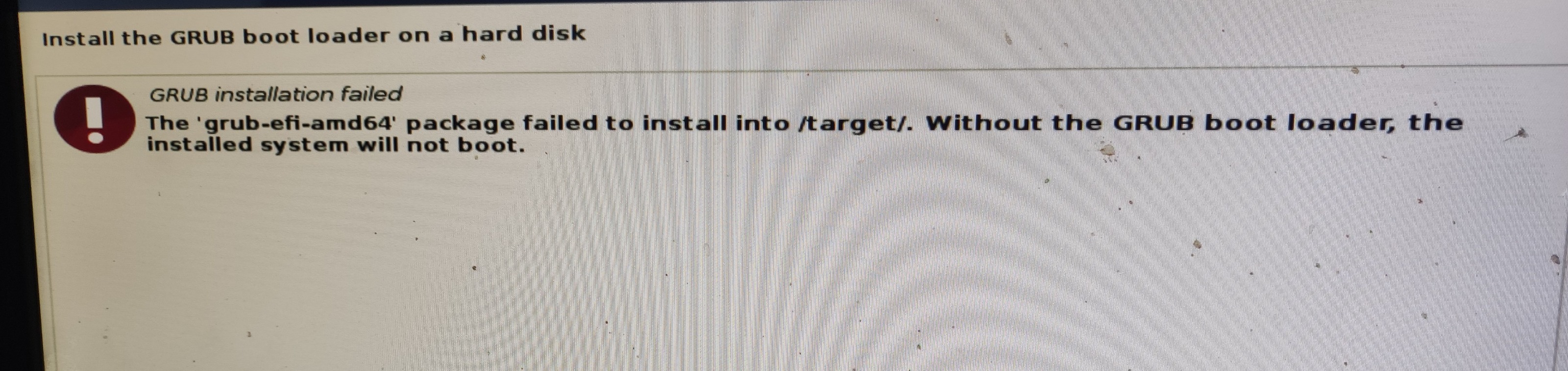

install linuxcnc from USB on HP EliteDesk 8100

17 Oct 2022 20:23 #254354
Replied by tommylight on topic install linuxcnc from USB on HP EliteDesk 8100
Disable secure boot in BIOS.
Also try disabling UEFI anything.

17 Oct 2022 20:43 #254360
by chris@cnc
Replied by chris@cnc on topic install linuxcnc from USB on HP EliteDesk 8100
i remember to had similar Problem but not how i fix it. probably was it quite simple. reboot system and start text based installer. mount the root drive and try to install grub again.

17 Oct 2022 20:46 #254362
by emad_ahmed2
Replied by emad_ahmed2 on topic install linuxcnc from USB on HP EliteDesk 8100
the BIOS dos not have UEFI

22 Oct 2022 19:33 #254794
Replied by Todd Zuercher on topic install linuxcnc from USB on HP EliteDesk 8100
On my newer HP the bios doesn't give an option for "UEFI". However that is the default setting. You must choose "Legacy" for the non UEFI boot. That said I've not experienced problems installing Linux on UEFI. (If it is a new enough distro.

22 Oct 2022 21:26 #254802
by JPL
Replied by JPL on topic install linuxcnc from USB on HP EliteDesk 8100
Hummm, if I remember correctly the installer give you the choice of which disk to install grub. Maybe try with grub installed on the same disk that you've installed linuxcnc. Also, UEFI should not be a problem on HP 8100 as long as you have a recent bios version.
