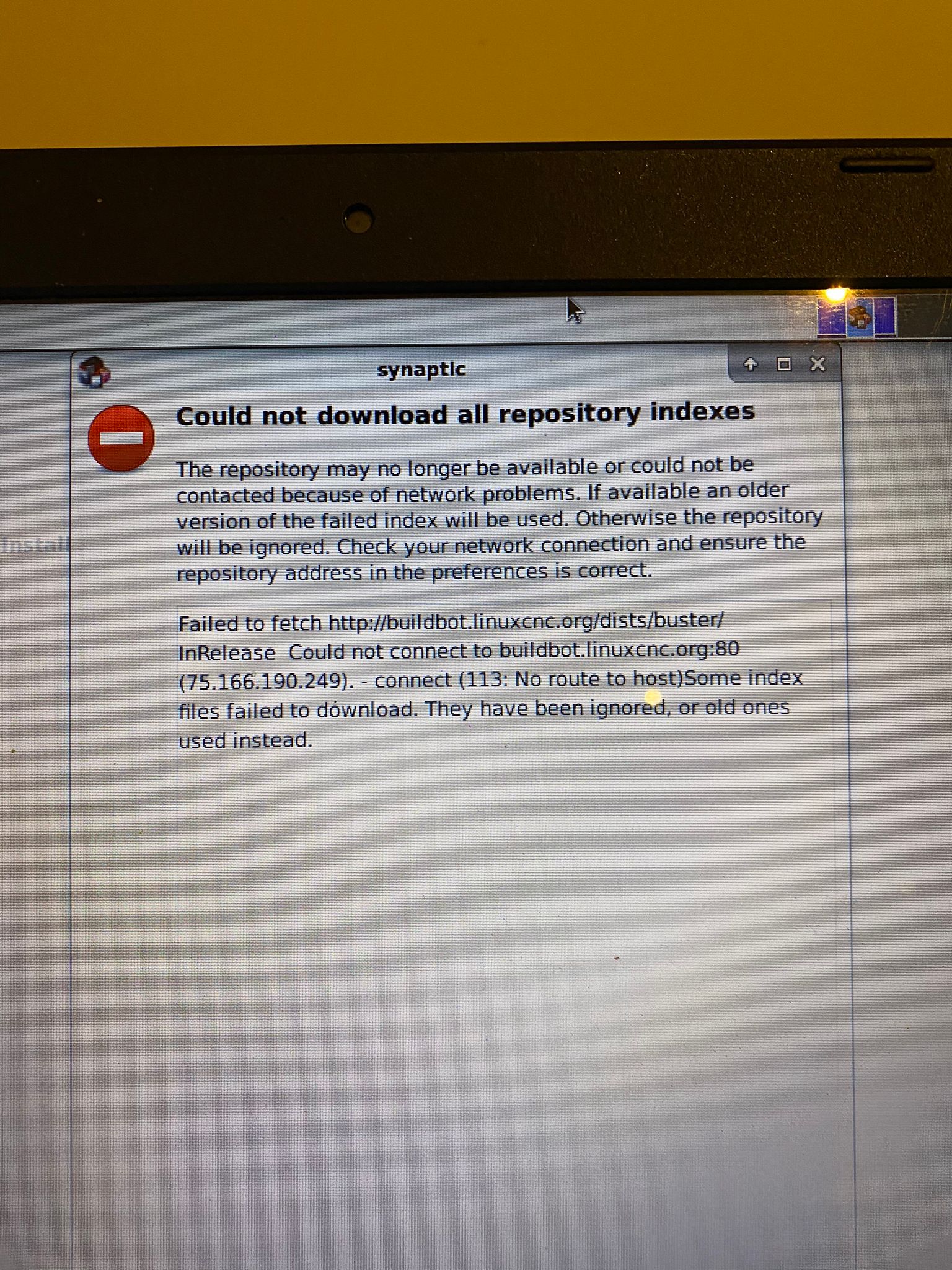

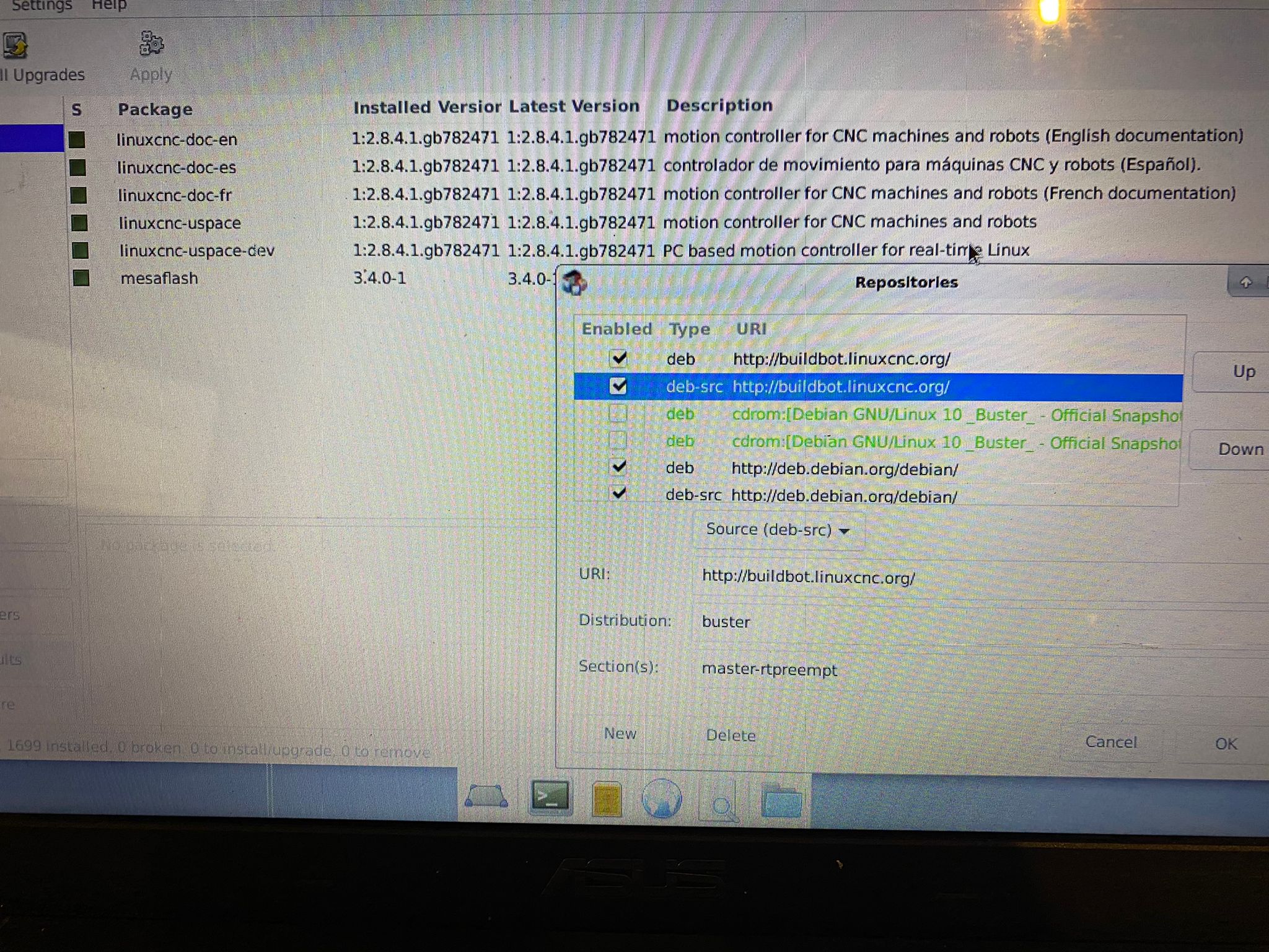

Hey. I'm trying to install LinuxCNC 2.9 on debian 10 buster, in order to be able to run a QtPlasmaC configuration.
The following error appears: (tried several things already, with no success): (pictures added)

Replied by tommylight on topic updating linuxcnc from 2.8 to 2.9 with no success.
Might want to wait a bit, there are other reports of site not being reachable.

i can access the website in my windows pc browser. is there any way i can download the files for 2.9 linuxcnc and install them " manually" in my linux PC?

Try this, if you are running Buster version of Debian:
buildbot.linuxcnc.org/dists/buster/2.9-r...g1b3e99592_amd64.deb

Replied by andypugh on topic updating linuxcnc from 2.8 to 2.9 with no success.
If you want 2.9 then use 2.9 rather than master in the deb src line. (master is now 2.10)
