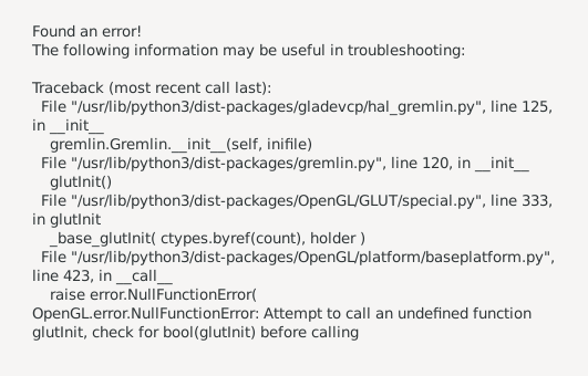

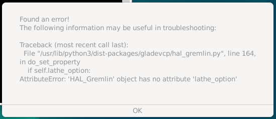

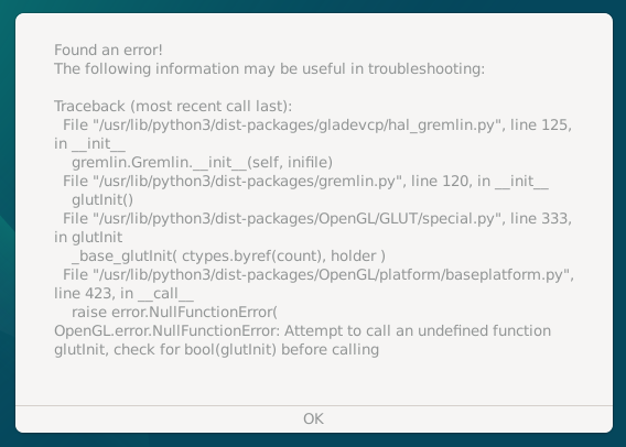

13 Dec 2022 17:58 #259378 by RyanB
Replied by RyanB on topic Linux CNC Errors when starting gmoccapy
Rodw, I did a fresh install of debian bookworm, selecting xfce and basic utilities, unselecting the desktop environment the installer selects by default. I ran the commands to install linuxcnc and the command you mentioned for libghc. These 2 error windows are popping up, with the second popping up twice when starting gmoccopy:    .
