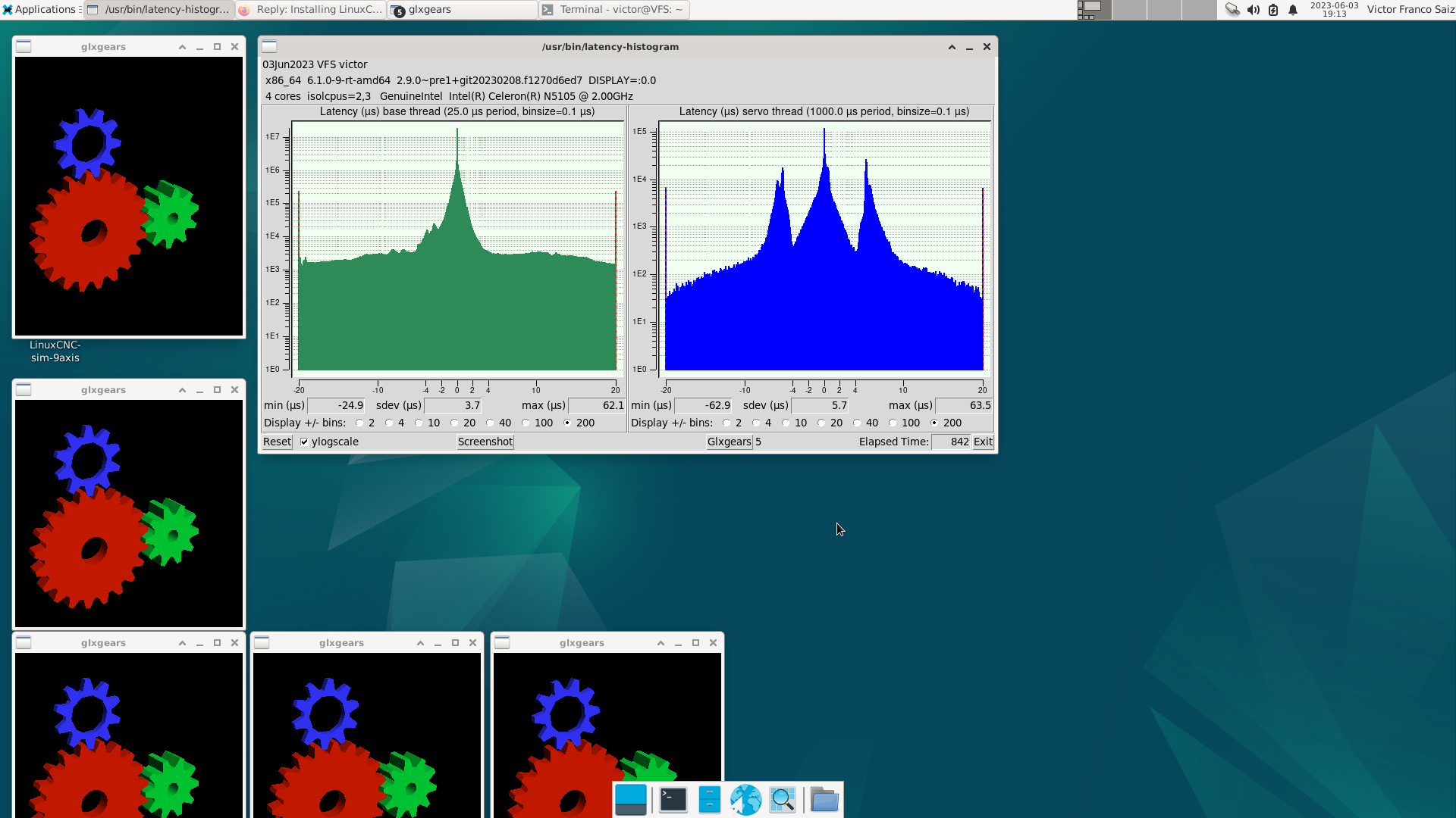

05 Mar 2023 08:05 #265900
by vitorfranx
Replied by vitorfranx on topic Installing LinuxCNC Beelink U59 Pro
Hi guys,
Massive progress yesterday.
I did a clean install of linux Bookworm. It had a lot of drivers missing and the sources.list file had the text badly written so I couldn't even install the packages I wanted.
Then I had to erase all the text and copy/paste the links from the debian wiki about sources.list files.
After that I used synapsis (I don't remember exactly how the software is called) and installed all the packages that contained all my missing drivers.
I also installed Linux CNC and followed the Ethercat guide to be able to control some drivers/inverters I have access to.
It's all working fine, I did a latecy test and showed: about 400.000 ns jitter in servo thread and 450.000 ns jitter in base thread.
From what I read in the forum this is really not great but it will allow me to test and verify the system.

05 Mar 2023 11:11 #265904
Replied by rodw on topic Installing LinuxCNC Beelink U59 Pro
400000 is not viable. But you say you had issues with sources.list. Bookworm has never had sources.list errors for me.
That makes me think you are getting something wrong.
But you are up and running, try settting isolcpus=2,3 using grub-customizer which is in the bookworm repos.
Then check that cstates =1 is set in your bios. (You can also do in grub but would need to research the values.)
The Celeron 5105 should have enough grunr to run linuxcnc if set up right.
If that still fails to get latency < 150000, disable/remove/uninstall your wifi card/driver.

03 Jun 2023 17:17 #272823
by vitorfranx
Hi guys, sorry for the ultra late response, I've used the new guide posted by Mr. Rodw and it's been waaay better. If I abuse a bit the system I get it to max base thread = 90us and max servo thread= 130us. I don't know if I'll change the PC or wait for another amazing update post from Mr. Rodw. Even with the latency I had before, it allowed me to learn a lot about linuxcnc, test some ethercat vfds and servo drives I borrowed from work.
