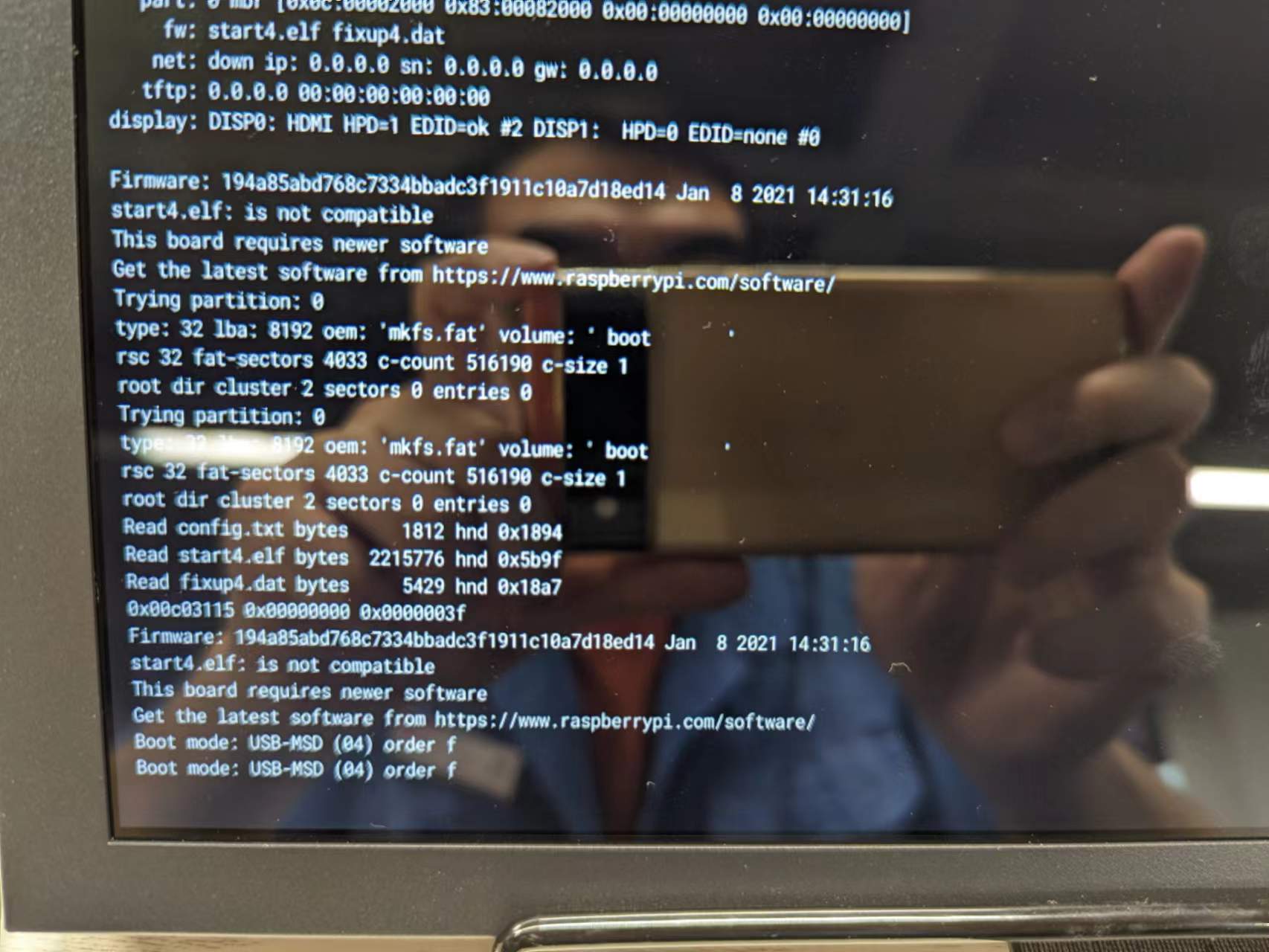

raspberry pi 4 B(RAM 4g and 8g) cant install linuxcnc was created by Rabin
I started to buy a Raspberry Pi 4b 8G version, and an error occurred in the error below when installing LINUXCNC at the boot stage. I saw in the official instructions that the 8G version may not be compatible with LINUXCNC, so I bought a 4G version. Now, the error in the error below still appears. I hope someone can help me.

Hi I spotted this myself
It's not an issue with the Pi being 8Gb, I have one myself
In the case of the Pi4 it has an eeprom on the board
The eeprom can be updated ether at the factory before it's shipped
or due to a new / current version of raspian running which has then updated the eeprom automatically
If the files within /boot; typically "start*", "fixup*", "bootcode.bin" are out of date (don't match the newer eeprom)
That's what causes the problem.
This wouldn't crop up with running a raspian image normally as the image is updated on a regular basis.
Although the main RPI4 image linked on the linuxcnc site is kinda out of date which causes the problem.
I did create a patched version of the image here with the fixed boot files
lfs.hecatron.com/linuxcnc/linuxcnc-2.8.1-pi4-fwpatched.7z
However it's still quite old and things will break as soon as you try and update any of it (due to it trying to update the kernel)
With that in mind it's probably better to use the links rodw has posted above instead

- Posts: 19904

Sorry, i have only scanned this thread, but at one point there was an issue with addressing more than 3GB memory with the realtime kernel. A workaround was to use raspi-config to configure to only 3GB.
I don't know if this is at all relevant to the problems reported.

When I looked at /boot/config.txt within that image I did noticeSo that should cover it.
It's an issue that's been fixed within later kernels I think (or at least I've not seen it on 6.3)
But the kernel version in that image is much older.
total_mem=3072It's an issue that's been fixed within later kernels I think (or at least I've not seen it on 6.3)
