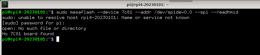

Today I tried readhmid, but the response is still “No 7C81 board found”

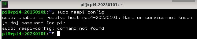

This did however not surprise me, as I have not enabled SPI manually, I didn’t succeed in that yet:
Google tells me I should do this via raspi-config, but that command is not found, although I updated and upgraded my install. Perhaps that is because I am not using Raspberry Pi OS?

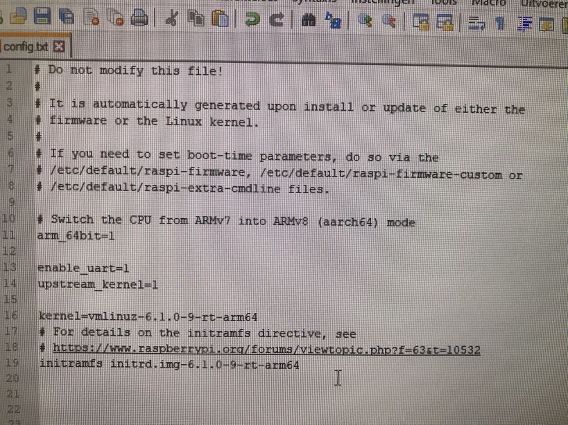

Next, instead of using raspi-config, I tried to change the setting manually in the file boot/config.txt.
On the RPi this file does not exist, so I put the SD card in my Windows machine and opened the file there.
But the config.txt file told me not to modify it, but go to another file instead.

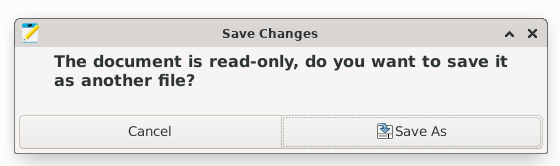

I tried to create a new textfile and save it as /etc/default/raspi-extra-cmdline, but this is not possible. I received the warning “The document is read-only, do you want to save it as another file?”.
So unfortunately I haven’t been able to enable SPI. Perhaps am I doing something wrong?

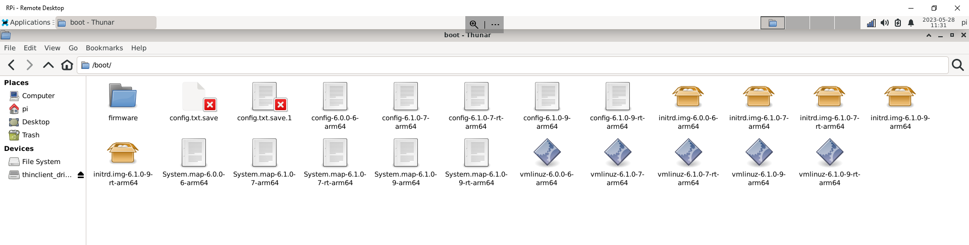

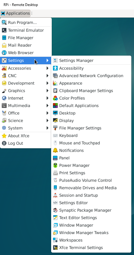

just do it with the GUI one in the start menu, its a check box thing.
Then reboot, and do the mesaflash before anything else

The problem you are having I think is that you need to edit files outside your home directory and you don't have edit rights. You need to be logged in as root to do that.
try
sudo apt install geany
sudo geany
Then edit the file you want to.
