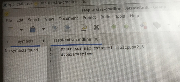

Today I did a completely new Debian install of the Bookworm daily built, following the document made by rodw:
github.com/rodw-au/linuxcnc/blob/rodw-ge...etting-linuxcnc.adoc
This detailed explanation was very helpful!
After this I manually installed both geany and mesaflash.
I then edited the file "raspi-extra-cmdline" by adding "dtparam=spi=on" (see screenshot below).
I was hoping that this fresh install would solve my problems, but unfortunately I still have the same error...

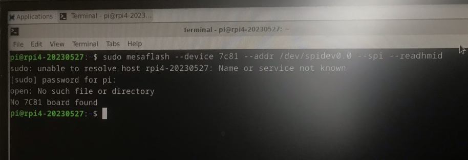

Although I am happy to hear that 7C81s are shipped with 5ABOBx3 firmware, maybe I don't need to do anything with mesaflesh.
But if I skip that step, how could I check the connection between the RPi and the 7C81?

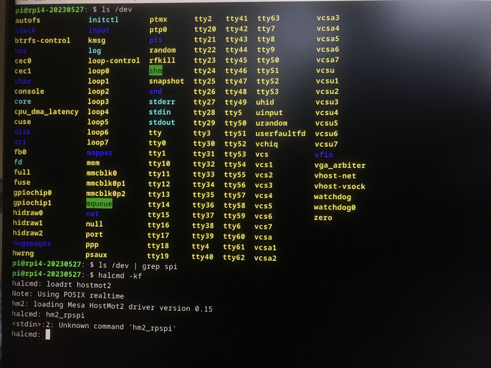

29 May 2023 18:11 - 29 May 2023 18:12 #272446
by Stef
Replied by Stef on topic RPi4 Mesa install: No 7C81 board found
Thank you for the quick reply!
Please find below a screenshot with the commands that I executed.
Did not show anything.
This showed "halcmd: "
I typed "loadrt hostmot2" behind that, which seems to give a valid output.
But when I typed "hm2_rpspi" behind the next "halcmd: " it didn't recognize this command.
ls /dev | grephalcmd -kfI typed "loadrt hostmot2" behind that, which seems to give a valid output.

- Posts: 18080
- Thank you received: 5316
29 May 2023 19:44 #272454
Replied by PCW on topic RPi4 Mesa install: No 7C81 board found
You left the loadrt out, it should be:
halcmd: loadrt hm2_rpspi

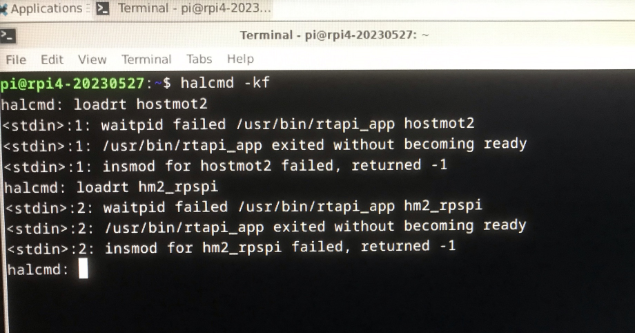

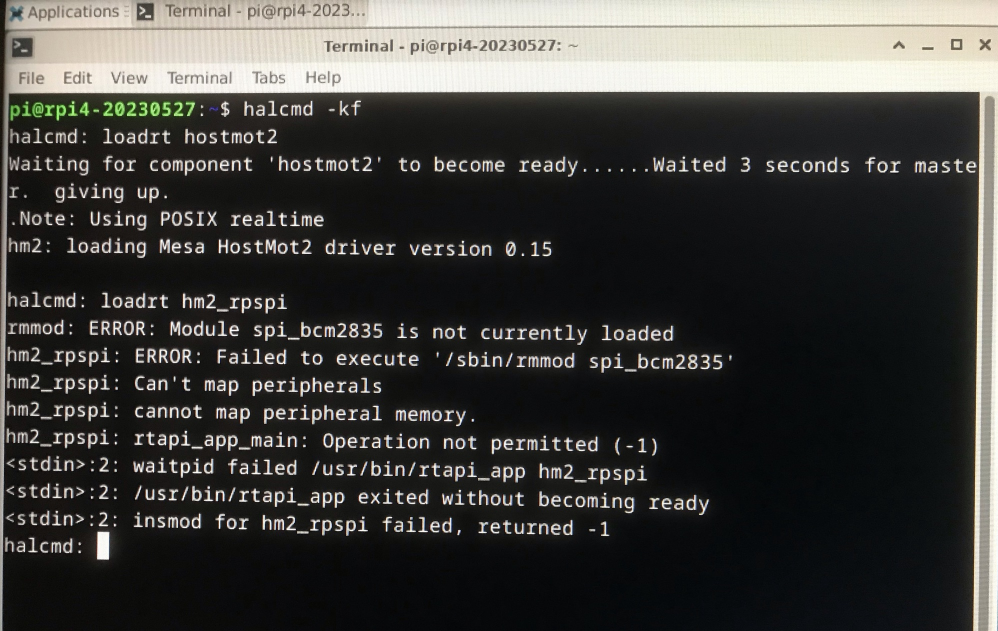

30 May 2023 14:50 #272499
by Stef
I did a new try, and after that another one (without rebooting in between), see below. I noticed that the output is different so I pasted both screenshots:
Ah, I see I made a mistake over there. However the output of the first and second command don't list anything related to spi, so I think that is already strange?You left the loadrt out, it should be:
- Posts: 18080
30 May 2023 15:12 #272500
OK so it does look like you cannot run hm2_rpspi on that kernel
(nor could you run mesaflash or the spidev driver since the spi device driver
is missing)
The "fail to rmmod" error would be simple to fix in the hm2_rpspi source
so it would work with debian systems but overall I look like debian is a lost cause
on the RPI because its missing so much peripheral support
