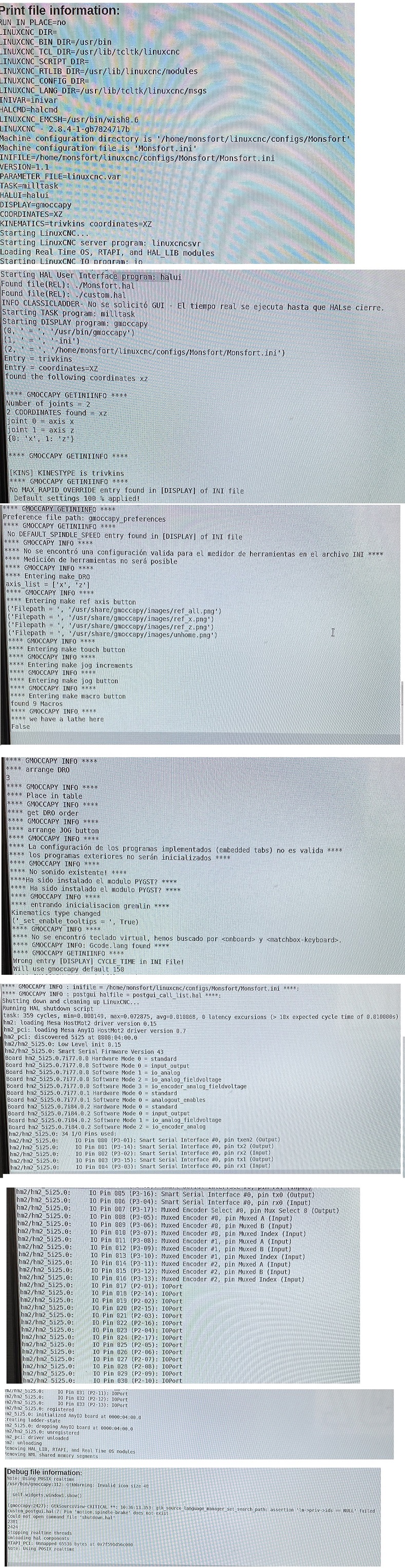

Hello guys, I have a lathe with linuxcnc 2.6 wich I need to upgrade to 2.9
Updating from 2.6 to 2.7 worked fine by following the instructions from the manual.
Updating 2.7 to 2.8 : I used the script which converts configuration files automatically , when launching for the first time suddendly I get an error log (attached please zoom the image).At this point I coudn`t figure out the cause.I wonder if you guys would be willing to help me with this issue.

Replied by tommylight on topic Problem Updating from 2.6 to 2.9
Edit the custom_postgui.hal with a text editor (not office stuff), omit or delete the line 7 that contains
motion.spindle-brake
ONLY if you are not actually using a spindle brake.

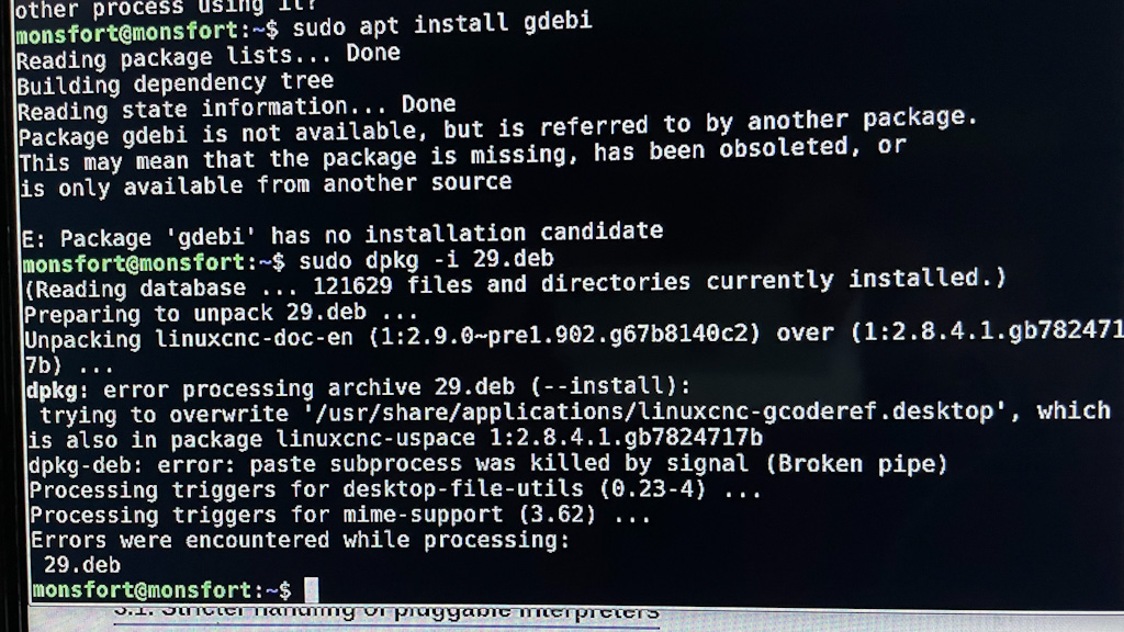

When trying to install lastest deb (2.9) I got some errors and it couldn't be updated (2.8.4 ==> 2.9). I couldn't install gdebi either so I used dpkg.
I made a new clean install but errors persist.
I couldn't figure out how to solve this. Need help

14 Jun 2023 23:26 #273559
sudo apt update
sudo apt install gdebi
then
uname -a
lsb_release -a
then
uname -a
lsb_release -a

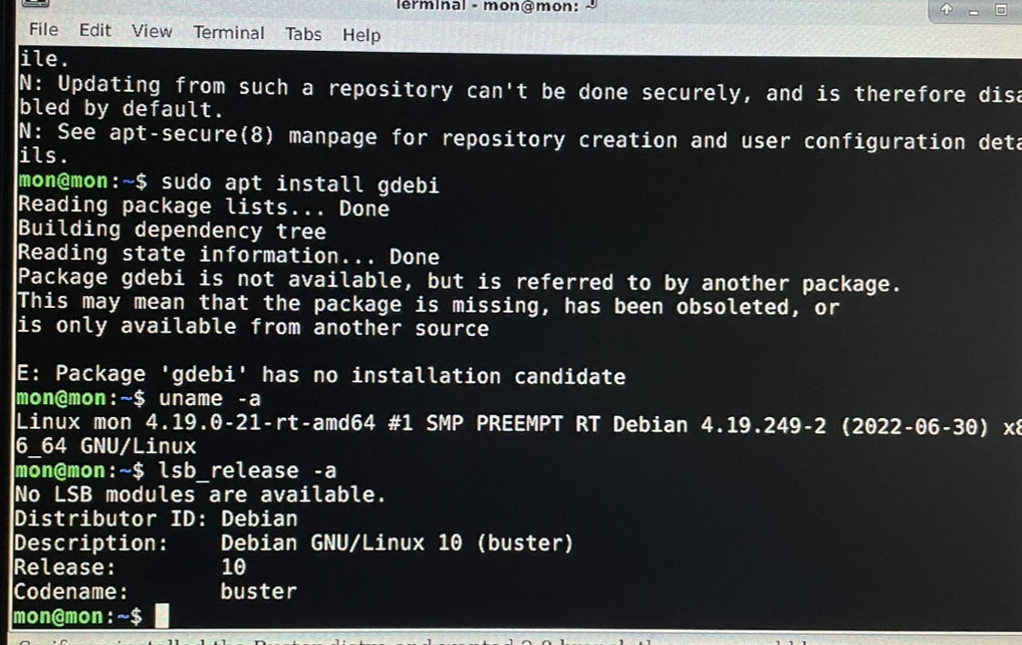

- kt600v
- Posts: 43
16 Jun 2023 23:37 #273725
by kt600v
Replied by kt600v on topic Problem Updating from 2.6 to 2.9
sudo apt update
then
uname -a
lsb_release -a
this is what i get
Something wrong with your repository file, what is the error from
sudo apt update
