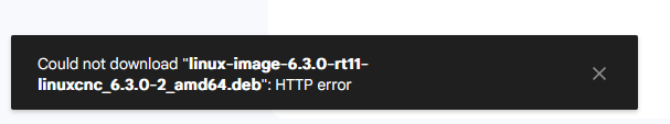

13 Sep 2023 19:19 #280685
by nwallace
Replied by nwallace on topic Installing Linuxcnc on Debian Bookworm
@rodw
Noticed that the download of the 6.3 rt kernel is no longer working from google drive. No matter what day, ip, device, browser or OS I try from I just get a timeout error when downloading the linux-image file. Luckily I had the file already on another device. I noticed this about a week ago and just tried again with the same errors.

- nwallace
- Posts: 71
- Thank you received: 10
14 Sep 2023 12:00 #280761
by nwallace
I could use the image but I figured you should know about any issues since this is linked in the official documentation of how to install LinuxCNC. Attached is what I get when I try to download that file from 2 different machines in Chrome and Firefox as well as from 3 different public IP's.
- Posts: 12172
- Thank you received: 4154
14 Sep 2023 15:47 - 14 Sep 2023 15:48 #280779
Replied by rodw on topic Installing Linuxcnc on Debian Bookworm
I suspect there are other factors at play with your connection to Google Drive.
IN the same folder, another document lists the commands to build it from scratch.
The 6.4 commands are untested.
