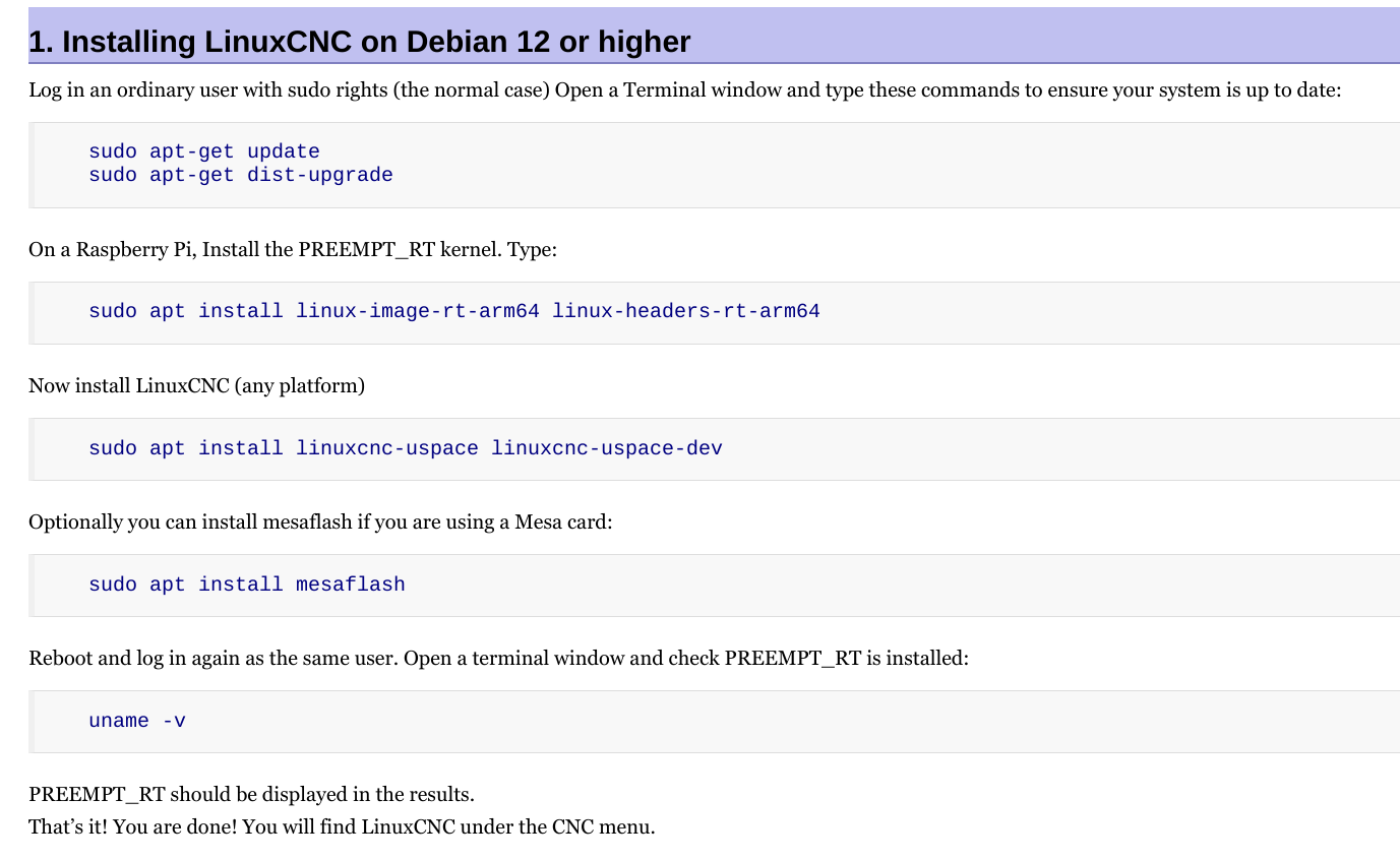

18 Sep 2023 06:25 #281045 by rodw
Replied by rodw on topic Installing Linuxcnc on Debian Bookworm
Can't get much simpler than this:
Unless you use my installer

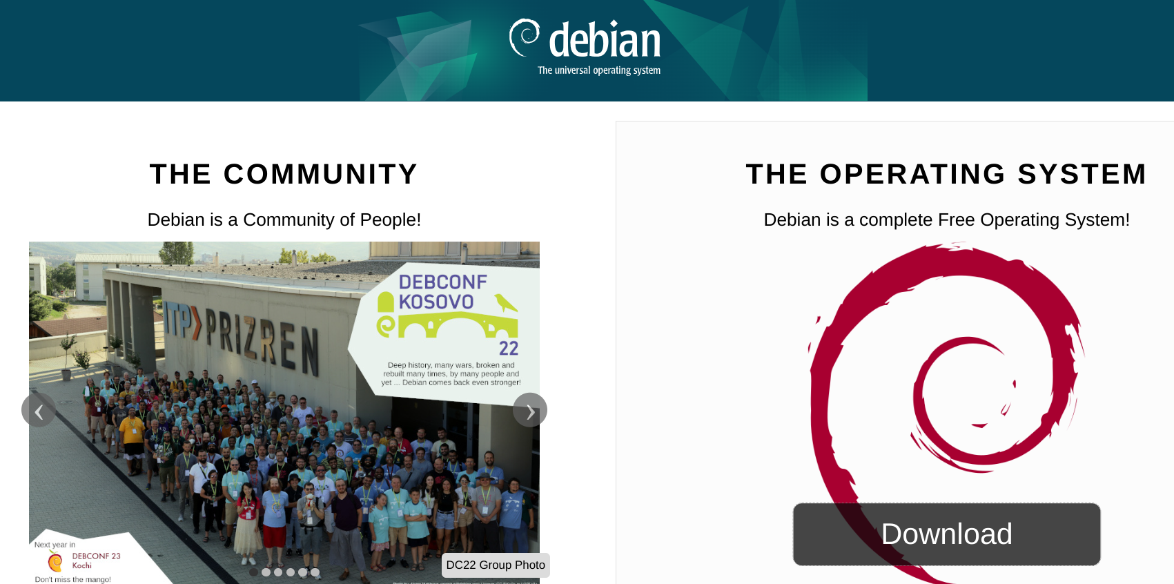

18 Sep 2023 06:31 #281046 by rodw
The best place to start with a copy of Debian 12 is to go to
www.debian.org/
and click on the download button. This gives you the same version as I recommend in the docs. We don't want links in forums to obscure installation.
