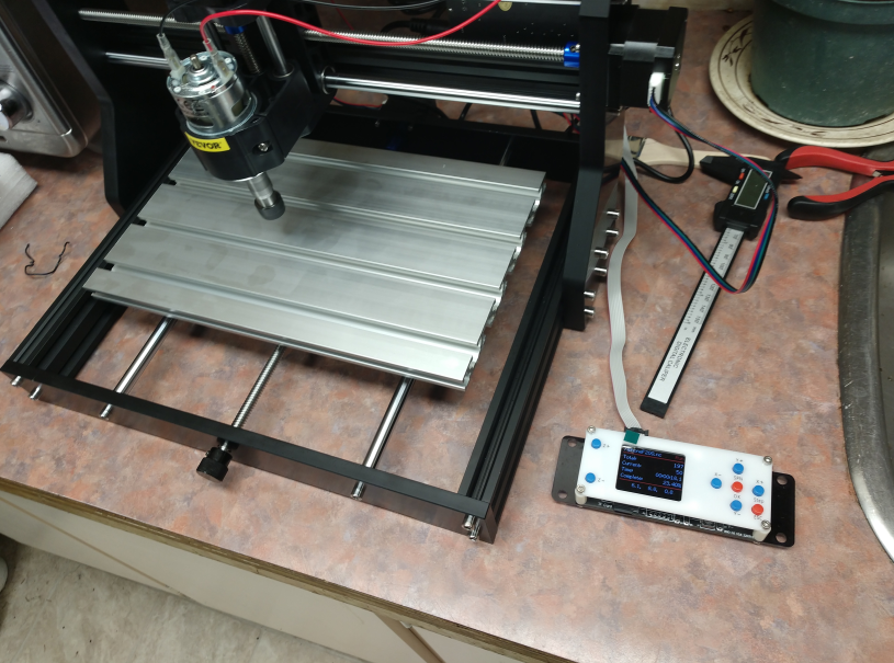

Yesterday I built a 3018pro kit and I was amazed when I made the spindle turn and move around.

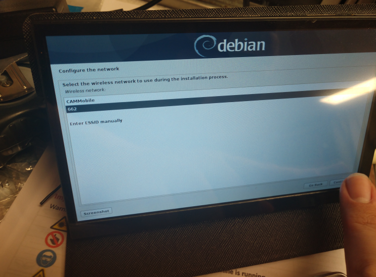

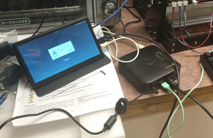

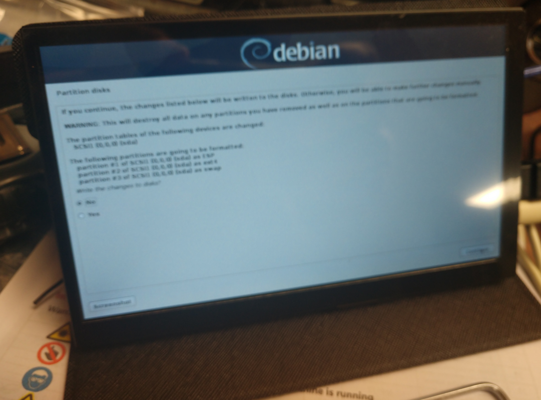

Got home, grabbed an obsolete chromebox and I have this cheap 5 inch touchscreen, hook that up, download the linuxcnc iso to a stick and boot that up
Here is what happenned nest !
(Oh BTW, I insert an image attachement here and it completely broke this comment's formatting into single non-stop block of text)
(Also BTW, image limit is still just 1.6MB so had to resize down everything) (please at least autoresize server side ?)

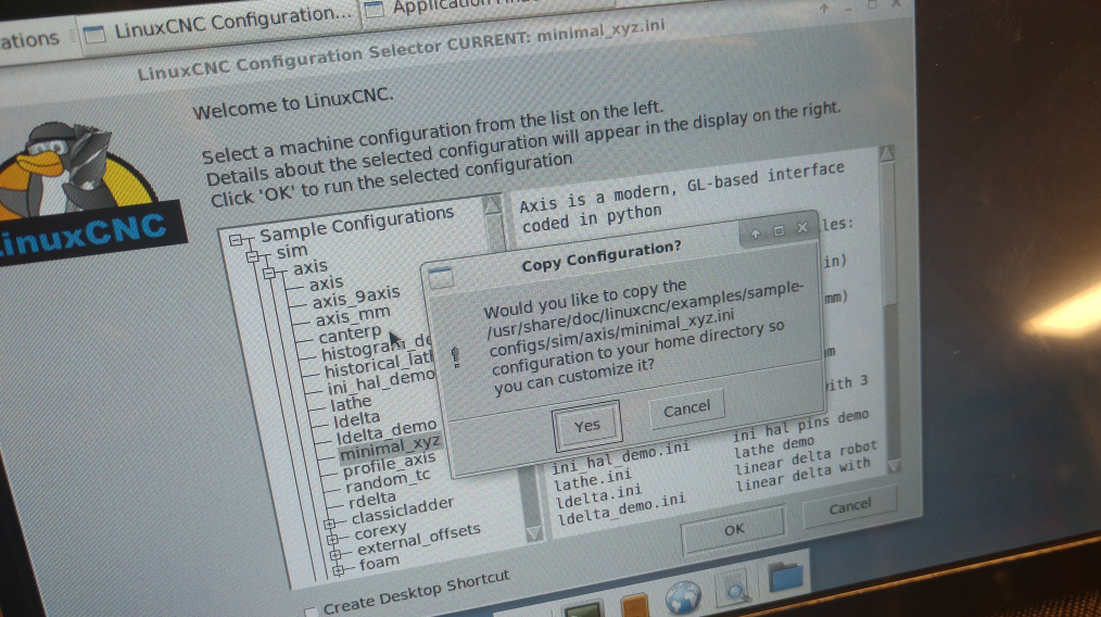

It's booting !
touchscreen works !
wifi works !
But can't find a way to pop up the onscreen keyboard for the touchscreen
debian quirkyness, it asks you to save the partition setup, you have to click yes
But you can also click continue ! and then it asks you again.
Maybe the button to continue should just be [YES OVERWRITE THE PARTITION] or something

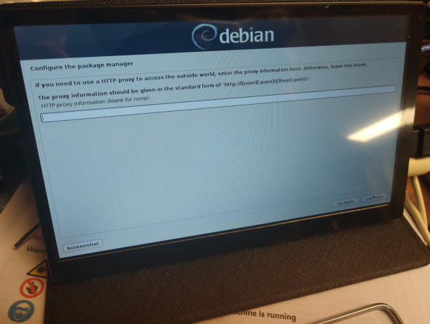

asking the user about proxies, when there's working internet, not sure that's necessary, fortunately you can just ignore and continue
booting !
that should auto-login by default imho

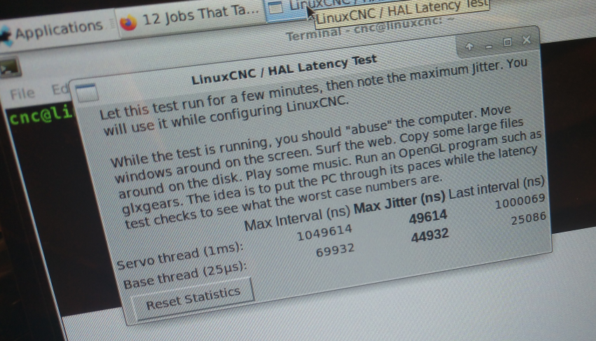

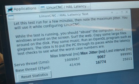

Tried out the latency thing
Here are the results
machine selection
hmm my board is something vigo
can't find it here
"minimal xyz" yeah, sounds about right
It's booting !

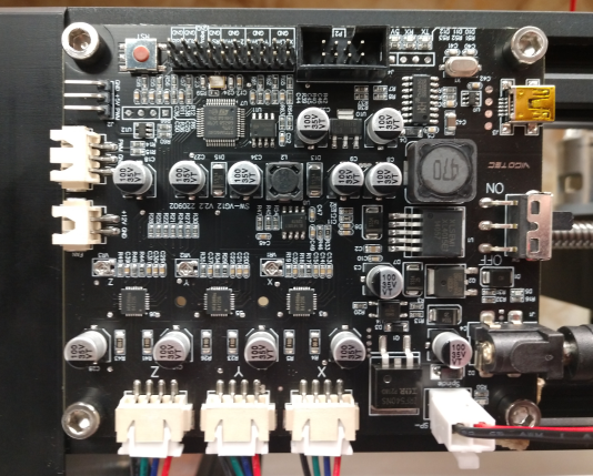

can't find it here

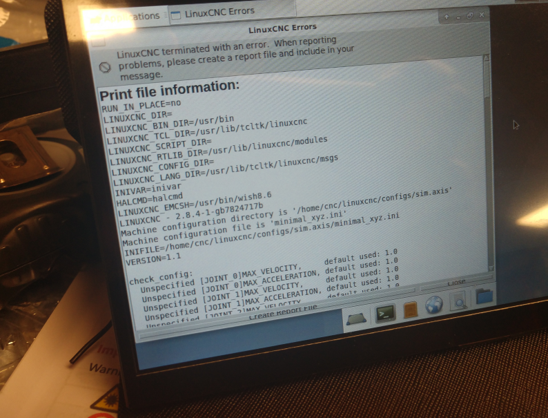

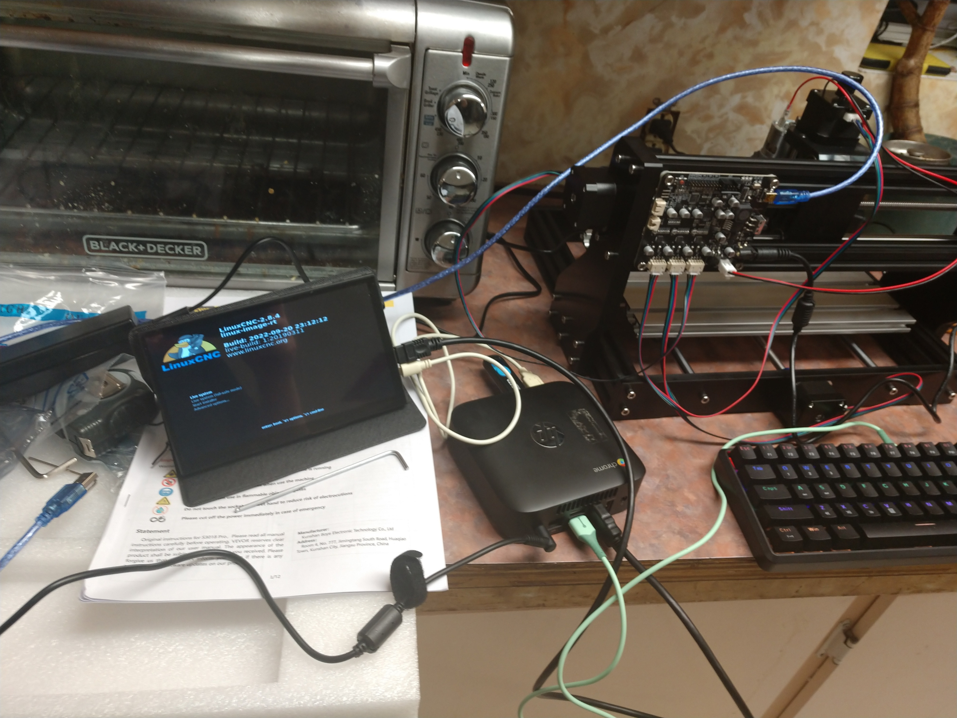

unfortunately it crashed on start

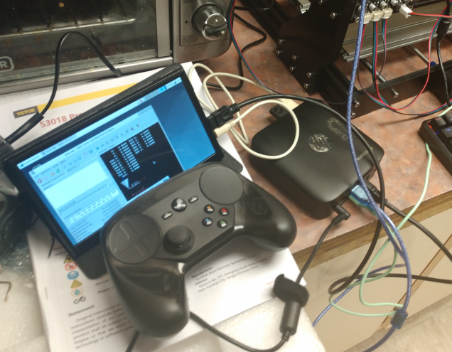

I hooked up the usb cable to the milling
the touchscreen is glitching out :\
I need an approriate pointing device
So I got the steam controller

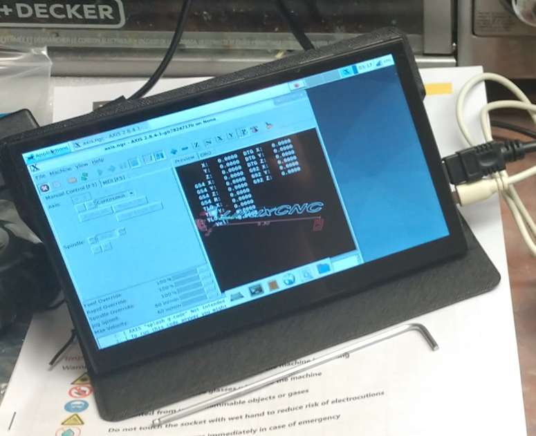

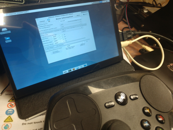

I was really really hoping that plugging that in, the X/Y/Z axis on the conroller would start moving the axes but sadly, nothing happened !
Then I realized the linuxcnc program wasn't able to full screen with only 1024x768 of resolution
So I increased the display resolution to 1280x1024

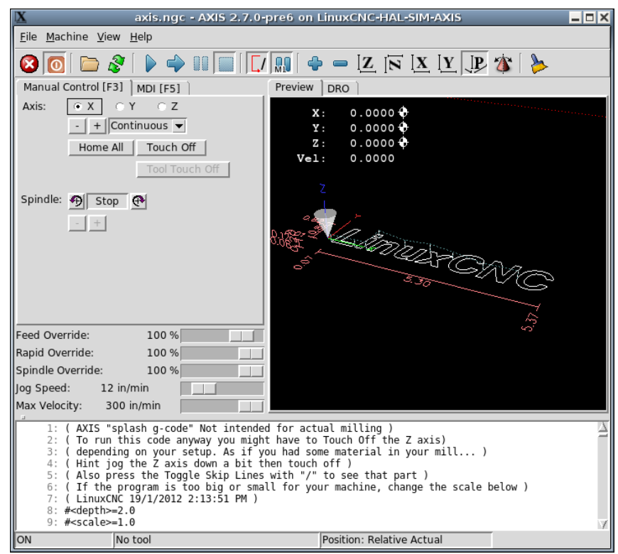

I tried the other programs

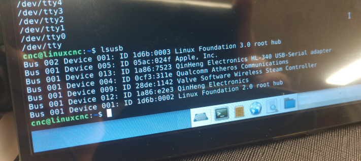

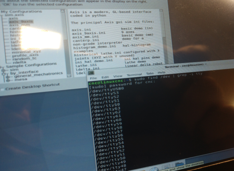

I checked out the USB devices
turns out it's the same company that makes the touchscreen as the stepper driver board !
the device name is /dev/ttyUSB0

Most probably uses GRBL so you can try one of several free GRBL controllers, bo idea what they are called.
LinuxCNC can do an astonishing amount of stuff, but it does not do control over USB due to latency issues and the fact that controlling a 15 ton machine is extremely time critical.
Klipper might be used after flashing the board, but to much trouble to remove a lot of 3D printery stuff from it.
I am sure someone here made LinuxCNC work with Arduino type boards over USB, search for user DaBit.
And there is Remora being developed exactly for running 3D printer boards with LinuxCNC, but over SPI or Ethernet.

you main board is not direct compatible with linuxcnc.
you can not use linuxcnc with USB-Boards

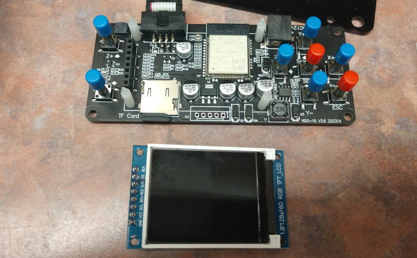

My board is apparently made by a chinese company called Vintech, the board is vigo-something, it's also used in laser cutters.
The pendant that comes with it that has an esp32 is called a "vigostick"

If you are using a USB board, the Gcode motion controller is on the board so you can send it a file to be run
With Linuxcnc, the motion controller is on the PC. You don't send it a file, instead you open the file and Linuxcnc interprets it and directly controls the motors.
Because Linuxcnc is THE MOTION CONTROLLER it must run in real time (using the PREEMPT_RT patched kernel.)
Nothing over USB is possible to be done in real time due to the underlying protocols so your existing controller is useless (you don't need two motion controllers).
Your computer needs either a Ethernet port or a parallel port to interface to your motors so likely your Chromebook has neither.
