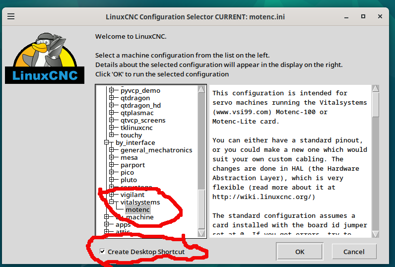

- southbayguy
- Posts: 47
14 Aug 2023 21:55 #278021
by southbayguy
Replied by southbayguy on topic Difficulty building RTAI linuxcnc from source
Thank you.
I still don't understand what I need to do to make my home-built version of linuxcnc go to
/home/robert/linuxcnc-dev/configs/by_interface/vitalsystems/motenc.ini.
for its configuration values.
- Posts: 12174
- Thank you received: 4155
14 Aug 2023 22:12 #278024
You don't! You make a copy in /home/robert/linuxcnc/configs by selecting these options.
Then it will appear under the chooser under My configurations.
Then you edit the configuration you have created in /home/robert/linuxcnc/configs
IF you look at the chooser, it says Sample Configurtations at the top of the Vital tree, They are not designed to be edited in situ.
Replied by rodw on topic Difficulty building RTAI linuxcnc from source
Thank you.
