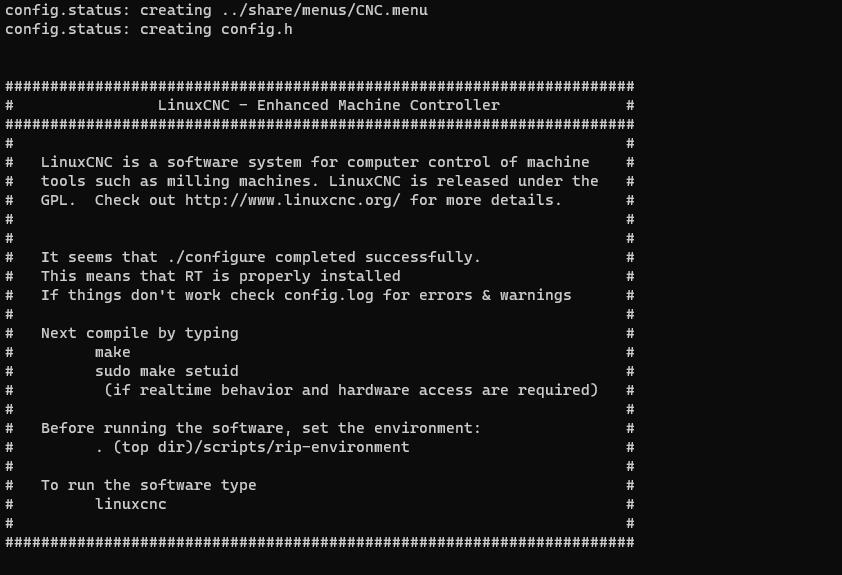

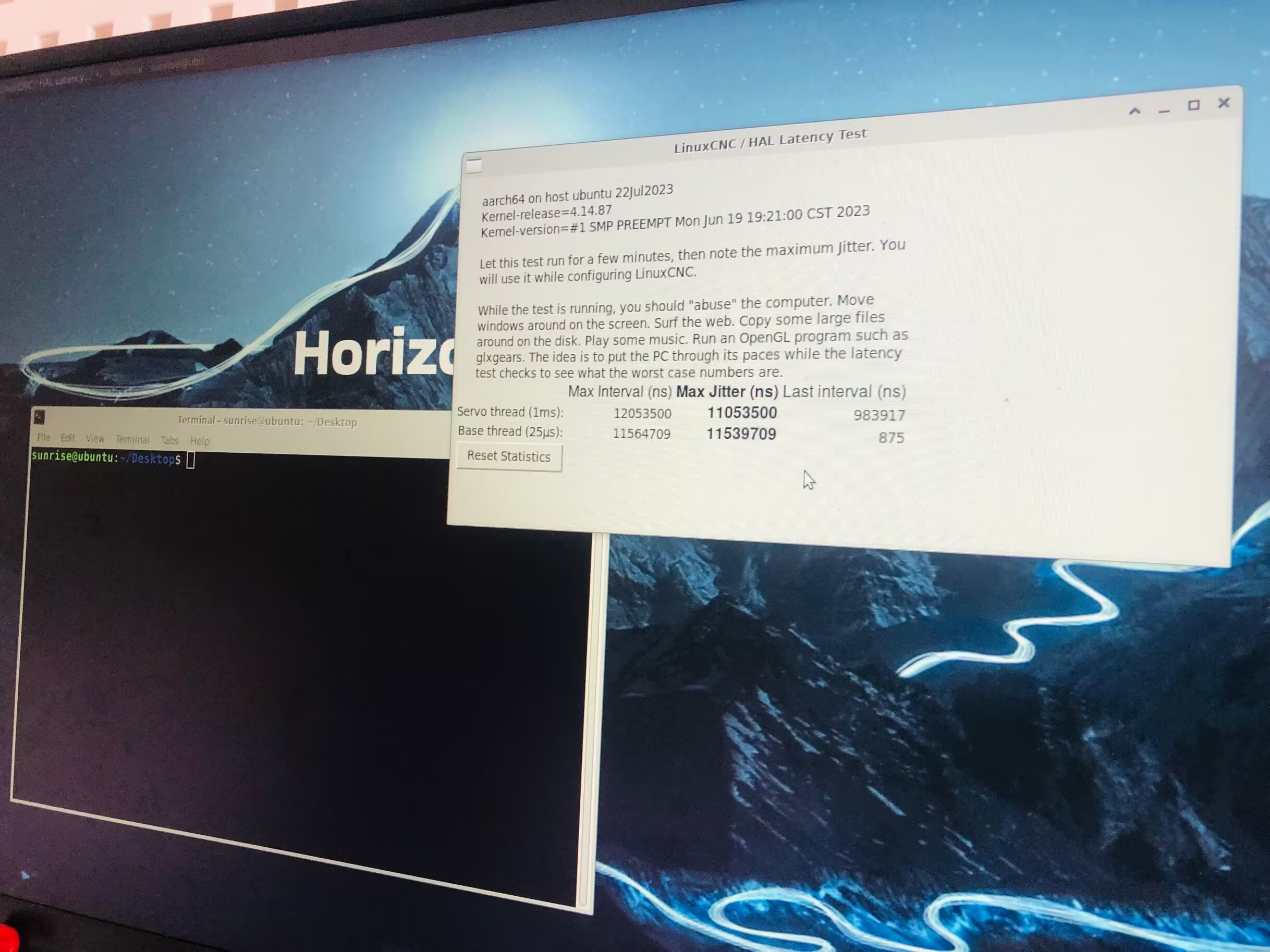

I'm trying to install LinuxCNC on Ubuntu 20.04 arm64, and everything went smoothly with compiling from the source code. However, I'm currently stuck at the real-time kernel part. I hope to receive your help and guidance on this matter.

Everything went smoothly with compiling from the source code.
The real-time performance is very poor.
How should I proceed?

Wrong kernel, not a fully preemptible one.
Is there any reason for not using Debian BookWorm?
Installing LinuxCNC on BookWorm is as simple as
sudo apt install linuxcnc-uspace

Ubuntu requires a subscription for the RT kernel. Please use Debian Bookworm per these instructions
linuxcnc.org/docs/2.9/html/getting-start...etting-linuxcnc.html
Compiling from source is not required.

Please advise what your hardware is. As Tommy observed, it does not appear to be a pi which show up as ARM64..
The kernel you have used seems to be very old.
