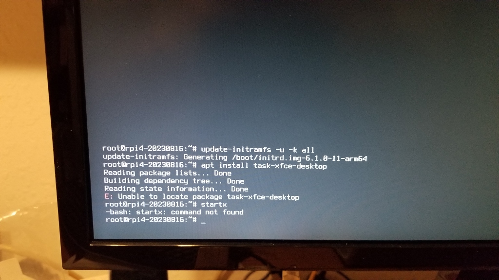

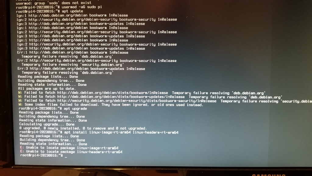

The following is on Rpi4B-4GB. (the aforementioned fail was on both 8GB and 4GB Pis. )
As you suggested.
(Beginning with linuxcnc.org/docs/2.9/html section 3 “install Debian Bookworm on a Raspberry Pi)
Downloaded the Debain 12 bookworm compressed file titled rasp-4-bookworm.img.xz.
Used imager on freshly reformatted SD to burn zipped bookworm Ssuccessfully.
Here are some oddities that happened en route.....
After “apt update” .... 4 warnings.. see attached
After “apt upgrade” .... 2 error reports:
and later
E: Unable to locate package task-xfce-desktop
and finally... startx command not found
so after my first Linux lesson, I rebooted and it came up:
Debian GNU/Linux 12-.....and I logged in
It gave me a few gripes I think can be ignored: “ journal out of date...., Journal header limits reached....
So have we got a foundation here or a mess?
Corrections, redo, or continue to sections 5, 1 and 7.
I have been using LinuxCNC for 10 years and the old console gave up on me. Really hope this gets me back to the machine.
Tnx for sharing your knowledge. This stuff's hard.
adding....
seems to be the show stopper. I never got the mentioned request for input (kbd layout/lang). and did not boot to a gui.
Can you point to the missing element such that I could still load it?

18 Aug 2023 08:15 #278333
Replied by rodw on topic Installation failures using normal install and imager-1.7.5
can you try And select xfce there or another alternative.
It is odd because we tested the method shown in the docs after Bookworm was released.
sudo apt install tasksel
sudo taskselIt is odd because we tested the method shown in the docs after Bookworm was released.
- Posts: 21922
- Thank you received: 7468
18 Aug 2023 11:13 #278348
Replied by tommylight on topic Installation failures using normal install and imager-1.7.5
No internet connection or network not configured.
Can not update, so nothing will install .
It clearly says "can not connect to debian servers" or similar.
