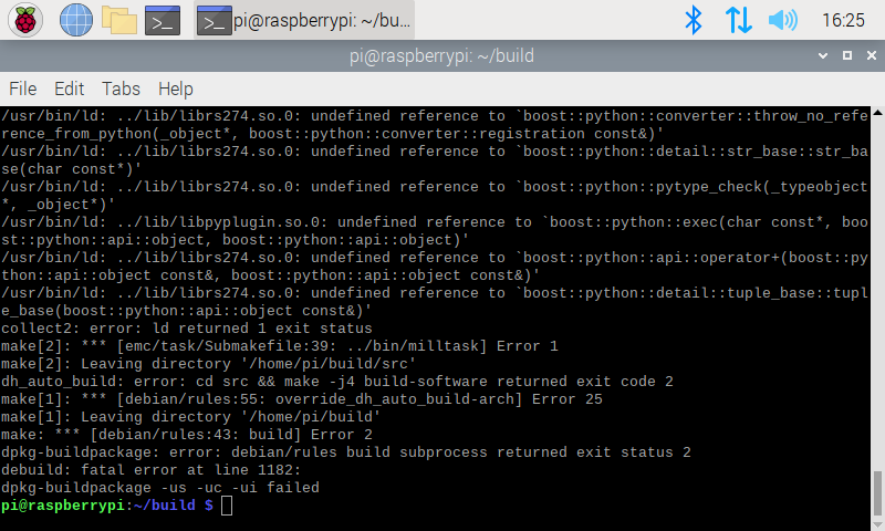

I followed instructions "Installing LinuxCNC 2.9 on Debian 11" successfully upto debuild -uc -us. The attachment shows the failure around "line 1182". Had that check been OK , the next three files to be installed with Gedbi, were not in build directory or anywhere I could find. There were some "uspace files" but name was incorrect.
The DEB file didn't show itself above the build file. There was debian file but not a DEB.
Question is:
X32 or X64 software?
2.8 or 2.9 LinuxCNC?
This was the most sucessful tease I have had in a year or more trying to install LinuxCNC.
Thanks for your review.

Replied by rodw on topic Debian 11 with X32 or X64 software from RaspberryPi imager?
At a guess, you are missing a dependency: libboost-python-dev
But the reason why I built the image Cornholio has linked to was there are too many dead ends like you are experincing.
So I built an image builder based on best practice that includes Linuxcnc build from source that runs on a PC not a Pi.
The download is only a week or so old so its current.
The builder is here github.com/rodw-au/rpi-img-builder-lcnc/tree/linuxcnc
