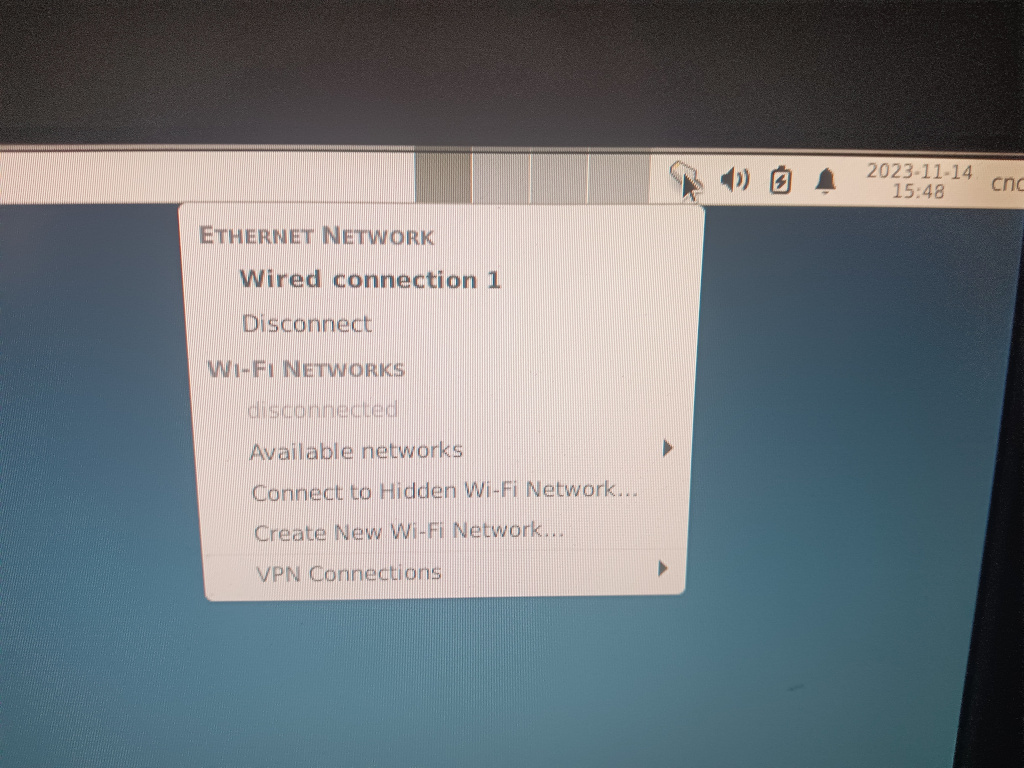

I went back and re-imaged just to check if I missed something. There was no network setting menu nor applet when I first booted up ... although my wired connection was configured via DHCP correctly by NetworkManager when I plugged it in.
I checked that the applet was not hidden / not running by default. I also looked in all dropdown menu settings but there just wasn't any way to configure network other than nmtui or menu-config which work, but were not that discoverable.
Which standard network manager option are you referencing?

That was where I was expecting it ... it wasn't there.
Do you know what app is responsible for that icon in the status tray on XFCE? nm-applet wasn't installed and I couldn't determine which XFCE package provides it.

I think the official image missed including a NetworkManager status tray applet. There seems to be several options but, contrary to the name,
network-manager-gnome
seems to list specific compatibility with XFCE and may well be the one that XFCE uses natively and doesn't drag the whole Gnome desktop over with it (see dependencies in the link above).

wifi can be set up using sudo menu-config.
If someone can confirm a working network manager that does not break things, I can look at adding it as some changes are needed.
I did not install the whole xfce4 environment out of kindness to the Pi's resources.
My version needed a bit of hacking to get it working for Andy and 2.9.1 and more changes are required now he has developed an install script for linuxcnc from the linuxcnc repo files.

I think the missing network manager is in the way xfce is installed. I'll have to check but when I've been building my images I use a "more complete" install of xfce. I'll be able to get back later this Arvo after I've done a few odds & bobs.

Yeah I thought it was this
task-xfce-desktop

I used the meta package packages.debian.org/bookworm/xfce4
task-xfce-desktop is used by tasksel during a normal debian installation (which is not available for the pi). I think it adds some bloatware we don't need.....Does it install open office? Thats bloatware to me.

Anyways right clicking on the applet identifies it as “NetworkManager Applet” version 1.30.0
