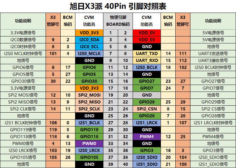

I temporarily resolved this issue, which was caused by a configuration file error. Now, I'm facing a new problem with my development board, which has an interface similar to the Raspberry Pi's 40-pin GPIO header. I noticed the Orange Pi project from allwincnc, where they use ARISC drivers to control the 40-pin GPIO pins. However, I couldn't find any relevant usage documentation in the LinuxCNC documentation. Could you provide me with some guidance?Here is the definition of the 40-pin interface on my development board:
