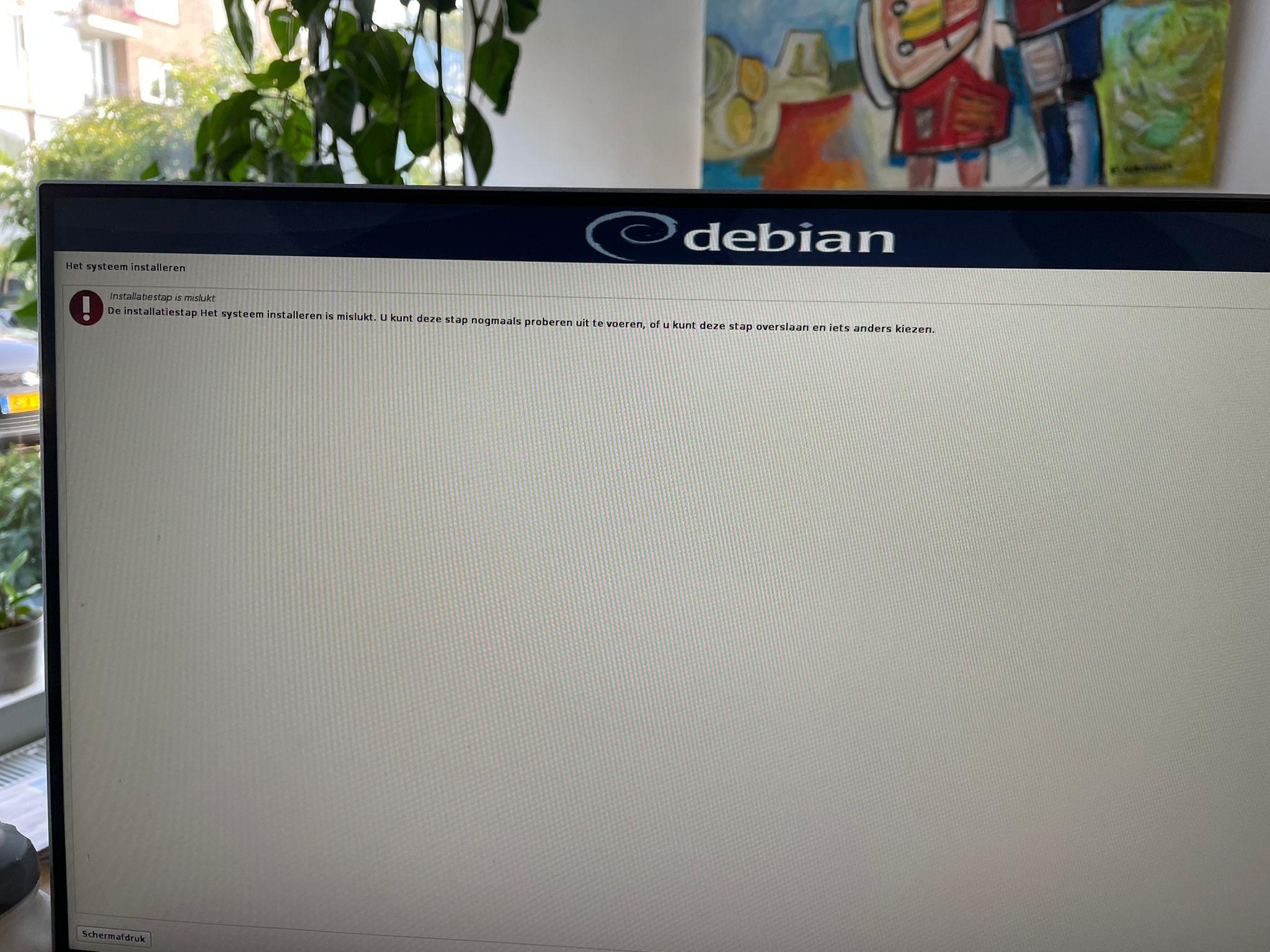

Hello All,
i am trying to instal Linuxcnc from USB iso
last Download form 6-10 15.30
I Get a Erro wen the system wants to install
Installation step Failed
thats after the Installer wants to Coppy Data to the disk
IS a New PC prodesk 600 G2 Intel I3 Core
have has a sugestion for me?

What is the exact error?

this was de message in the screen

Replied by tommylight on topic inslaling ISO Linuxcnc 2.8.4
Was this at the end of installation?
If yes, disable "secure boot" in the PC's BIOS settings.

Replied by CNCGOOS on topic inslaling ISO Linuxcnc 2.8.4
this was just (30 sec ) after starting installation.
before these step i have te chose about the disks
i have tryed it with secure boot disabled en legacy on. same problem.
is refus a good tool to make the iso on a SD card .
or do i use only usb stiks in stead of usb sd card reader?

Replied by rodw on topic inslaling ISO Linuxcnc 2.8.4
Linuxcnc 2.9 is days from being released on Debian 12 Bookworm. Likely over this weekend.
Bookworm has much better support for Secure boot/UEFI
Please try my prerelease installer. It will probably solve your problem.
www.forum.linuxcnc.org/9-installing-linu...xcnc-x86-only#278427
Once you do a sudo apt upgrade, Linuxcnc will be right up to date as the last remaining issue has been resolved.
Thanks for the advies
instalation went oke after i canhed from sd card to USB Stick.
