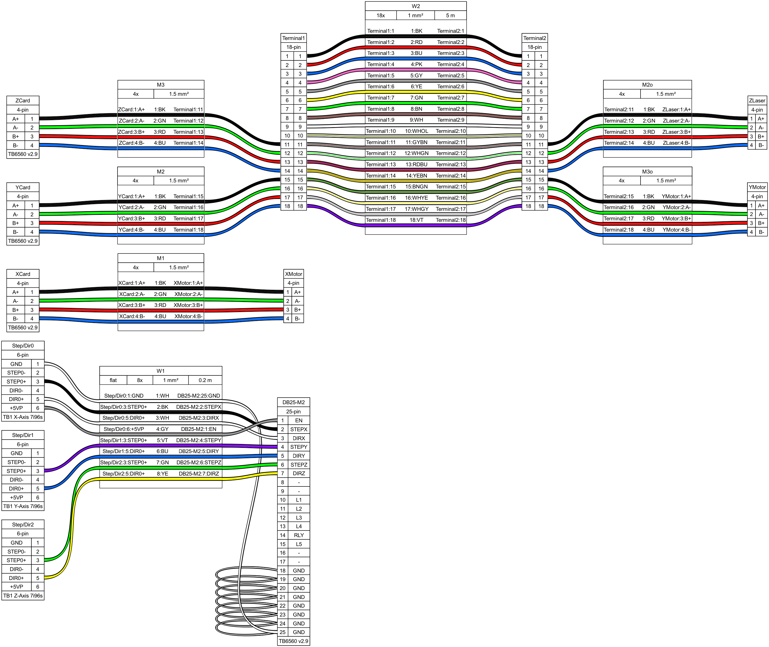

I retrofitted a 3-axis mill that ran with an Arduino with grbl. It worked before I started.
I have a 7i96s, a TB6560 driver card, 3 NEMA17 stepper motors and no other sensors. Controlled by an repurposed iMac with Bookworm and LinuxCNC v2.9
The problem is, that I can measure voltage between A+, A- & B+, B- but the motors do not turn. They don't even beep.
Hal file is attached as well as the wiring (I've corrected the 5V supply line. The fault was in the schema).

7I96S 5VP should not be connected to the TB6560
(the drawing shows 5VP shorted to DIR0+)

Sorry, my fault. Schema was wrong, wiring is right.7I96S 5VP should not be connected to the TB6560

The parallel port, multi TB6560 module has no DIR- or STEP- inputs
It is still wrong, the drive inputs are not wired at all on one side.
You have step and dir pins wired to DB25 on the +step and +dir, but there is nothing to -step and -dir, those should be tied to GND.

As PCW already noted, that board doesn't have STEP- or DIR-. Or do you mean I have to ground it on the Mesa card?You have step and dir pins wired to DB25 on the +step and +dir, but there is nothing to -step and -dir, those should be tied to GND.
