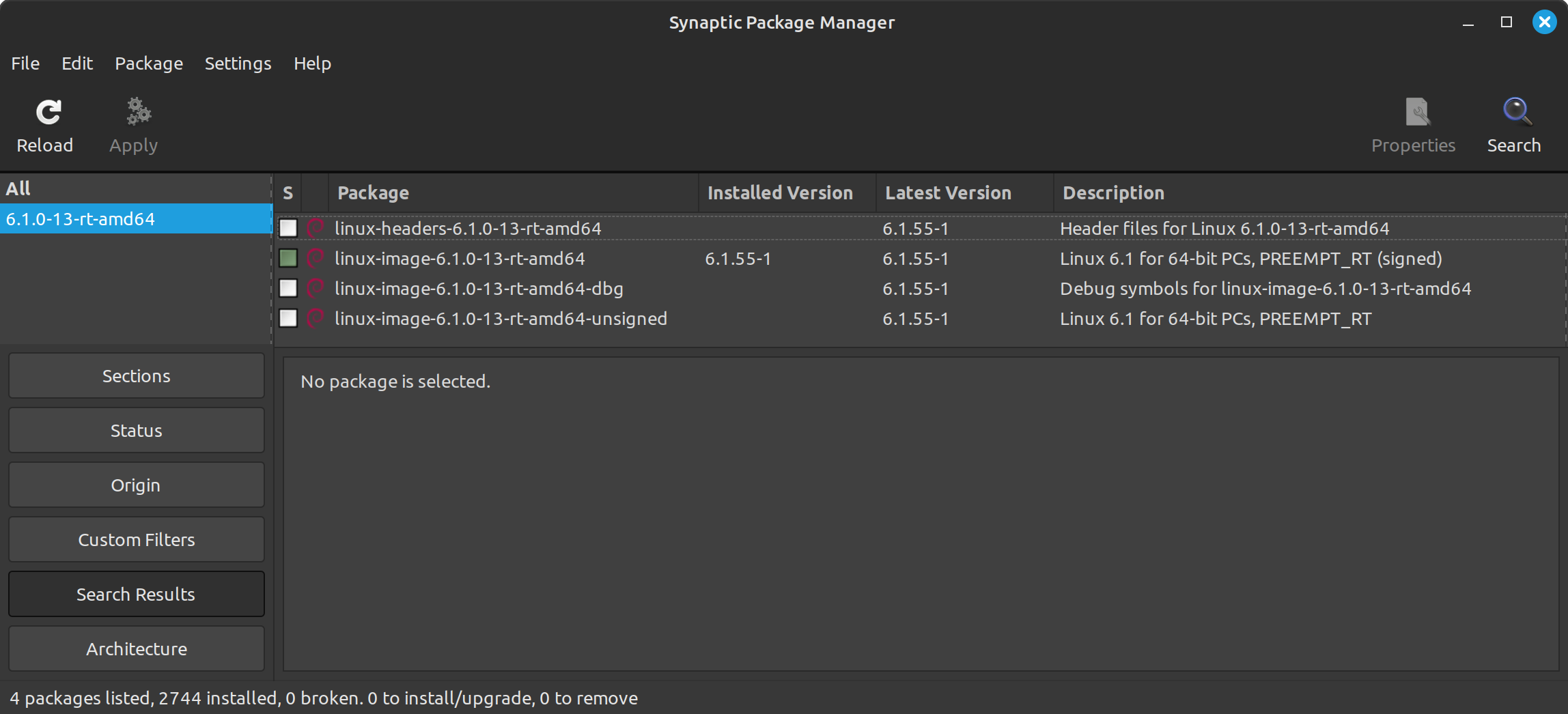

thanks,
but which 6.1 kernel exactly?
using Synaptic, it's easy to find the rt kernels, especially with a long list of repositories.

Replied by tommylight on topic best realtime kernel for Master branch on Bookworm
cnc@NR200P:~$ uname -a
Linux NR200P 6.1.0-13-rt-amd64 #1 SMP PREEMPT_RT Debian 6.1.55-1 (2023-09-29) x86_64 GNU/Linux
The following user(s) said Thank You: Roguish

by Roguish
Replied by Roguish on topic best realtime kernel for Master branch on Bookworm
thanks again.
and that one works OK ????
On all systems i have, it is better than 4.09 and 4.19, except on one laptop, so yes it is OK.

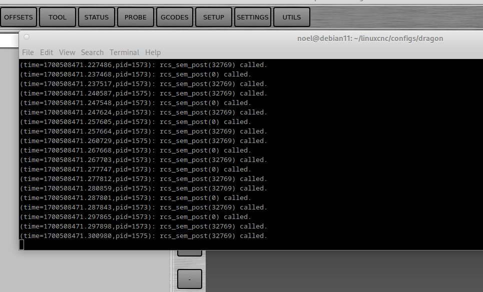

OH boy. new problem, I think, with 2.10...
Ok, I uninstalled the 2.9 that I had, downloaded the latest 2.10 debs from buildbot2, and installed them.
Since I'm using qtdragon, a little customized, I copied files around for it. easy, I have a script file.....
Started up linxcnc and everything sort of looks ok, except there is a constant stream of messages in the command window (I usually start up in a command window)
see the picture attached.
does this wether I use my old 4.19rt kernel, or the newer 6.1rt kernel....
to get past this I have gone back to 2.9.1 and all is ok.
but seems like a problem in 2.10.... So, whaz up????
Andy or Seb ????
