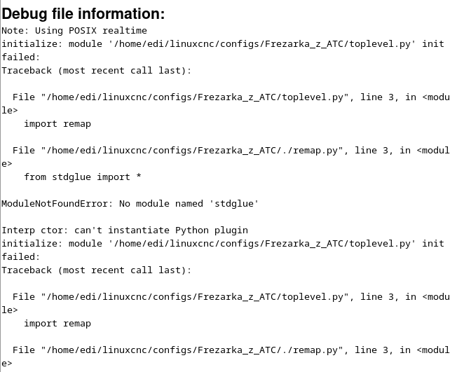

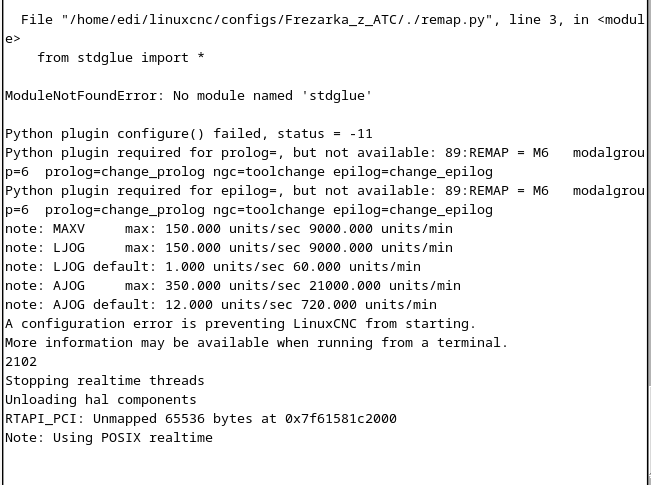

I install linuxcnc 2.9.1 version.
Maked new pncconf mill config with the same name like in 2.8.4 version and copy all files from my 2.8.4 config to 2.9.1 but when start get some error.
15 Nov 2023 06:31 #285494 by tommylight
Replied by tommylight on topic linuxcnc 2.9.1 problem
Probably looking for those at the wrong folder, edit the ini file to point to the correct folder.

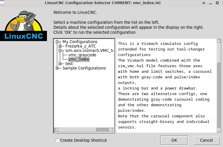

After fresh install we don have  folder /home/.../linuxcnc/nc_files/remap_lib/python-stdglueMust make new configuration Vismach simulator config and stdglue appeared.Now working.Thanks
