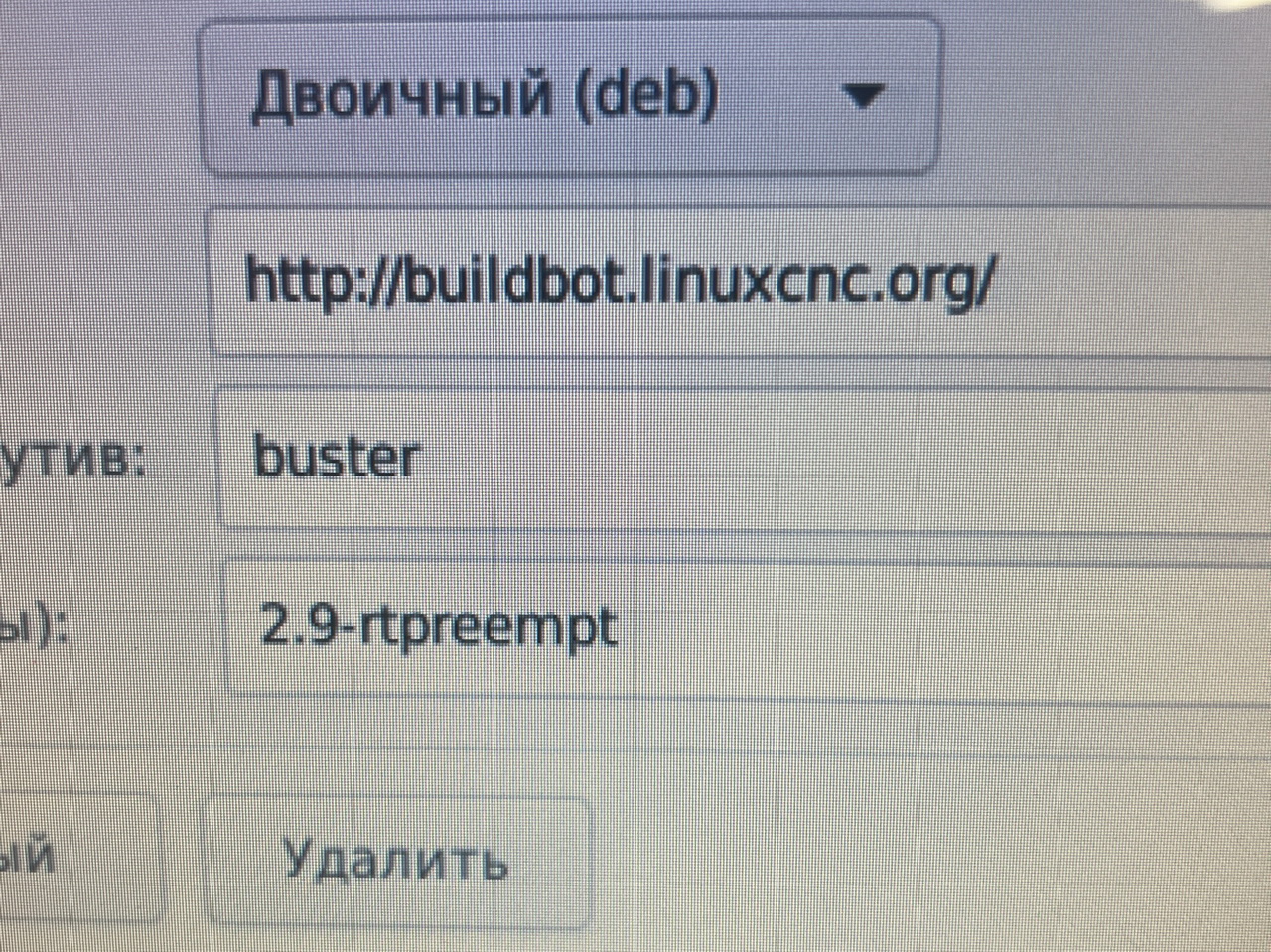

Hello,
From which repos can you get updates 2.9-uspace for Bookworm type 2.9.1.xxx before the official releases are released?
or does not exist for Bookworm?

19 Nov 2023 23:03 #285990
Replied by rodw on topic updates 2.9 Bookworm
It has been released. Get it from the linuxcnc downloads page.

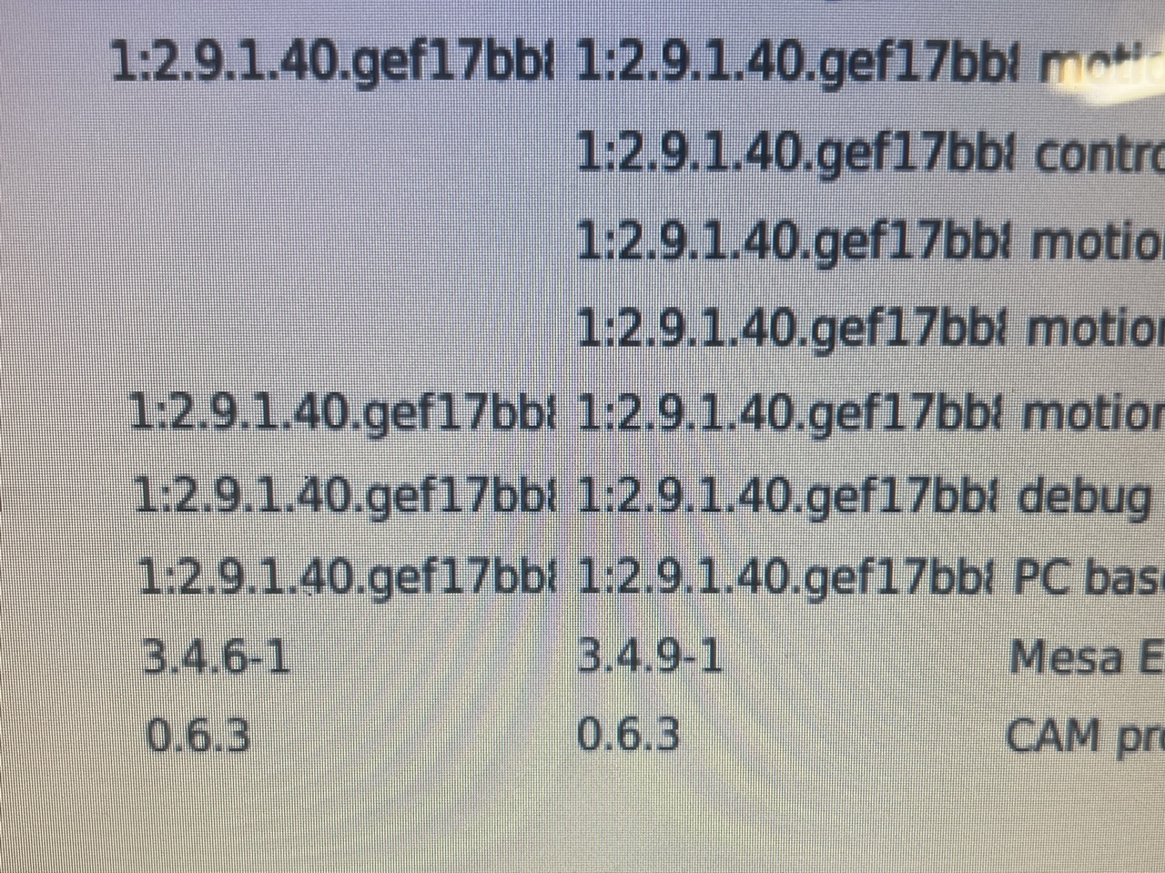

20 Nov 2023 17:00 #286109
by Serg452
Replied by Serg452 on topic updates 2.9 Bookworm
thanks, but I see in the repo clean 2.9.1

20 Nov 2023 17:08 #286111
Good luck using 2.9.1 on buster. I would recommend upgrading to bookworm using the ISO on th edownloads page.
I have not used Buster for 3 or so years...

20 Nov 2023 17:56 #286118
by Serg452
now I have a buster on one machine, on another bookworm. latency 2 times in favor of the buster. Motherboards and the rest are the same. dealing with settings...
