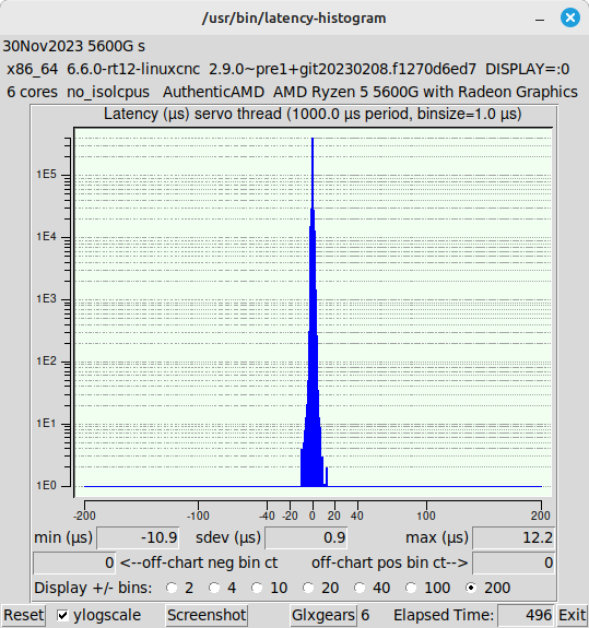

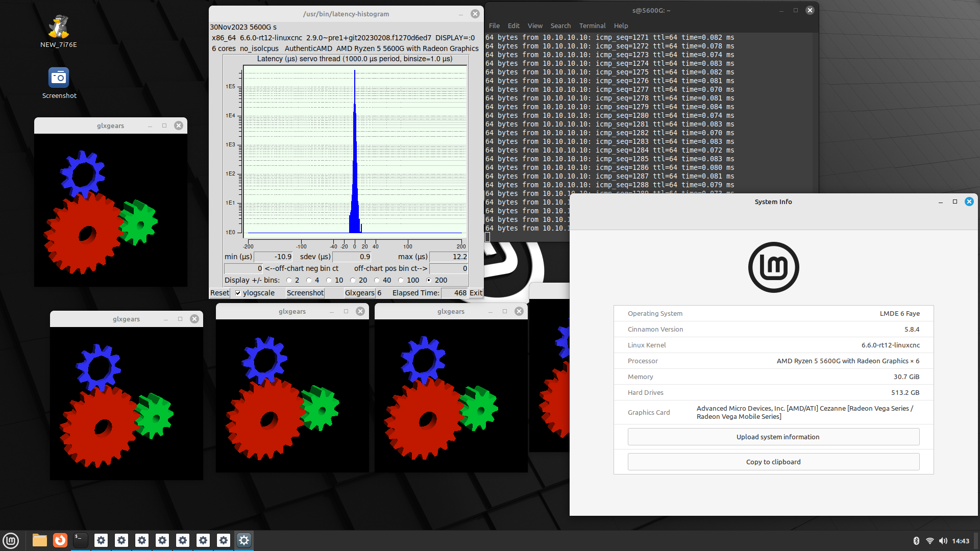

30 Nov 2023 21:00 - 01 Dec 2023 04:16 #286905 by scotth
Replied by scotth on topic Installing on Mint 20.3
Running LMDE 6 Faye with 6.6.0-rt12 kernel.
For new Kernel search 6.6 in forum.
Link                                          drive.google.com/drive/folders/1HceAcPQd...u4zS9?usp=drive_link
Debian 12 with this patch appears to be a bit more stable.

02 Dec 2023 15:56 #287028 by Craig E
Replied by Craig E on topic Installing on Mint 20.3
Thanks again for your support that worked brilliantly and seems to be more stable than Debian with 2.8

02 Dec 2023 18:13 #287039 by tommylight
Replied by tommylight on topic Installing on Mint 20.3
Well it is Debian underneath, so still has issues like bluetooth stopped working after a month, but is much better than actual Debian.
