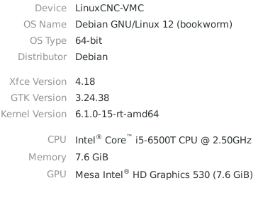

14 Dec 2023 02:44 #288116
by stefan63
How do I go from 2.9.0 dev to 2.9.1 stable? was created by stefan63

Easiest way would be to install the ISO on the downloads page

Thank you guys, I found this thread and followed it, I did get the certificate issue and solved it as per description in the thread.
forum.linuxcnc.org/9-installing-linuxcnc...ot-install-linux-cnc
And now my AC servo step/dir configured spindle motor (1.8Kw china AC servo) can run in both directions on Qt Dragon and 2.9.1 happy happy
/Stefan
