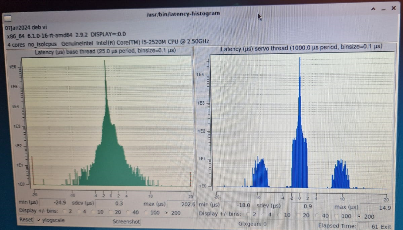

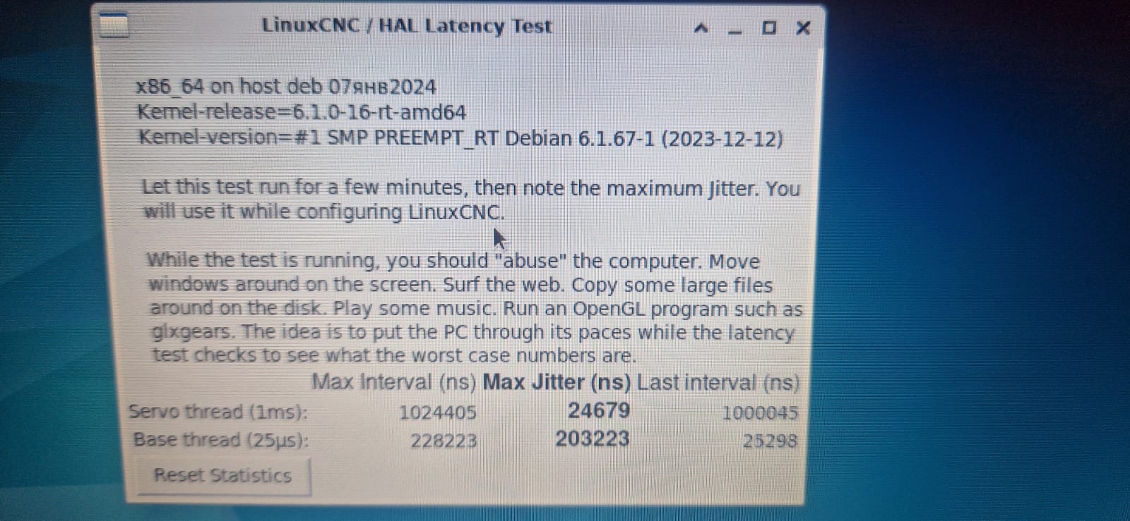

Good afternoon. Please help me. What should I set up to speed up?
Installed 2.9.2 with linuxcnc.org .
Jitter = 200000!!!
DELL E5420 Laptop
8 GB RAM (2 pcs of 4 Gb each), DDR3, 1333 MHz
SSD 120 Gb
Intel HD Graphics 3000
Intel Core i5 2520M 2.5GHz (3.2GHz, in Turbo mode) 2-core
Jitter = 200000!!!
DELL E5420 Laptop
SSD 120 Gb

07 Jan 2024 09:32 #290108
Replied by PCW on topic Jitter = 200000
If you are not using a parallel port, you should disable the base thread in the latency test:
latency-test 1ms
or
latency-histogram --nobase
latency-test 1ms
or

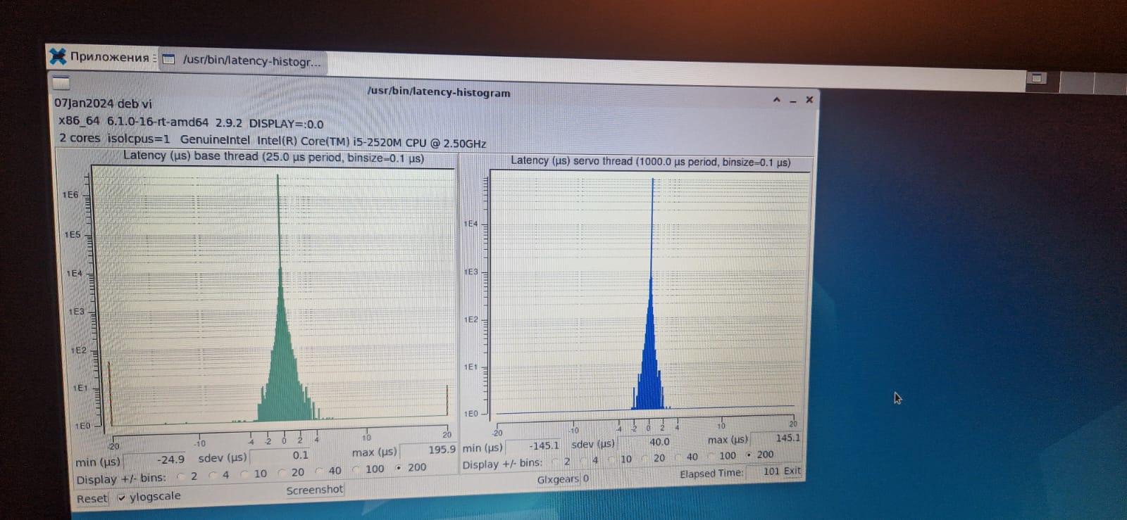

07 Jan 2024 11:22 #290117
by menedzher
Replied by menedzher on topic Jitter = 200000
Thank you, I will study how to do it.
It is planned to connect the controller via Ethernet.
I attached a histogram.

07 Jan 2024 14:11 - 07 Jan 2024 14:11 #290136
Replied by rodw on topic Jitter = 200000
Only the right hand side is relevant with a mesa card as PCW says open a terminal and tyoe
latency-histogram --nobase --sbins 1000
to remove the base thread side.
By and large, the latency looks OK, you can see the isolcpus made a difference.
