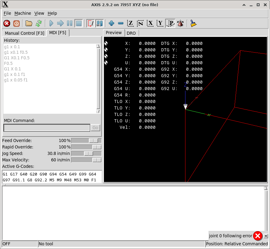

25 Feb 2024 10:16 - 25 Feb 2024 10:17 #294391
by slowpoke
Replied by slowpoke on topic LinuxCNC Errors - Help please
Rod,
I just watched the video in your link, I assume that's you in the video?
Very helpful particularly the short segment on networking, I'm strong with electronics, know next to nothing about networking and I will make time to learn more as this has been a perennial problem and I need to learn more.
Now that LinuxCNC runs and communicates with the Mesaboard verified by connecting an E-Stop button to an input and seeing it trigger in LinuxCNC when I operate the switch.
My next step might be a bit tricky, let me explain......
I'm using four ac servos to drive the various joints, X, Y, Z(quill), and U(knee)
For the moment I just want to get some motion on X.
The ac servo drivers I'm using (T6), have tuning software that I have used to configure the PID loop that is controlled internal to the T6 driver. The servo motor encoder feeds directly into the T6 driver. This seems to work very well and with the tuning software I'm able to move the X axis very quickly and accurately. The T6 drivers accept step and direction pulses (just like a stepper).
I also have Magnetic scales that presently only drive a separate DRO. Eventually I plan to split the magnetic scale signals and drive both the separate DRO as well as the Mesa board, so I can "close the loop" around the magnetic scales instead of the servo encoders so that any infinitesimally small errors in the ball screws etc. are corrected. So for the moment their is no encoder signal being fed back to LinuxCNC.
So until I make up the splitter I need treat the servos more like a stepper, send the pulses and hope for the best.
Today's problem
After resetting E-Stop, and enabling machine power on
Then manually homing (I think that's a requirement)
Then moving to the MDI tab, I send G1X 0.1 F1 and I get a following error.
I assume this is because LinuxCNC is expecting an encoder signal, but I'm not sure about that or how I can get LinuxCNC to treat the motor like an open loop stepper?
Your assistance is much appreciated.

25 Feb 2024 11:29 #294412
Replied by PCW on topic LinuxCNC Errors - Help please
Whether LinuxCNC uses encoder feedback or local
stepgen feedback is determined by your main hal file.
Can postt your main hal file and ini file here?

Replied by tommylight on topic LinuxCNC Errors - Help please
Download the latest MesaCT and try again, this version has an issue where it does not generate the stepgen stuff in the hal file.

25 Feb 2024 13:32 - 25 Feb 2024 13:33 #294436
Replied by rodw on topic LinuxCNC Errors - Help please
Your hal file looks like its missing a bit but i'll leave it to PCW as he has more experience
From what you are describing, you might like to look at Dual loop feedback where the motor encoder in velocity mode is attached to the motor drive
And the outer loop from your scales in position mode is closed by linuxcnc.
Ref: granitedevices.com/wiki/Dual-loop_feedback_position_control
